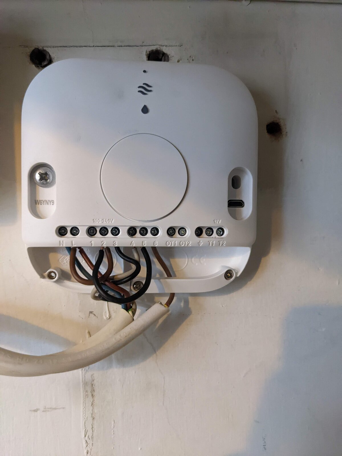

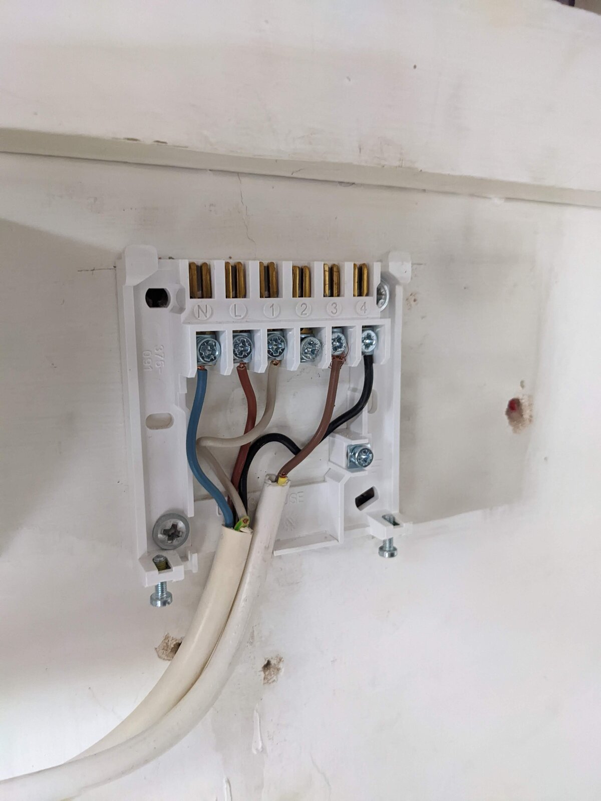

I know there are a few threads on this but I have followed the advice and have not been able to resolve my issue. I have been trying to install my 3rd Gen nest thermostat in place of my existing Drayton LP241 and Salus wireless thermostat system. Yesterday when I installed it, when using over ride mode (pressing the hub in the cupboard) the heating would come one but the thermostat wouldn't call for the heating. Now I have no heating at all and nothing will start the boiler / heating.
Here is my Drayton wiring:
Following the advice on this forum here is the wiring I have done:
For clarity I moved the wires as follows:
(N) > (N)
(L) > (L)
(1) > (4)
(4) > (3)
(3) > (6)
I then added links between L - 2 - 5

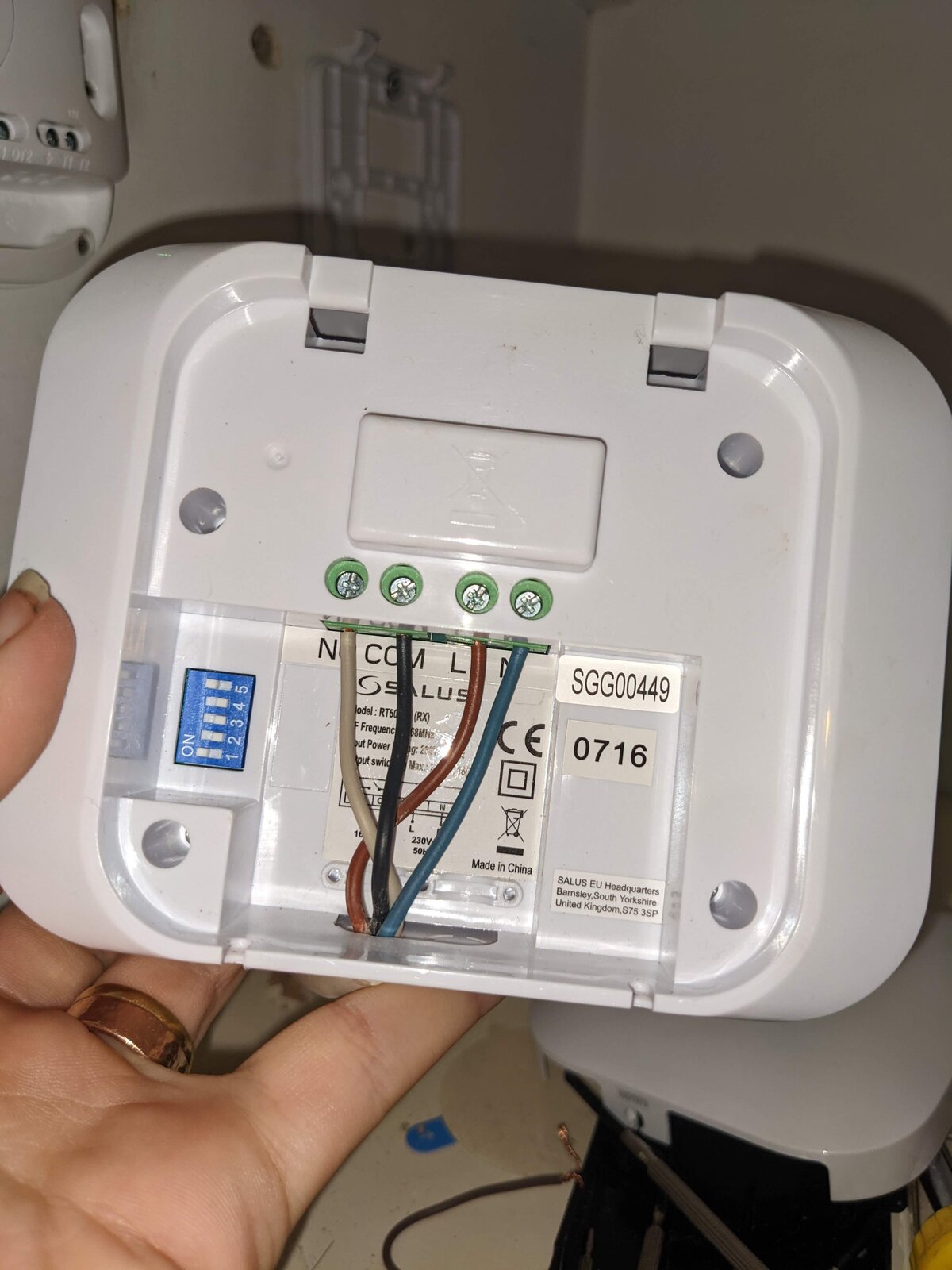

I then understand I need to decommission my Salus thermostat but I don't quite understand what wires I need to remove. It is wired as follows:
And as follows in the terminal box:
Blue 2
Green / yellow 3
Grey 7
Browney red 1
Black 4
