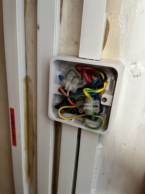

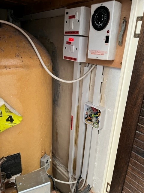

just been assessing my ageing heating and the work needed to install a more modern thermostat and heat link.
I am having trouble finding the wiring centre, see below for the setup in the airing cupboard and a pic of what it think is the wiring box -
how do i go about confirming this? Also, how on earth do i make sense of that rat's nest of wires?

It's a home made wiring centre, and to make sense of it a suitably skilled person would have to identify what each of the wires actually does.

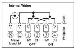

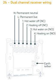

However, all is not lost. If you want to upgrade, the easiest path would be to get a smart stat that replaces the Honeywell LP722. Hive Dual Channel for example would be fine, Hive Dual Channel and LP722 have exactly the same connections so are a straight swap. No need to touch the wiring at the 'rats nest'. [Nest would be slightly more difficult. Its Heat link would still replace the LP722, but the connections are in a different format]
LP722
A small wiring mod would also be required to take the old analogue room thermostat out of service. Basically, its two live switching wires would need connecting together.
However, all is not lost. If you want to upgrade, the easiest path would be to get a smart stat that replaces the Honeywell LP722. Hive Dual Channel for example would be fine, Hive Dual Channel and LP722 have exactly the same connections so are a straight swap. No need to touch the wiring at the 'rats nest'. [Nest would be slightly more difficult. It's Heat link would still replaces the LP722, but the connections are in a different format]
LP722

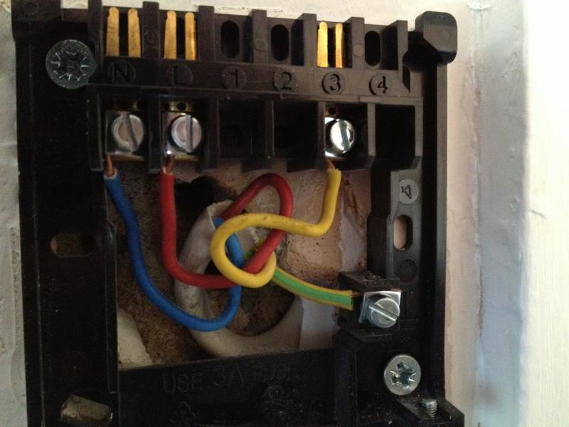

with regards the Nest and wiring out the old stat, what if i want the new Nest stat to replace it, in the same location, can i just use the existing wires?
its the same as this, without the earth
Yes you can, but in that case, you would need to trace the cable back to the rats nest (or wherever it goes) and disconnect it completely from the 230V mains wiring. Once it is disconnected completely, it can be used to connect the Heat link T1 & T2 to the Thermostat T1 & T2. This is only a 12v connection, so the cable must not be connected to any mains wiring.
When the cable was disconnected at its origin the terminals that the yellow and red wires have been removed from need to be linked together to complete the circuit.
If you don't feel competent to do that the old thermostat can be removed, the wires put in to a junction box and the yellow and red wires joined together, and the blue wire isolated.
You would need to run another wire from the Heat link to the Nest thermostat for T1 & T2, or use a plug in power supply for it.

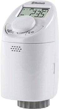

a central hub where you can control each room would be the bee's knees, but Honeywell EvoHome is not cheap, so in non main rooms,
Using stand alone programmable heads is likely good enough, the one shown is bluetooth so if two used in same room they can be linked. Also it can connect to one phone so can control from phone when close enough, there is also the Terrier i30
which does not have bluetooth option, showing picture as it shows what adaptors come with both makes, I paid £15 each for bluetooth eQ-3 in 2019 before brexit, prices now seem to have gone up.

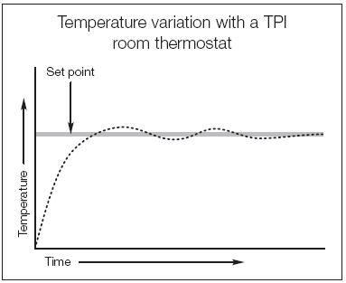

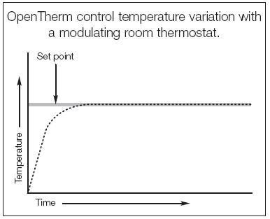

Yes without linked TRV heads setting up the wall thermostat and the TRV can be a bit fiddly. This house my problem is hall cools too slow, mothers house it worked A1, the wall thermostat was set about 1.5°C higher than the TRV, heat raises and the wall thermostat is higher than the TRV, and on warm days the wall thermostat would switch off, on cold days the boiler would modulate (turn down) so there was hardly any hysteresis in the temperature.
this picture shows what hysteresis is, and any on/off thermostat must cause some hysteresis, but with a gradually opening or closing of a TRV or with thermostats connected to the ebus (Most common is OpenTherm) we get this
at least that's the theory, my boiler does not modulate, it cycles instead, that's common with oil boilers, however it still works with TRV control, the wall mounted thermostat is basic there so I can turn boiler on/off without going outside and walking down the steps to under main house where the boiler is, and it also connects to mobile phone, so when away from house heating auto turns off, but most the features have been turned off, and my boiler does not support OpenTherm, very few oil boilers can modulate, only gas tends to do that.
