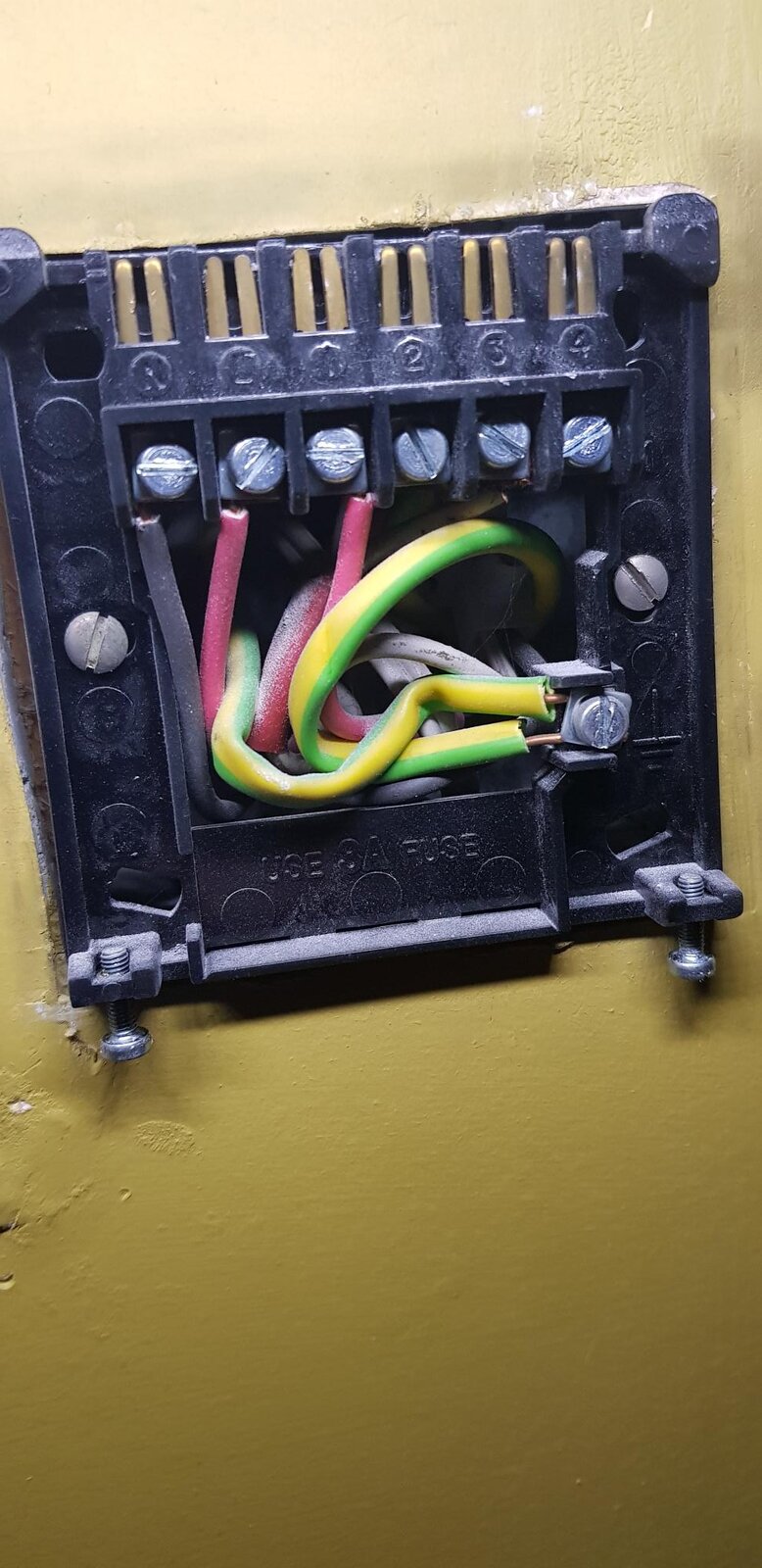

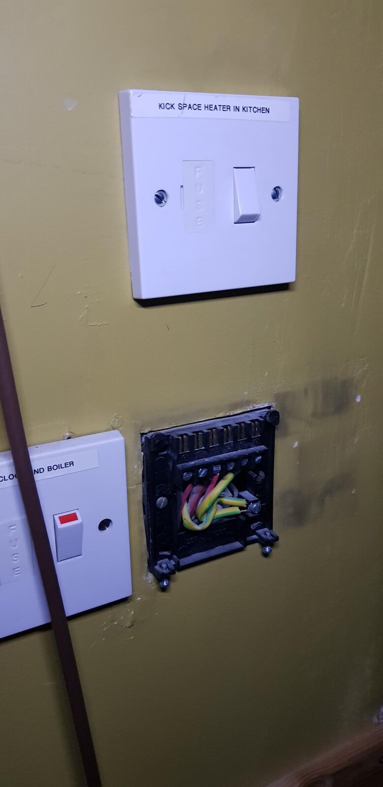

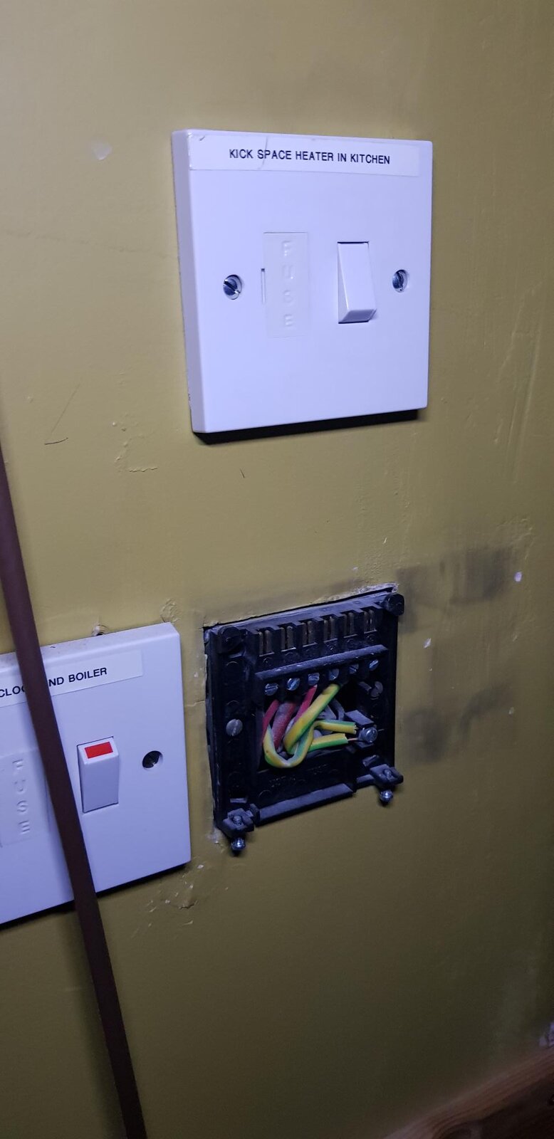

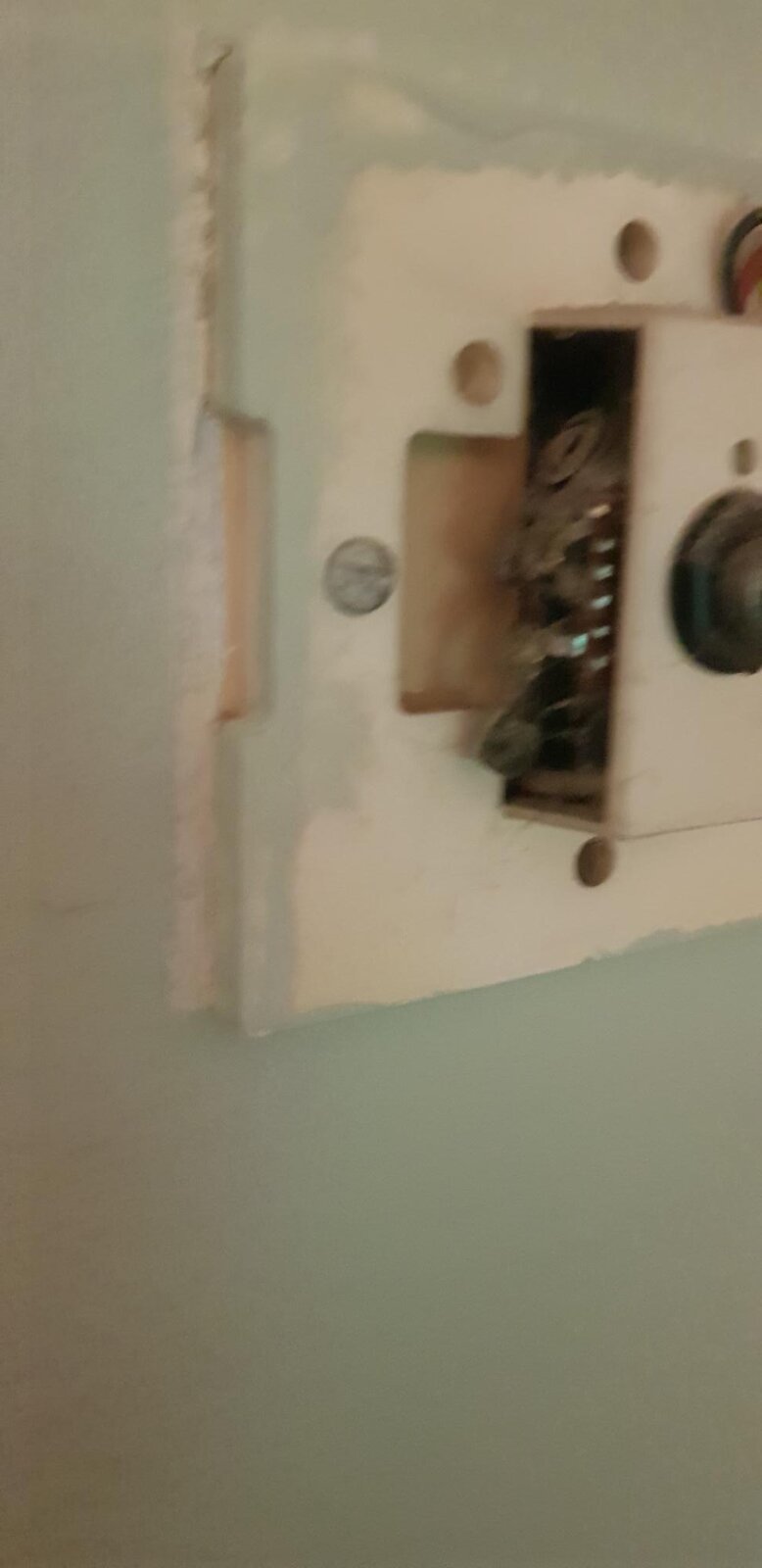

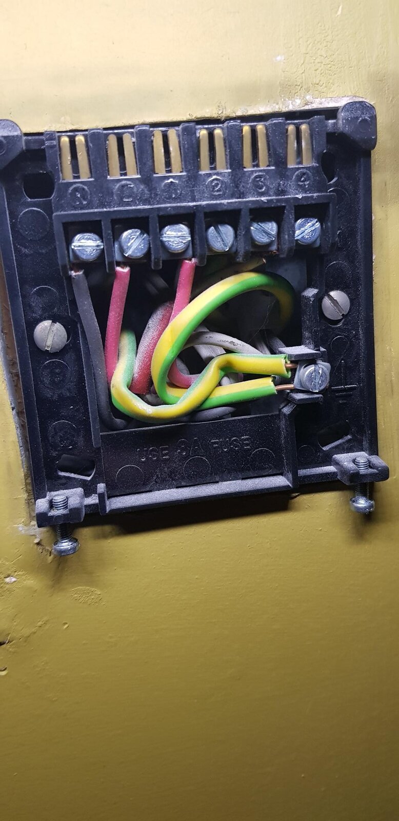

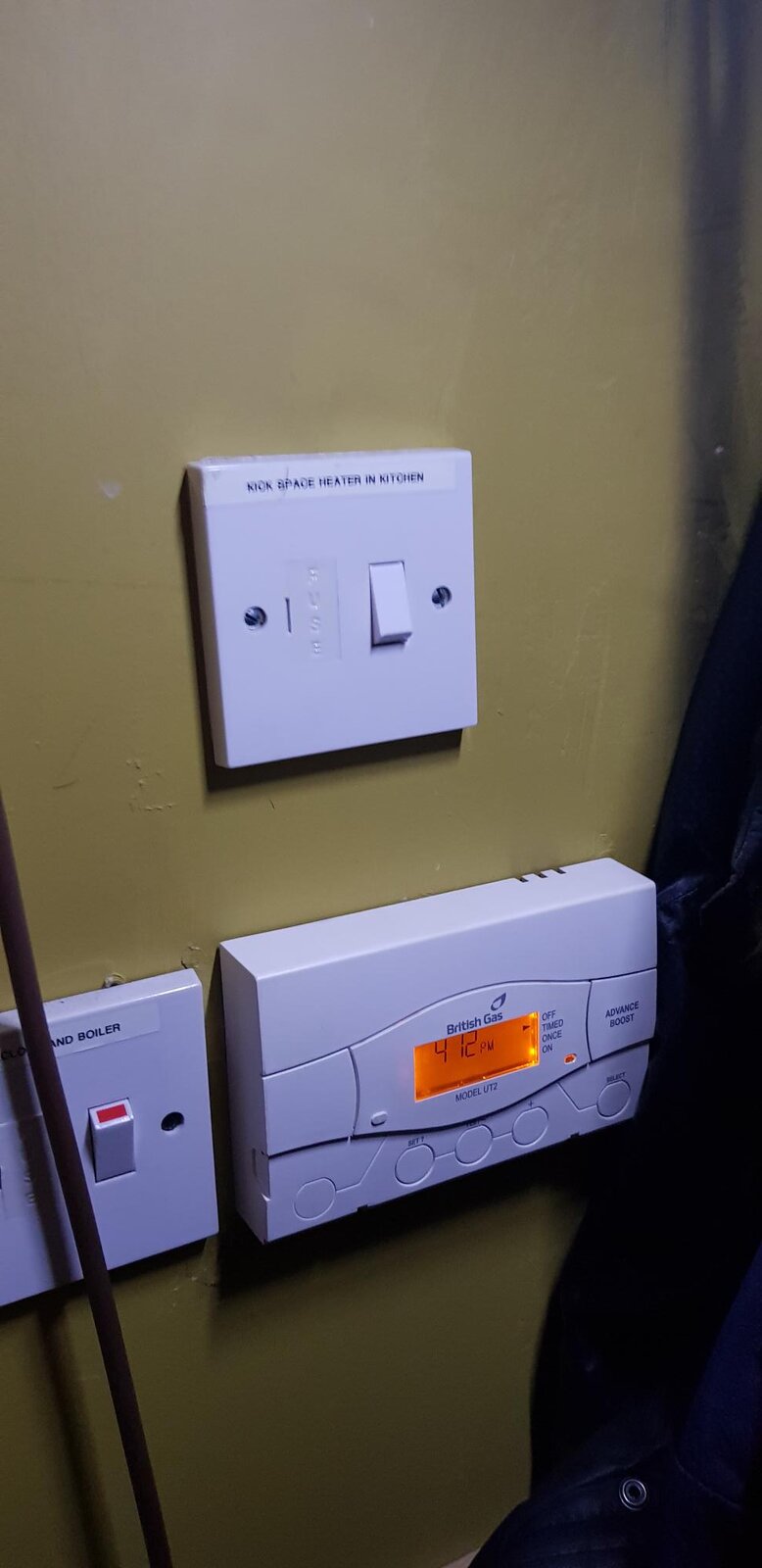

I am looking to install a Nest Thermostat in the house and need a bit of guidance.

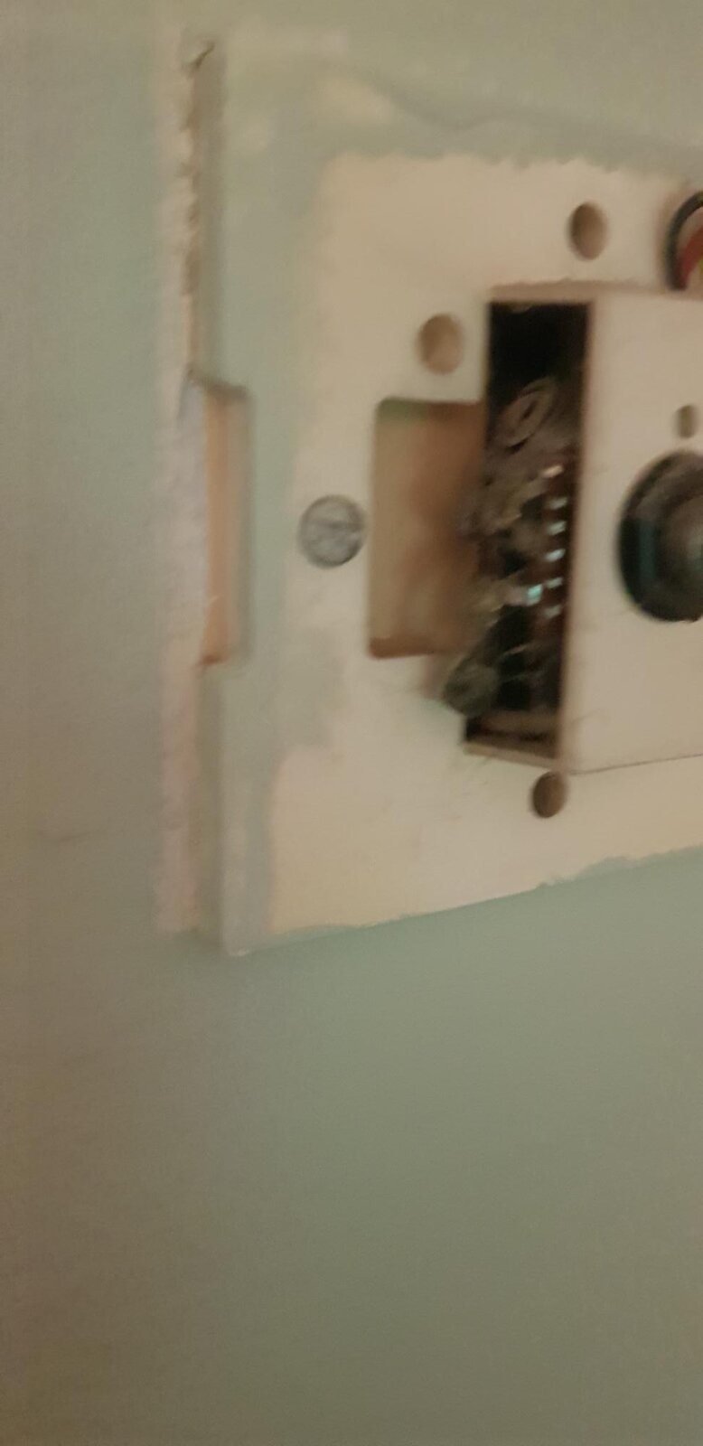

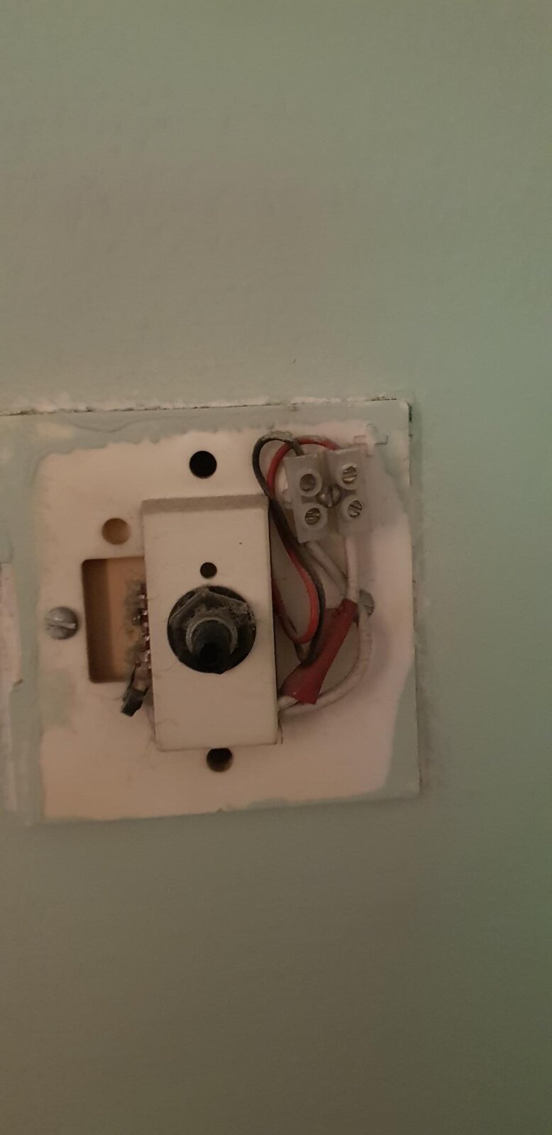

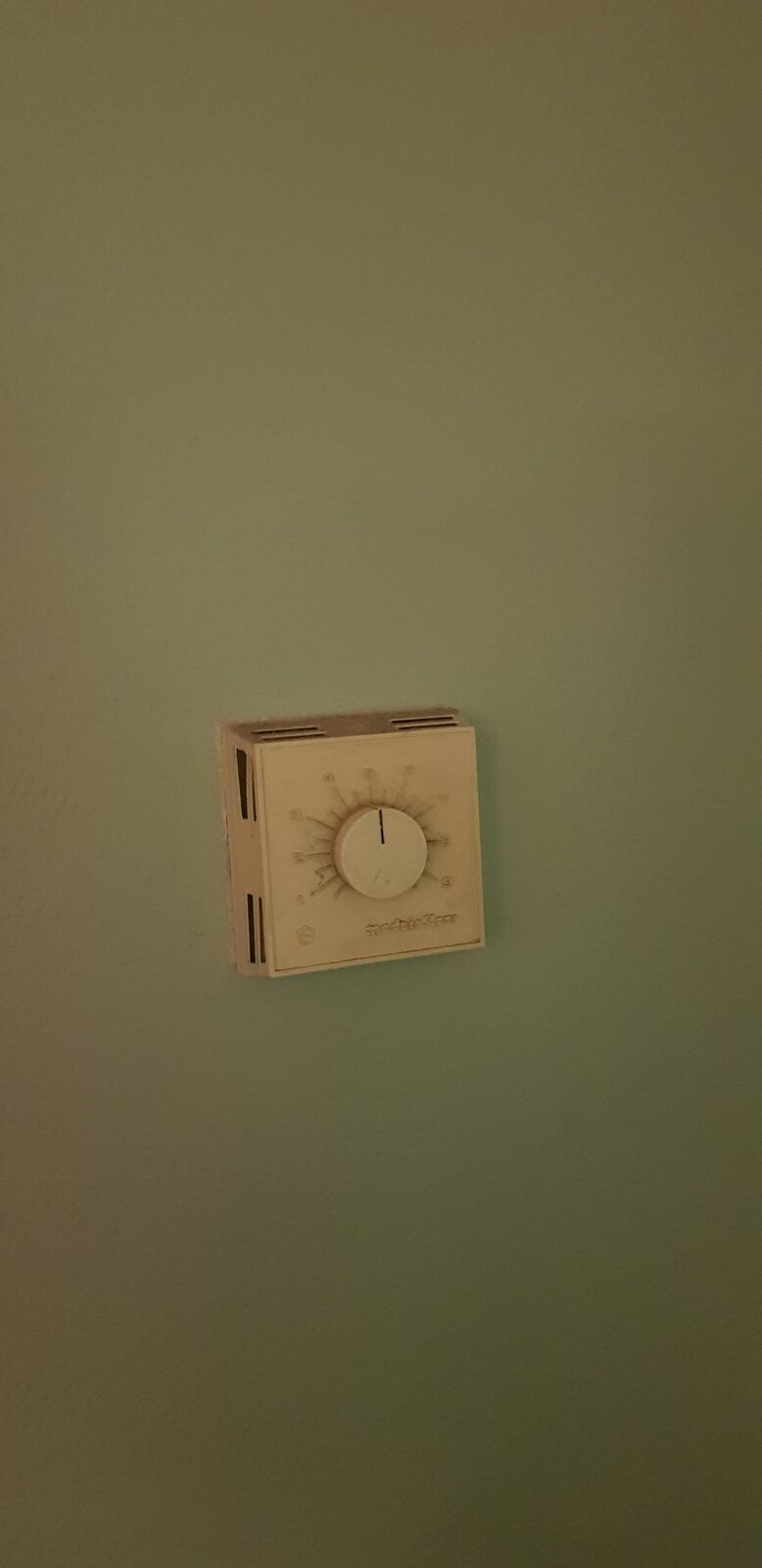

I have a logic 30 combi boiler in the loft a controller in the cupboard downstairs and what i think was a room thermostat for a previous under floor heating installation in the living room.
Can i just connect the Nest heatlink to the existing room thermostat wiring or do i need to remove the controller completely and replace with the heatlink ?
If i can utilize the existing thermostat wiring how do i wire it into the controller ?

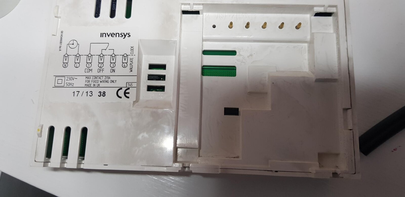

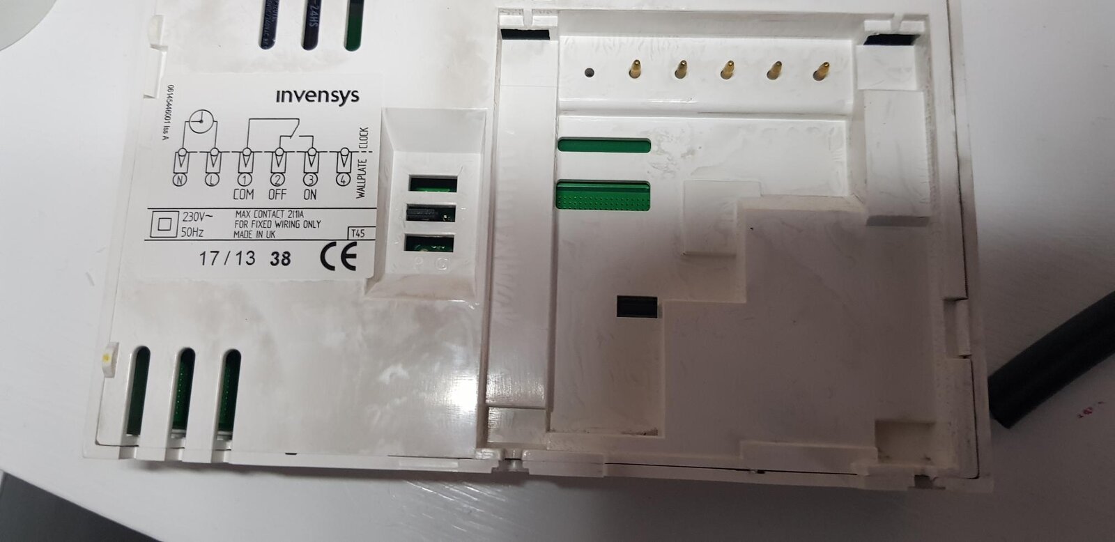

The Next replaces the Invensys controller. Wires in 1 and 3 connect to the two Nest terminals. Other wires must be insulated and not connected to anything.

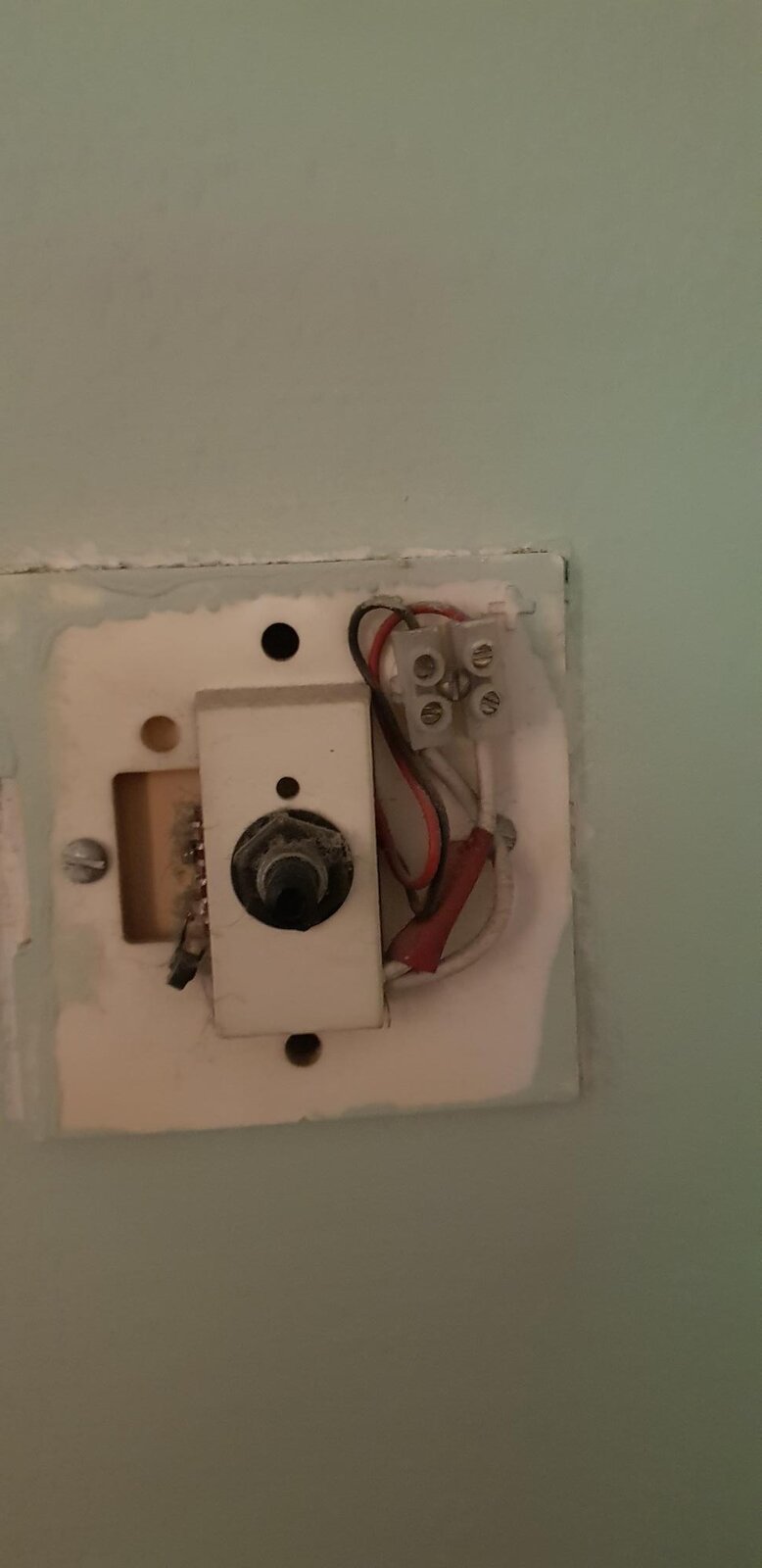

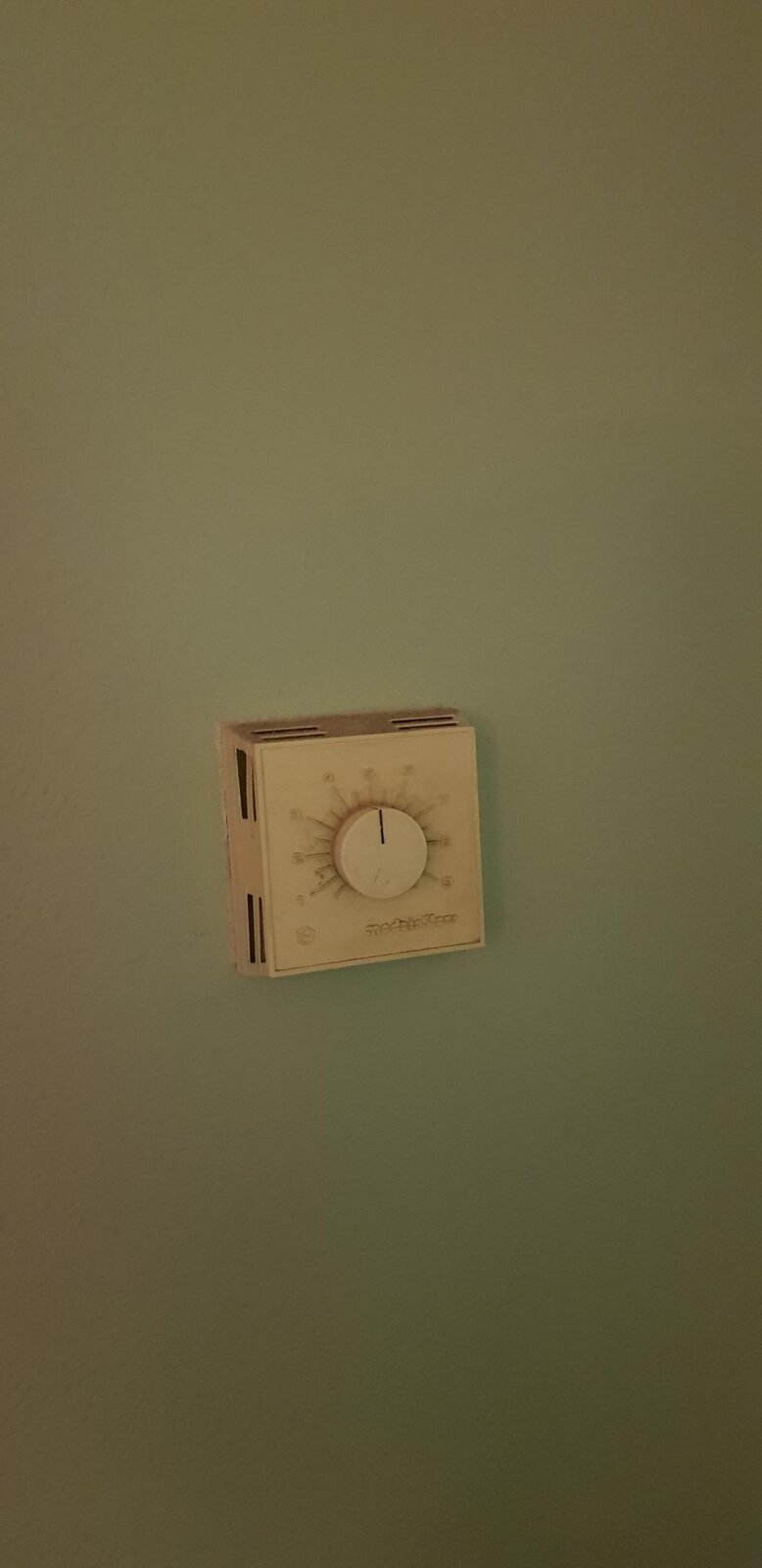

If that ancient thermostat is still in use it must either be set to maximum or bypassed.

Many thanks for the response. So literally take just the wires 1 and 3 from the controller back plate and connect those to the heatlink and blank off everything else and job is done ? I assume blank of the fused timer/boiler switch to the left of the controller too ?
Any idea what the wireless performance of the heatlink is like ...... just concious its in a cupboard .... mind you it will be within 10ft of the thermostat.
The antiquated room stat is redundant as far as i am aware. When the mrs decides on the wallpaper we will get rid of it altogether.
Yes.
It's just replacing one device with another.
The 'e' version is designed to be as simple as possible, which is why it only has 2 wires.
It's just an on/off switch, which connects the two wires together when heat is required.
Far more than any normal installation would need.

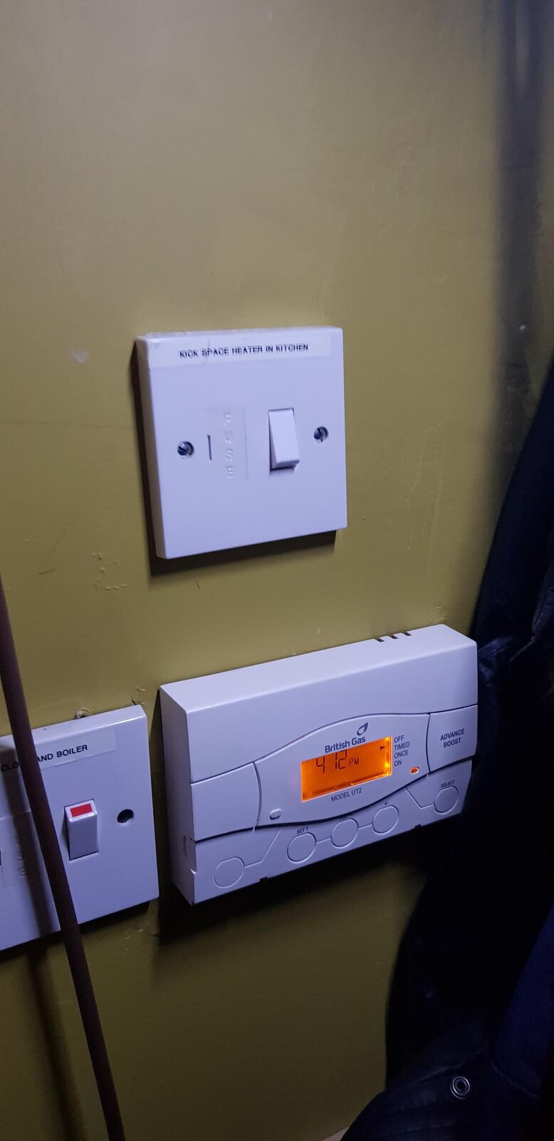

No - as that supplies power to the boiler and controls, and is necessary to isolate those when the boiler is serviced/repaired.
Doh .... I didnt quite think that through .... :)
So what is connected presently is power boiler and power to the controller from the fused switch and 1 and 3 to the boiler in the loft ?
Yes.

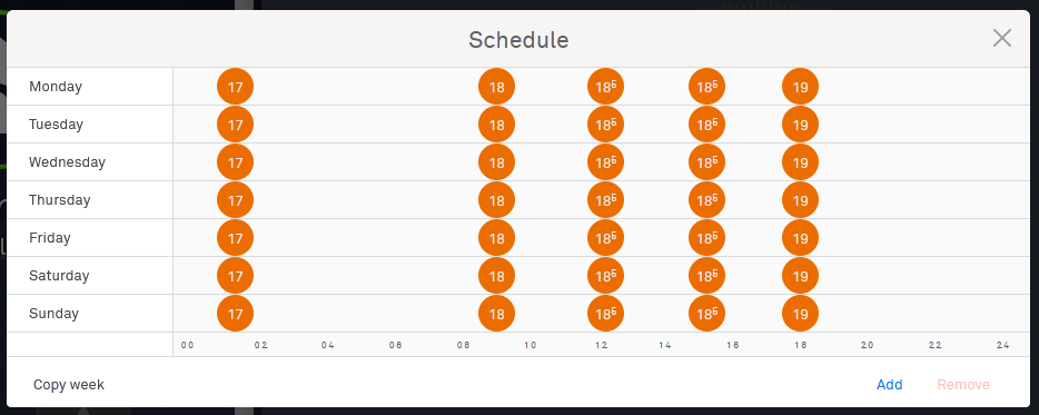

So my TRV has a program set
And the wall thermostat has same program set, but with slightly higher temperature as higher up the wall than the TRV so the boiler will turn off at 22 hours until house cooled, and also turn off if we leave the house with our mobile phone (geofencing) but with a modulating boiler the TRV is king. Not the wall thermostat.

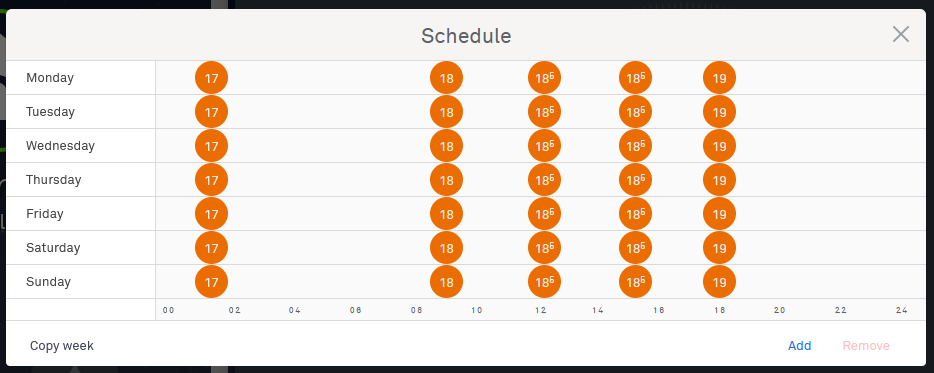

So my existing setup Combi + Programmer + Nest Thermostat will not operate how I am wanting it to through the NEST schedule feature i.e. it switches on at pre-defined times and durations like it was setup on the original programmer ?
You also mention TRV's which I have too albeit just std mechanical ones.
It seems to me you are supposed to just have your heating all day and the Nest just adjusts the temperature throughout the day. I noted there is a feature with it where it supposedly switches off when you leave your home .... at least i think it does .... but that seems to be phone app orientated so i would effectively have to get every family member to install the Nest app ?
Regards the frost stat that has always been in the back of my mind. It is installed in the loft which can get pretty cold in the depths of winter and I have always wondered if it had frost protection. Is there a way to check/ confirm without getting into the boiler unit ?
Should be just Combi + Nest as Nest does the programming.
Or set programmer to be on 24/7.

Soz forgot to say, yes i had the existing programmer set to 24/7 but just feel we are burning a lot of gas ..... it isnt a massive property and we are in and out throughout the day so having it running all the time just seems inefficient.
Regards the Nest schedule I am correct in saying it will only switch off IF it detects you are out of the property ?
It would be good if they gave you the option to set the heating to come on and off when you wanted and define the duration. I mistakenly thought that would be the case ?
