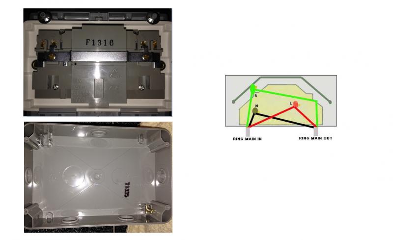

Have brought a masterseal plus double socket with rcd. Where I want to put it outside, there is a socket inside. What I want to know is how do you connect the existing interior socket to the outside one? Do I cut the cables that go to the inside socket and run two cables off that, one for the interior, one for the exterior? Or can I just add cables from the back of the interior socket and take them to the outside? Any diagrams drawn on paint or whatever would be go. Ive attached a diagram, can someone complete it please. Thanks

if you're sure it's a ring, then you can just spur out of the existing socket - this means you'll have 3 sets of cables in each connection point
The circuit needs to have RCD protection at the consumer unit though. If you're unsure, post a pic of it please

We need to know about the socket that you are hoping to connect to.
How many cables are connected to this? I mean, how many wires are in each terminal?
If its two wires in each, then drill through the wall and fit a length of 2.5mm² twin and earth. Connect up at teh external socket having first drilled out the drain hole in the MAsterseal box, and siliconed teh cable entry/exit.
At the existing socket, connect up earth, neutral and line to the existing wiring (now you have 3 conductors in each hole).
Job done.
Come back if you have a different number of conductors than 2.
ok so from each live, neutral and earth connection in the back of the inside socket, I come off that and connect to the corresponding one in the back of the outside socket? What about the earth in the casing? The sockets are on a separate ring that has a rcd at the consumer unit. I know its expensive but I wanted to be sure lol. Thanks

With a length of cable. Make sure the hole through the wall slopes downwards as it goes out. Are you planning to go into the back of the Masterseal, or the bottom?
I don't understand - why would you cut them? And having cut them, what does "run two cables off that mean?
Do you actually understand how socket circuits are wired?
I think the OP was trying to ask if he puts the outside socket in the ring, extending the ring by cutting cables and adding extensions.
There is no need to have a go at him, just explain how its not a good thing to have an RCD on an already RCD protected circuit if that's the case, how to wire it has already been explained.
He is likely thinking that an RCD protected external socket would work independently of the internal one. so any faults outside stay outside and that he needs to extend the ring to the socket rather than spur to it.
