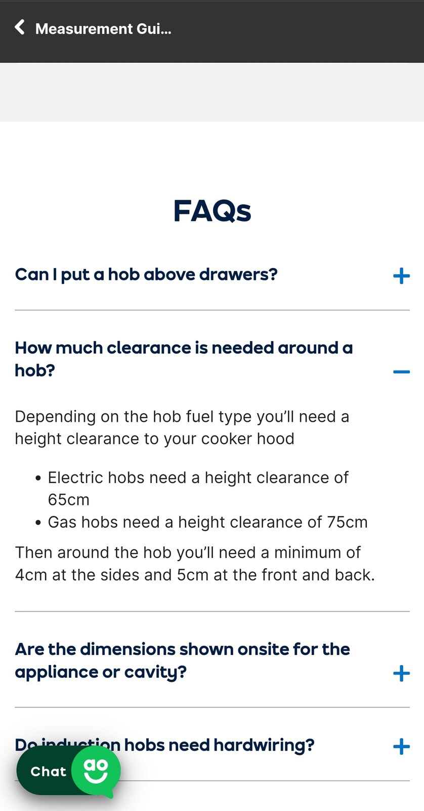

I have a Hoover Ceramic hob waiting to be installed but can't until I've cut out the area in the worktop for it. I've just recently installed new worktops and the area we had our old oven, is now occupied by a new 600mm cabinet, as we needed the space and don't use the oven anyway. I was hoping to install the hob above this new cabinet but it sits right next to a larder. The installation manual states that 150mm is required on the sides from any walls/cabinets. The issue with adhering to this is that it will cut into, above our cutlery drawer and will be partly under a wall cabinet. AO.com states that only 40mm is required on the sides but I'm unsure whether this will be suitable or not. We've had the larder for 6 years and have had 2 different electric cookers sit right next to it and have had no issues with either heat damage or room for pans etc. Would I be able to get away with 40mm or not as will have to do some changing around if the 150mm has to be adhered to. Many thanks for any advice
Manufacturing rules are the ones you need to follow.
Are you 100% sure of this as I've read on AO.com that only 4cm is required on the sides

Who is most likely to know what clearance is needed for a particular appliance?
a) The manufacturer of the appliance
b) A company that sells lots of different appliances.
So the manufacturer says 150 then, hard to argue with that but sometimes common sense must prevail. Might be better asking in the Electrical section.

You could contact the manufacturer technical department to ask if they can explain/justify why there needs to be a 150mm clearance when the salespeople state you only need 40mm.
They may say it's simply for maintenance clearance of they may have a genuine reason such as heat transmission to possible combustible surfaces.

Well I contacted the manufacturers technical department and they have replied stating the instruction manual has the correct information. I suggested the 40mm that I found and waiting a response. If the 150mm has to be adhered to, I will have to make a number of changes to account for it. The main one I see is that I will need to cut about 3 inches over the cutlery drawer. I will be buying 2 new cabinets to account for this but until I can scrape the money together to get them, will I face any issues with it being like this ie heat issues with cutlery?
