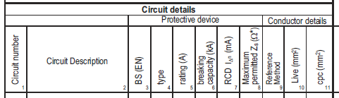

Without the installation method, there is no way to determine if the cable will be subject to overload.
6mm² can be rated up to 47A if surface clipped or in masonry. Substantially less if installed through insulation or other arduous environments.
Some EICR documents are better than others.
As for how - reference to the original installation certificate and other previous documentation if available.
In the absence of that it's either a case of looking, or it's a limitation, which may lead to other problems.
The cable runs through the kitchen ceiling, and is pinned to breeze blocks, with dot and dab boarding over the top.
So it seems but, as you will realise, what I was illustrating was the BS7671-recommended one.
I think we are again back to "some documents being better than others" since, again, the BS7671-recommended ones do not seem to have any explicit place to record installation methods - so that information would not be recorded in such documents until the inspector found a way to 'volunteer' the information.
Indeed, and ('problems' or not) is that not nearly always going to be the case? Since an inspector is unlikley to lift floorboards, and certainly won't deconstruct walls, other than for circuits which are visible in their entirety) in a roofspace (which must be very rare), an inspector will very rarely be able to tell, with any certainty, what method has been used for installation of the entirety of the cable of a circuit, won't they?
