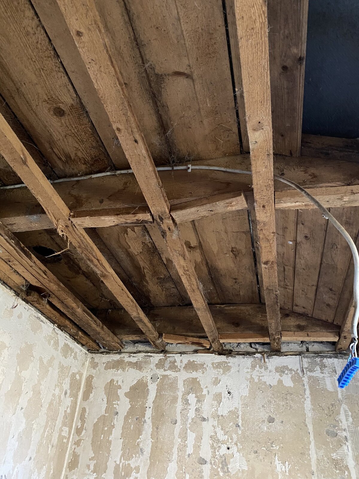

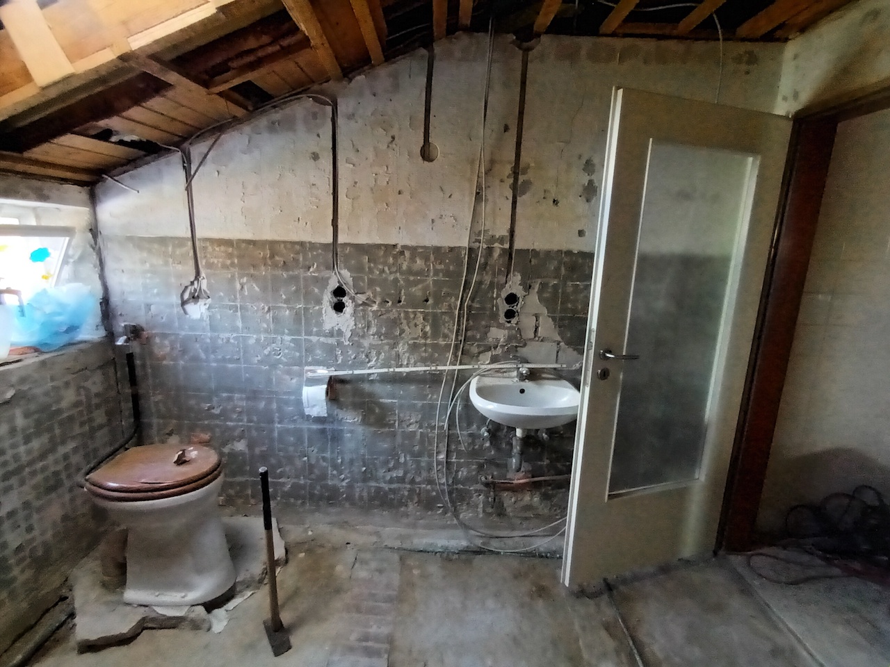

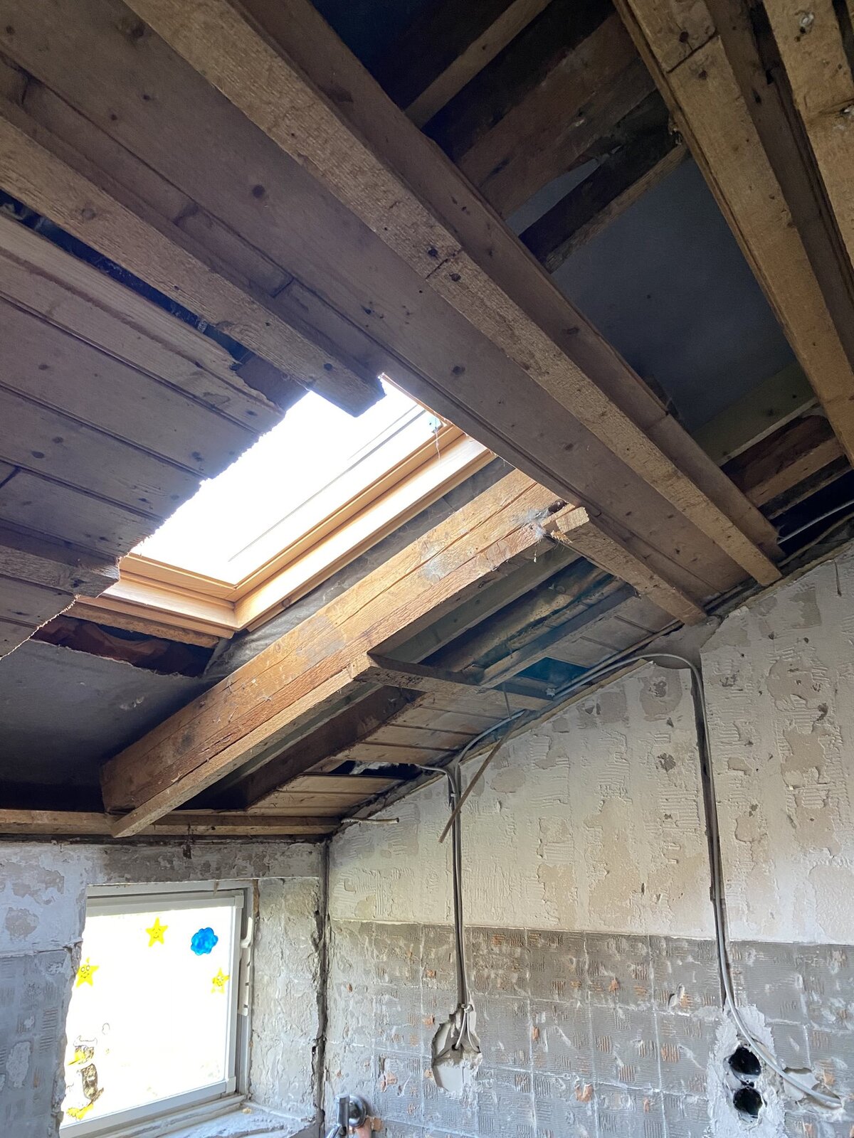

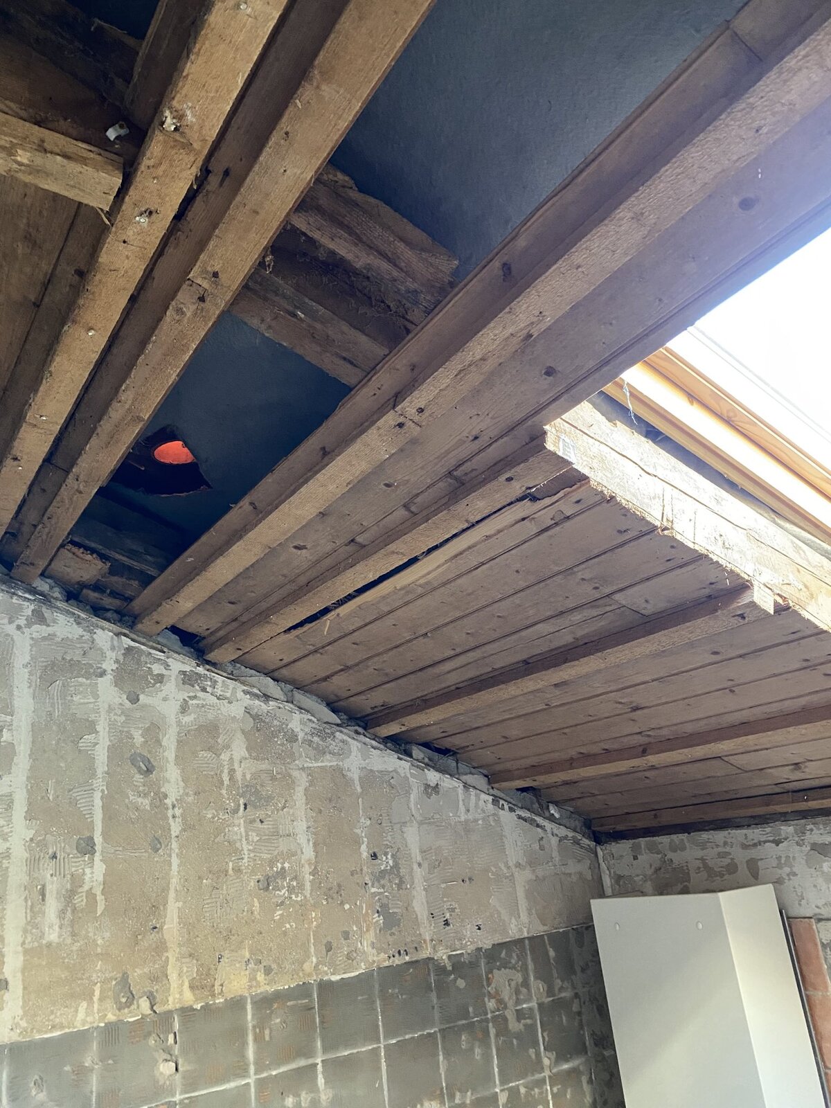

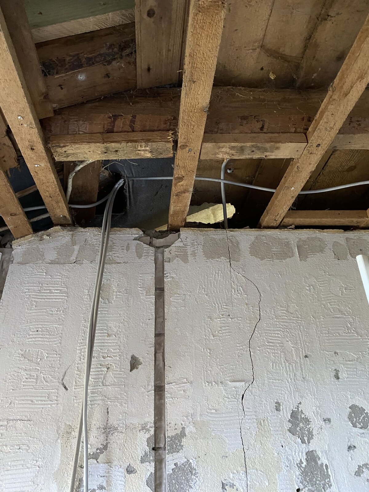

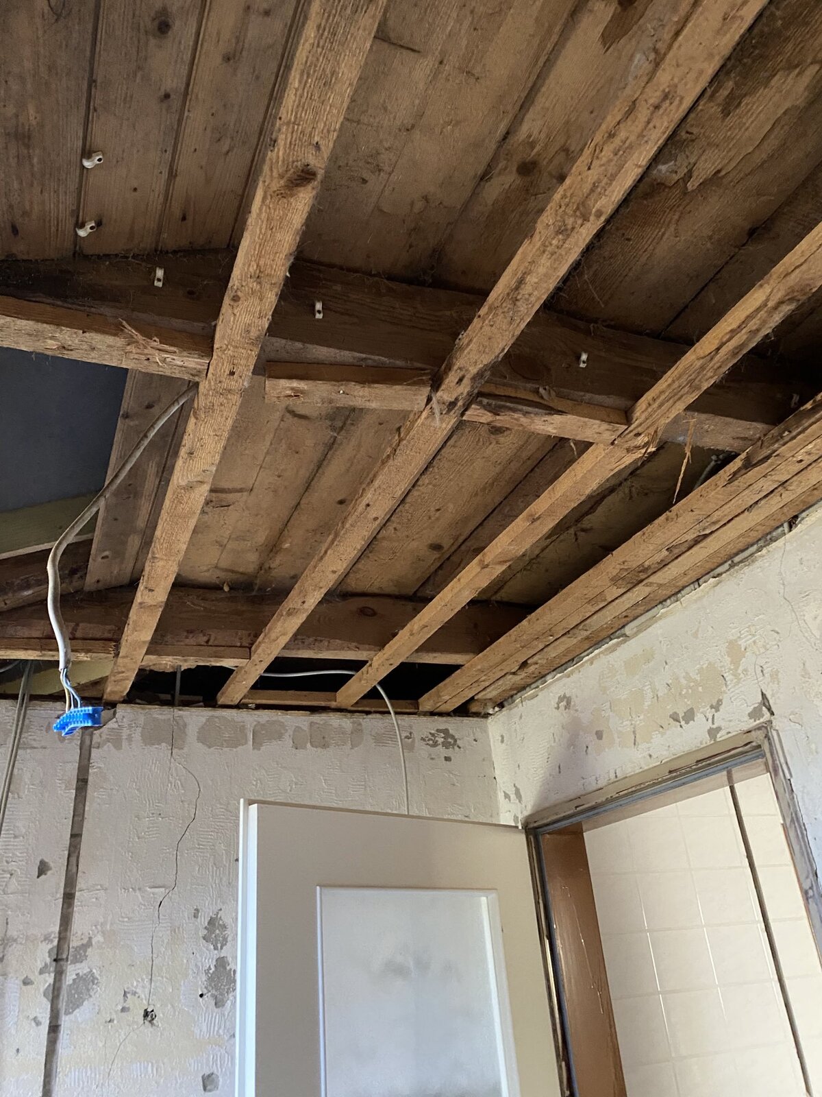

We are renovating our bathroom and need to insulate the ceiling. As you can see from the pictures the bathroom is in the sloped part of the ceiling.
20230311_141436.jpgsignal-2023-03-13-162359-1.jpegsignal-2023-03-13-162359-2.jpegsignal-2023-03-13-162359-3.jpegsignal-2023-03-13-162359-4.jpegsignal-2023-03-13-162359.jpeg
We have gutted the bathroom and removed the ceiling. There is/was glass mineral wool insulation with foil.
Can we replace this with the same (glass wool), or should we place PIR between the rafters?
