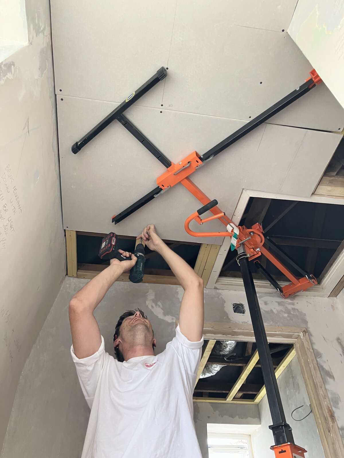

I wouldn’t have the £££ to dig up the floor and the neighbours have put up with a lot of noise already, also the floor is too good to dig up I’m trying to do project with as little new material as possible , to present to Council the waste of housing stock by not upgrading their older property. i.e if a 71 year old can do it with only help from son to batten out and replace rotten upstairs ceiling plasterboard why is a housing association doing nothing. I think I will take the advice about going a bit higher with PIR slabs and glued OSB T and G , I’m just needing to move in hence getting work from artisan . There is much conflicting information so this is all very helpful I hope other people with doer uppers on a shoestring will read and be saved much internet footslog so thanks very grateful for all the input and back to drawing board!

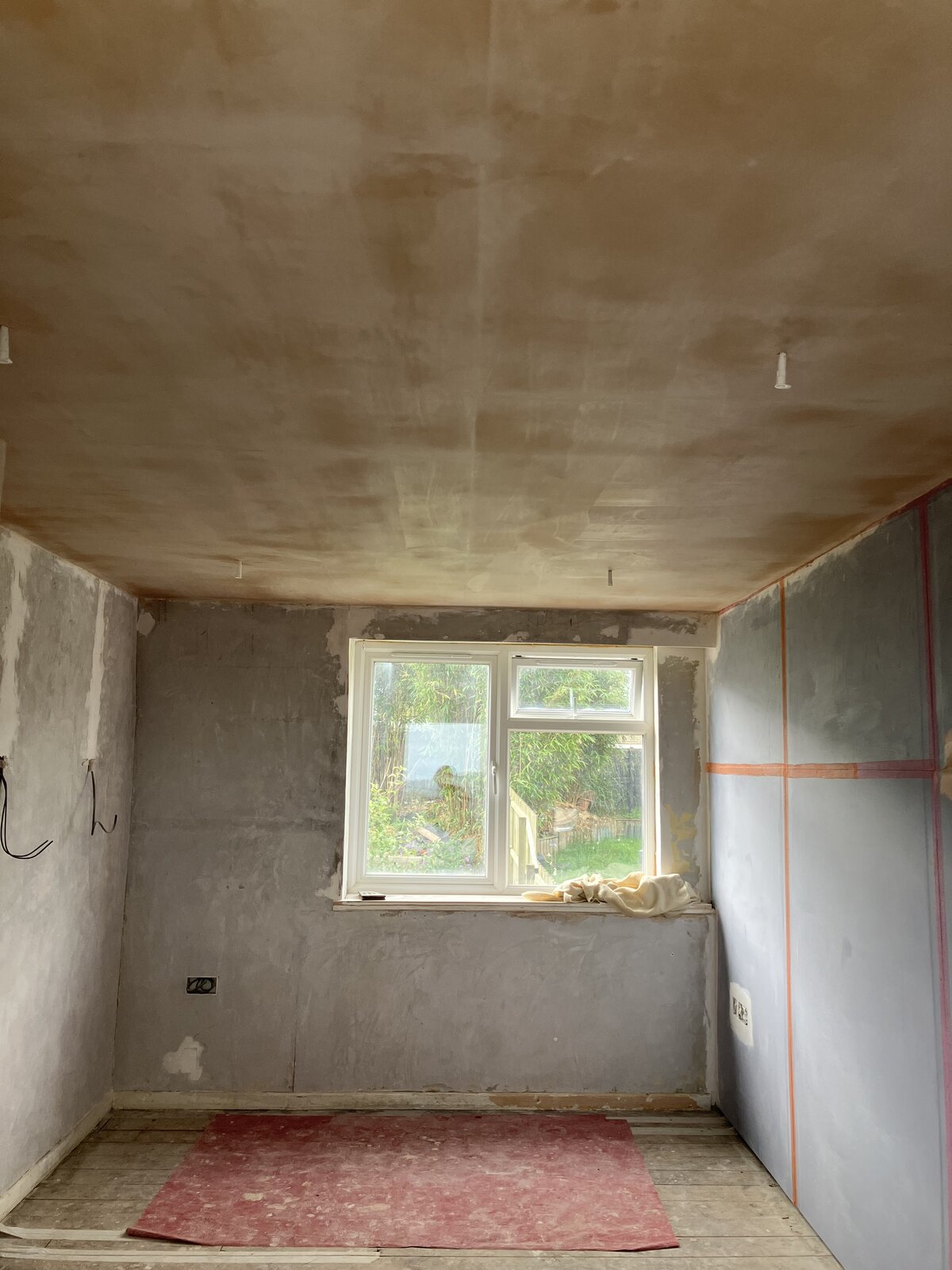

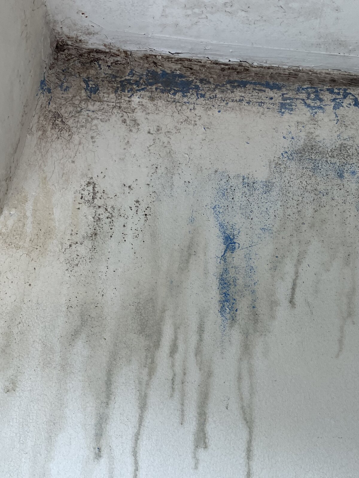

Had an excellent roofer who repaired the timber framework around new windows in hip roof then I could repair the interior reveals . Whole place was black with mould but after stripping out and airing is snuff dry ,the windows were never opened . I understand about floor heat loss not being the most but I am a textile worker and work on the floor a lot . The workroom is downstairs ,with the concrete floor.Sitting room upstairs for warmth in evening .

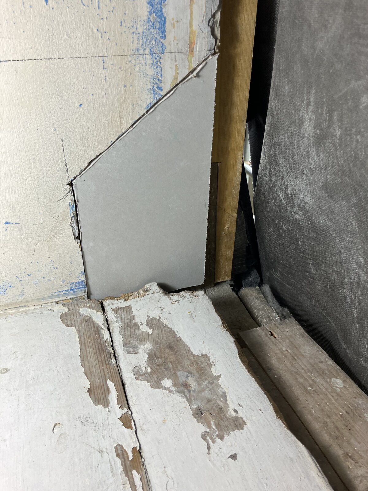

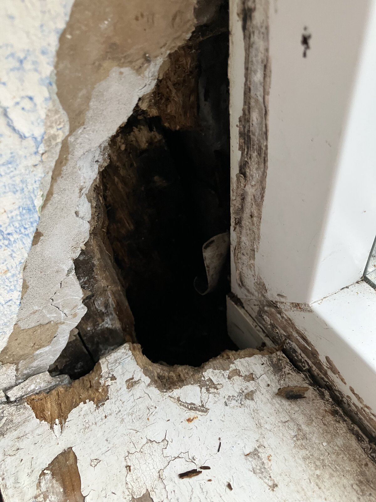

You need to step back for a minute and have a good look at the entire property.
I don't really understand what "remediation" is, but if it (including "wall insulation") was carried out in 2003 and the place subsequently became riddled with mould I would question what work was done and to what standard - certainly looking at that dormer cheek/exposed cavity or whatever it is - there appears to be little evidence of insulation. Many insulation "upgrades" carried out in that period have been found to be flawed and causing serious damp problems.
If it's a rented council property it doesn't really appear fit for habitation but it's their responsibility so I'm a bit confused as to why you are carrying out these works?
