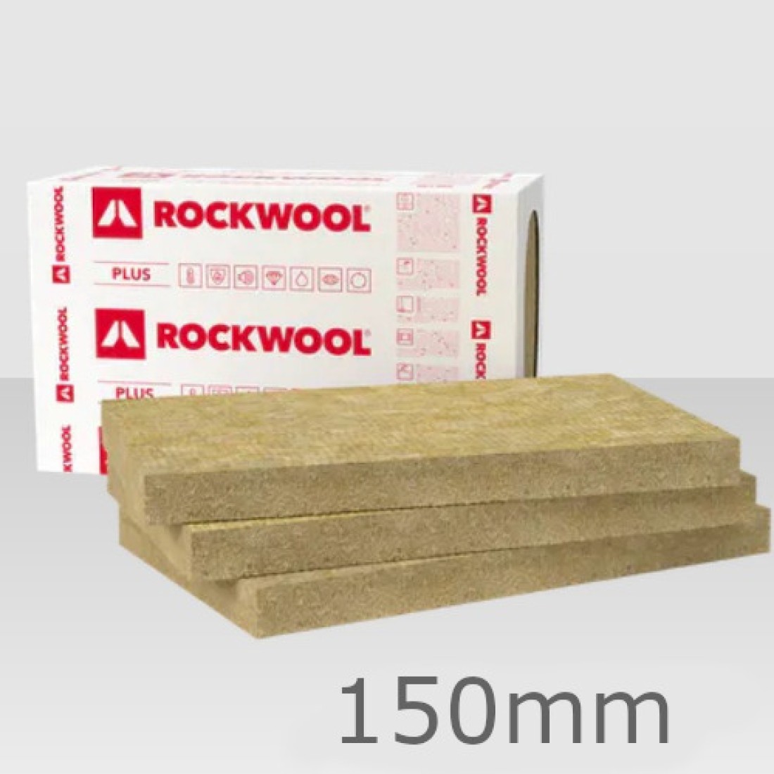

Standard loft roll or rigid boards will be easiest and has fire proof properties. You can use roof battens to make a sort of "hey bale" basket to hold the roll in place or simply use some roof membrane.
held in place using wall board washers.
