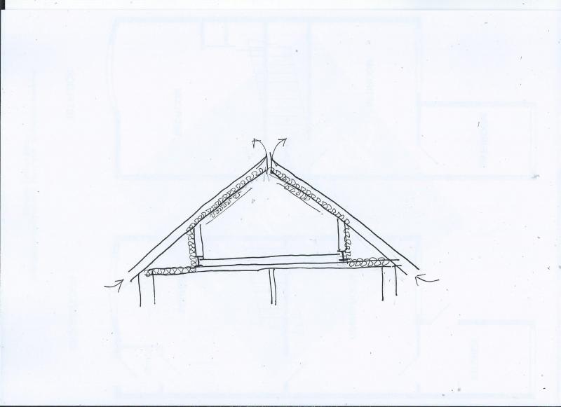

If it helps i have exactly the same, except I am about to rip out the current loft job and do it properly. The architect drawings specify celotex or similar between the roof rafters ie enclosing the roof and structure in insulation and soundproofing between the loft floor joists.
In principle, this is what you need to be doing (also including a vapour barrier on the warm side of the insulation in the loft).

I was wondering which of the above images would be the best solution so I am presuming that the middle image is the one to aim for.

Use rafter trays to prevent insulation obstructing air flow at eaves. Principle generally as Tony1851 shows but I would also include 100mm Rockwool insulation for acoustic insulation between joists of loft floor.
