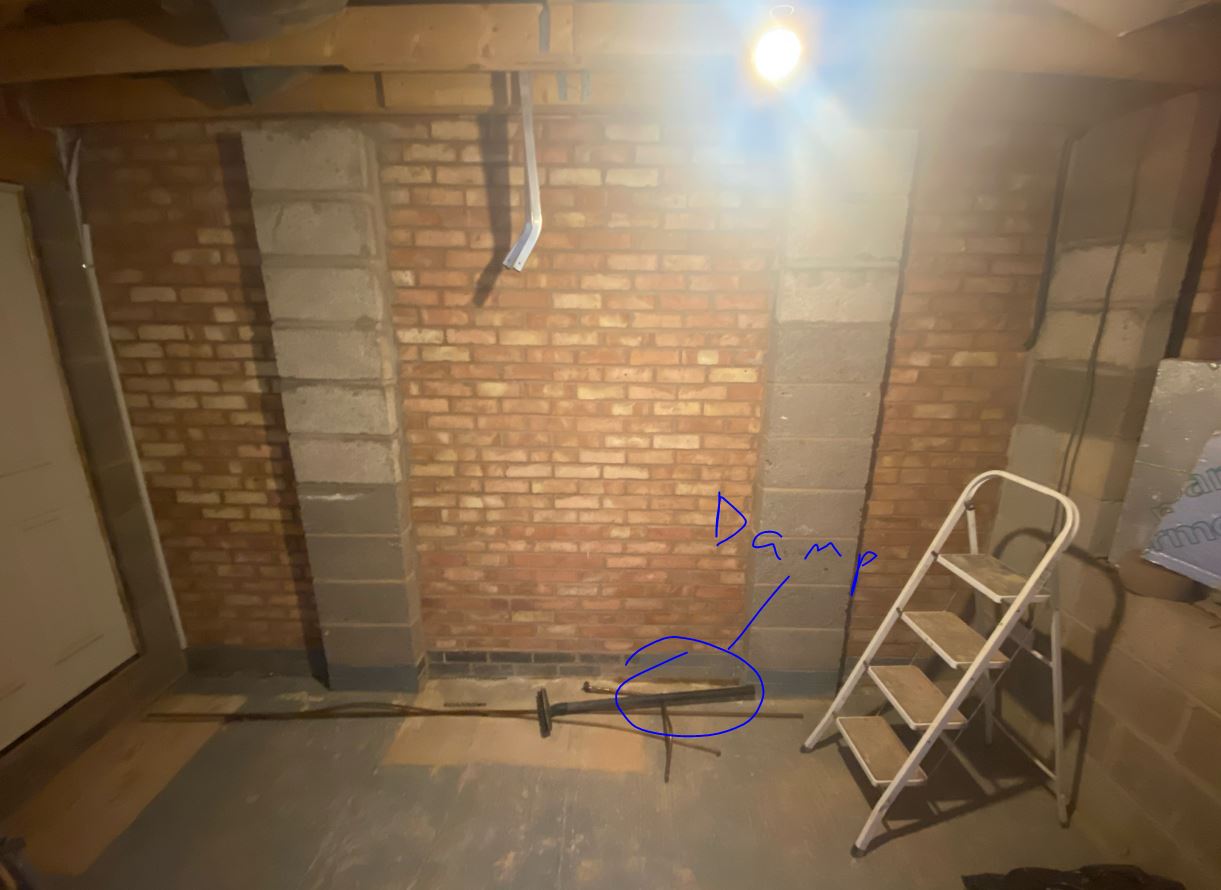

I've got one wall that's slightly tricky. Its single skin so will be insulated using PIR sat within a timber frame. I've just ordered some tyvek house wrap to use as the breather membrane. However, there are piers on the wall I've got to go round. The plan is to layer it (without tape), so top layer hangs in front of the bottom layer (as its 1.4m width roll).
What's the best way of attaching the membrane to the wall? I've got 2 piers to get round. The timber frames were going to go either side and in between the piers and then overlaid with 30mm of PIR. I'm wary of piercing the membrane but need to ensure its fully covering the piers and I've not got any gaps. Any tips?
There seems to be some damp in the bottom corners, I've attached a picture if that helps. I'm going to put some DPM down over the slab anyway as the DPM under the slab doesn't seem to be working at the edges. Whats the best way to tie the dpm into the vapour membrane?

It'll be a floating floor so there won't be any joists to screw into at the bottom. Unless I run that wall first and then screw into the concrete. Could that cause damp issues as the DPM would be pierced.

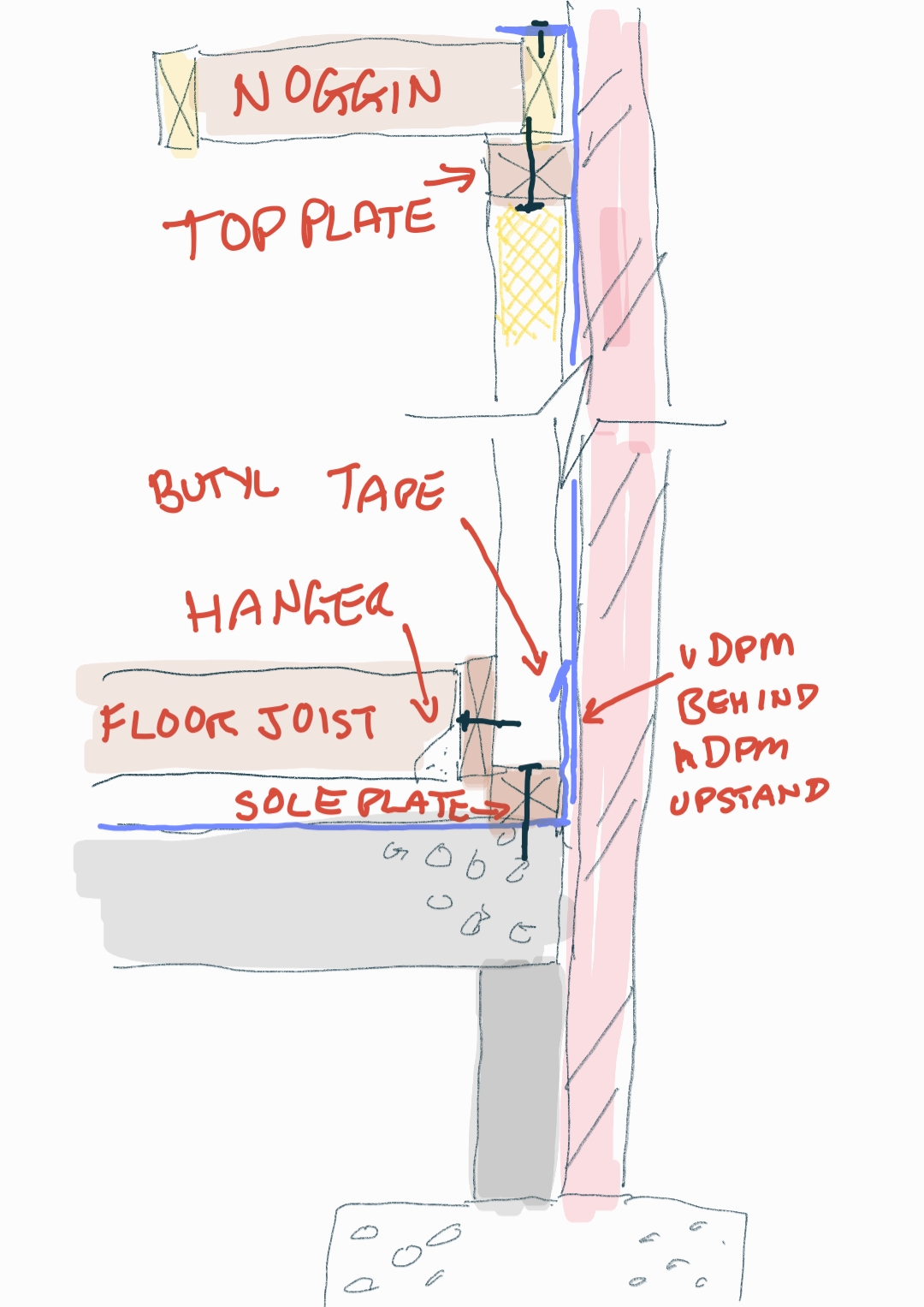

Here's the principle.
You would use polythene vertically and across the floor, and lap and tape the joint as shown. You are making a floating floor, so ignore the joists, and just butt up to the frame.
I'm confused that you mention using a breather membrane. Was that to be used instead of polythene? If so you will need to construct the frame first and then staple the membrane to the back then fix the frame. Awkward. And strictly, if using membrane you would need a minimum 25mm vented cavity for it to work. I suppose you could have the membrane tight up the back of the wall, but it's a bit non standard, and you'll need to be careful with the detailing. You'll also need to fit a strip of polythene to the frame first, which will lap the floor DPM after the frame is fitted, and then the membrane over the top of the polythene.
