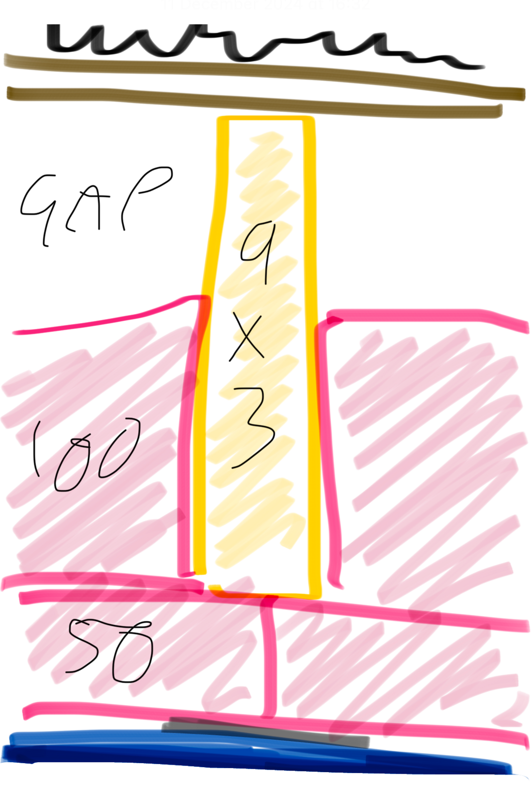

edit: did a sketch (attached, but not inlined now) then realised I wasn't sure what you're insulating! If it's loft ceiling, that's what I meant and I'd taken the 9x3 as the rafters (sketched buildup is tile/battens/gap with rafters/insulation with rafters/insulation over rafters, with taped joints/plasteboard)...
If I misunderstood, correct me and I'll sketch something else

Okay yes, thanks, that’s really helpful. My roof rafters are 4x2, it’s the floor joists that are 9x3. So should I go for 50mm between the rafters with 50 air gap then 100 across the top? The plasterboard fixings will need to be very long!

Ordinarily, you'd add knock-on thickening battens to the underside of the rafters to deal with the air-gap + PIR thickness.
100mm PIR beneath would mean ridiculous fixings for the plasterboard.
And very expensive.. 150mm phosphates are circa 10p each
Extending the rafters with a 25mm batten may pay off, and then you either get 25mm draught gap to help keep timbers dry or if you want a bigger gap you could go 75/75
Generally if I was fixing 12mm plasterboards I'd want 25mm of screw into the wood
