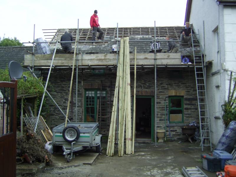

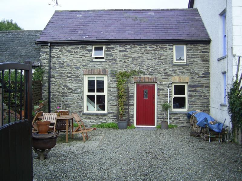

We had our roof done two years ago and it cost us £8k. The roofer was able to reuse half of the original tiles and fitted second hand Welsh slates to match and finish. Copper nails were used throughout, all new battens, and silver foil insulation.
Good job and a good price we reckon. He also fitted it around a new stove pipe.
