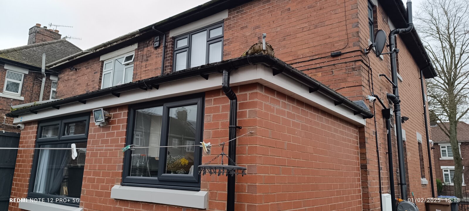

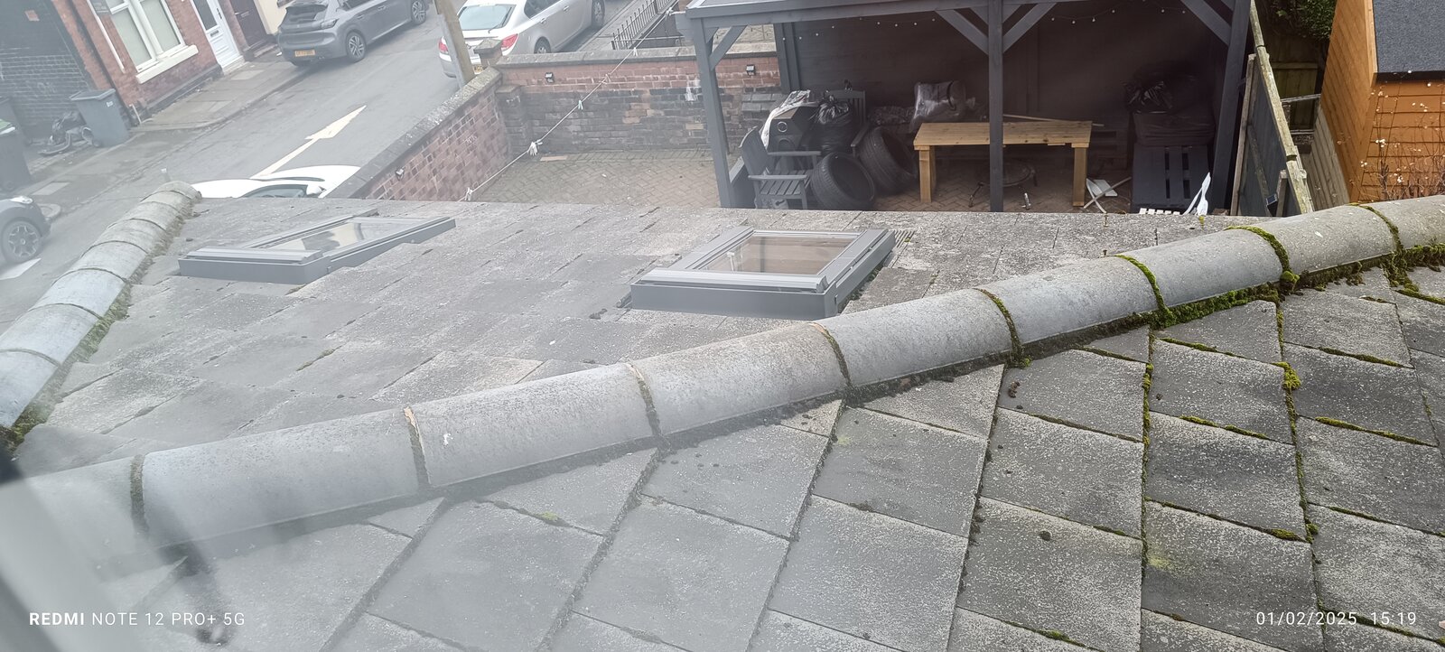

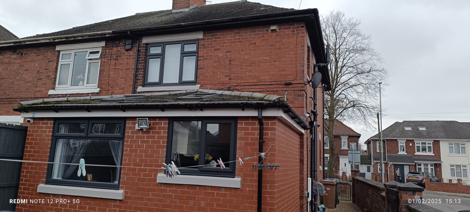

Hi guys my insurance wants know how flat is my roof on my existing extension , I wasn't sure so said upto 20% .....I've had insurance today so can update Monday.....I did say it's not flat but insurance said if you can stand on it must be flat at some point..... could you please let me know what it is ?
Please see pictures.

That's not a flat roof.
As for standing on it, I can walk on my tiled roof on our bungalow and I've walked on many tiled roofs.
A flat roof has a slope so water runs off but the description don't mean it's flat.
It's nearly flat.
Felt or fiberglass or even rubber.
You have a pitched tiled roof so stick that on form.
It's nearly flat.

For the purposes of insurance that's a pitched roof, a flat roof is widely recognised as having a pitch of 10deg or less, that's also the BS definition.
