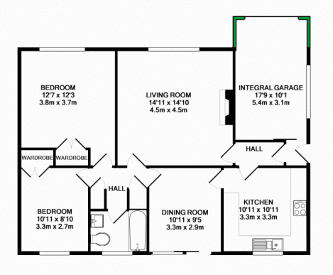

Thought to include a plan from my other post to make it visually more clear. The bit of the garage which is protruding under its own flat roof is highlighted in green. However the walls are there as is the rest of the bungalow, brick and block construction - would that follow that appropriate foundations to support the walls are already in place? And if the walls do have the foundations, is it possible that no foundation was included in the door opening?
I'm a bit worried when we go to BC, if they may require us to dig to check foundations just because that's what they "always do", rather than looking at whether it is necessary.

Building inspector is not going to ask you to do any foundation work if your fitting a upvc door the size of the current brickwork opening, he will likely want the floor insulating which will mean you'll need at least a couple of courses of brickwork below the door but again I can't see them asking questions about foundations for that.
Thank you that is reassuring about the foundations!

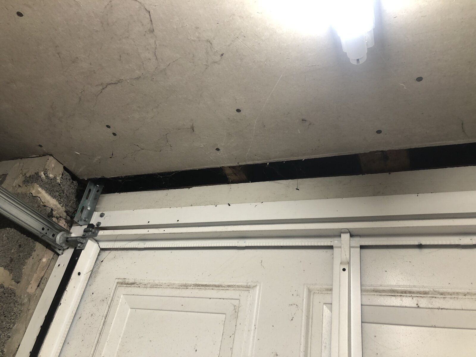

A good point about the lintel. It doesn't look there is brickwork above the current up and over door, there is just the flat roof. I include a not so good picture taken from inside the garage, the plasterboard ceiling doesn't go all the way up to the door leaving a small gap through which I can see wooden beams which I understand is the flat roof structure. But I'm not sure what those beams are resting upon, they run perpendicular to the up and over door.
You will need to have the flat roof insulated to current standards, which could involve a bit of work.
Will be asking BC advice about the insulation first thing. Both floor and flat roof are a bit non-standard, floor is only 1-2" lower than the rest of the bungalow and not much space in the flat roof either by the looks of it. Hopefully we'll find a solution!
