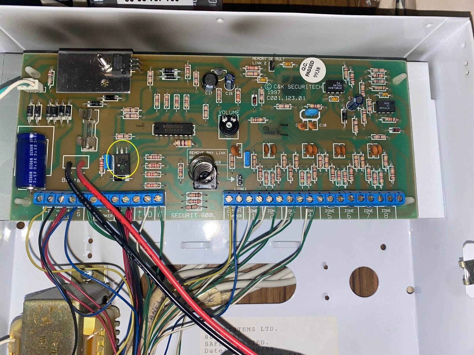

Intellisense Securit 800 keypad advice sought.
When I do 1234* it does same tone beep and whatever zone/PIR is being activated shows on the corresponding pad.
When I do 1234 to set alarm I it does a dual tone beep but does not seem to set the alarm ON?
The PIRs are getting activated though when I was doing this.
Would this prevent it from turning ON?
Plus what is the indication that the alarm is set ON?
Cheers
If your getting a two tone noise as in ne-na then it needs a reset by pressing #
Is the 24 yellow led off ? If not it won’t set as there is a tamper
The day light indicates set or unset
Yep sussed that I had to just press # when I had it that mode when I could see it trigger the PIR/ 4 zones.
I had the 24hr led off I think withn 1234#.
Not 100% how but it is off
It already triggered when I got there as tenant had removed the control box cover.
so it seems the alarm is constantly SET as DAY led is constant ON??
Yet I’m getting a 2 tone with 1234*.
Never seen anything so basic tbh.
Cheers
If you can’t suss a basic panel god help you with something more advanced .., by the way DAY light is off when set …it makes common sense …
Suss what?
Like I stated it’s very basic yet the info provided above to set a new code does not work.
I did to reset the NVM though.
As I stated 1234*91 does not enter mode to enter new pin. LEDs 1-4 do not illuminate.
I work on much more complex things than alarms mate.
Cheers
Hello. I moved into a place with a faulty alarm similar to as you describe. I replaced the battery, but it still didn't charge. Then I saw a chip on the board which had physically blown from the board. I assume it must regulate the charge to that backup battery. I replaced that too, and all came good.
I did wonder if the IC in the yellow circuit was blown on yours, but I think they look like that!
