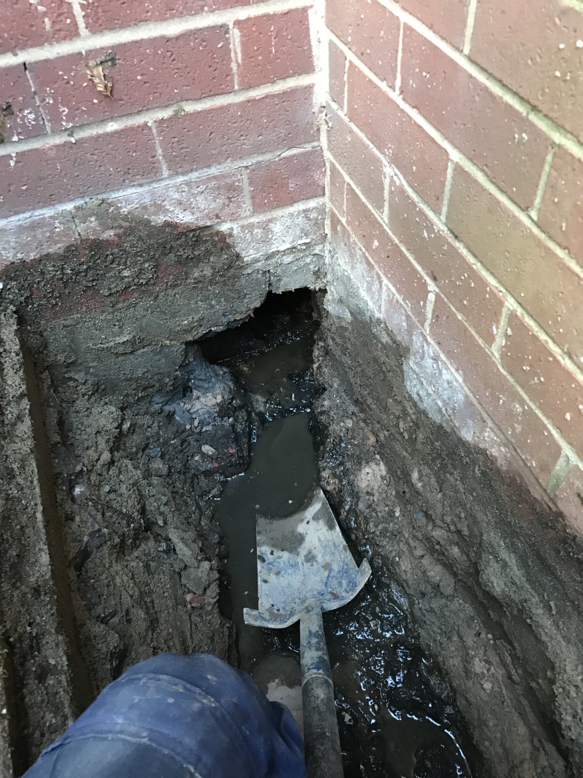

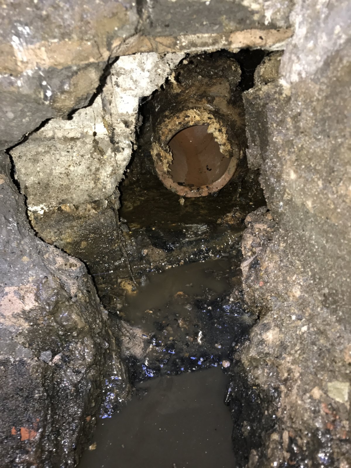

I'm at the university of Uppermill(f) today conducting test on leaking drains.
No damp to be seen despite a long term leaking internal rest bend.
I'll keep it brief for all you uneducated folk.
Conclusion:
It's ****ed.
The end.
