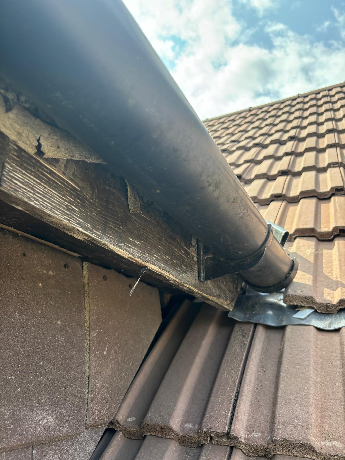

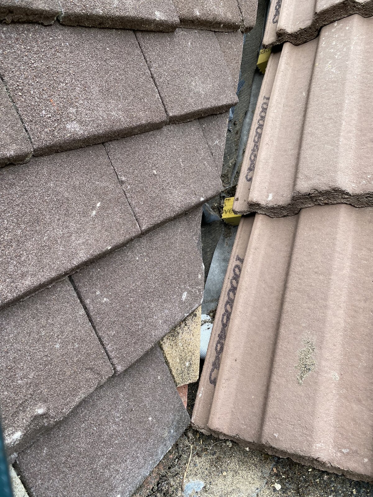

Hi,
I paid for my roofs to be fixed, maybe I should have hired someone different!
I have a tiled wall regular tiles, that meets a pitch roof Redland 49 and there's a large gap where they meet
I don't know what is meant to go in there, it was lead before the tiles were changed,
I asked them to sort but not seen or heard from them for over 4 weeks so it's going to be a DIY job
but I have not dealt with interlocking tiles before any advice would be most welcome

The lead flashings are missing.
You have wall hung plain tiles meeting a pitched, profiled tile roof.
Given it involves working on a roof, & lifting and replacing plain tiles and profiled tiles, & cutting & shaping the lead flashings- then its probably a job for a roofer.
I can’t imagine what sort of roofer would miss out the lead work!
Almost any tradesman with a bit of common sense would know something has to go in BEFORE the tiles are fitted.
The tiles are going to have to be stripped back and the lead work done, it can’t be made weathertight by dressing lead over the top.
I’m not a roofer but I believe redland 49 tiles can’t have lead soakers so it probably needs a secret gutter formed in lead and the redland tiles cut with a 50mm gap

Well, I admire your charitable view of your now departed roofer. However, it remains the fact that he removed your lead valleys, didn't replace them and then disappeared with the lead. Seems to me that he's stolen the lead from you. I don't see how it can be viewed any other way.
Thanks, noseall so that's over the 49 and under the wall hung tiles, and another roofer joins the list of not turning up
:cry: Do you by any chance know how much over the 49 tile as I will be buying wider lead judging by the gap (Tunnel) they left!

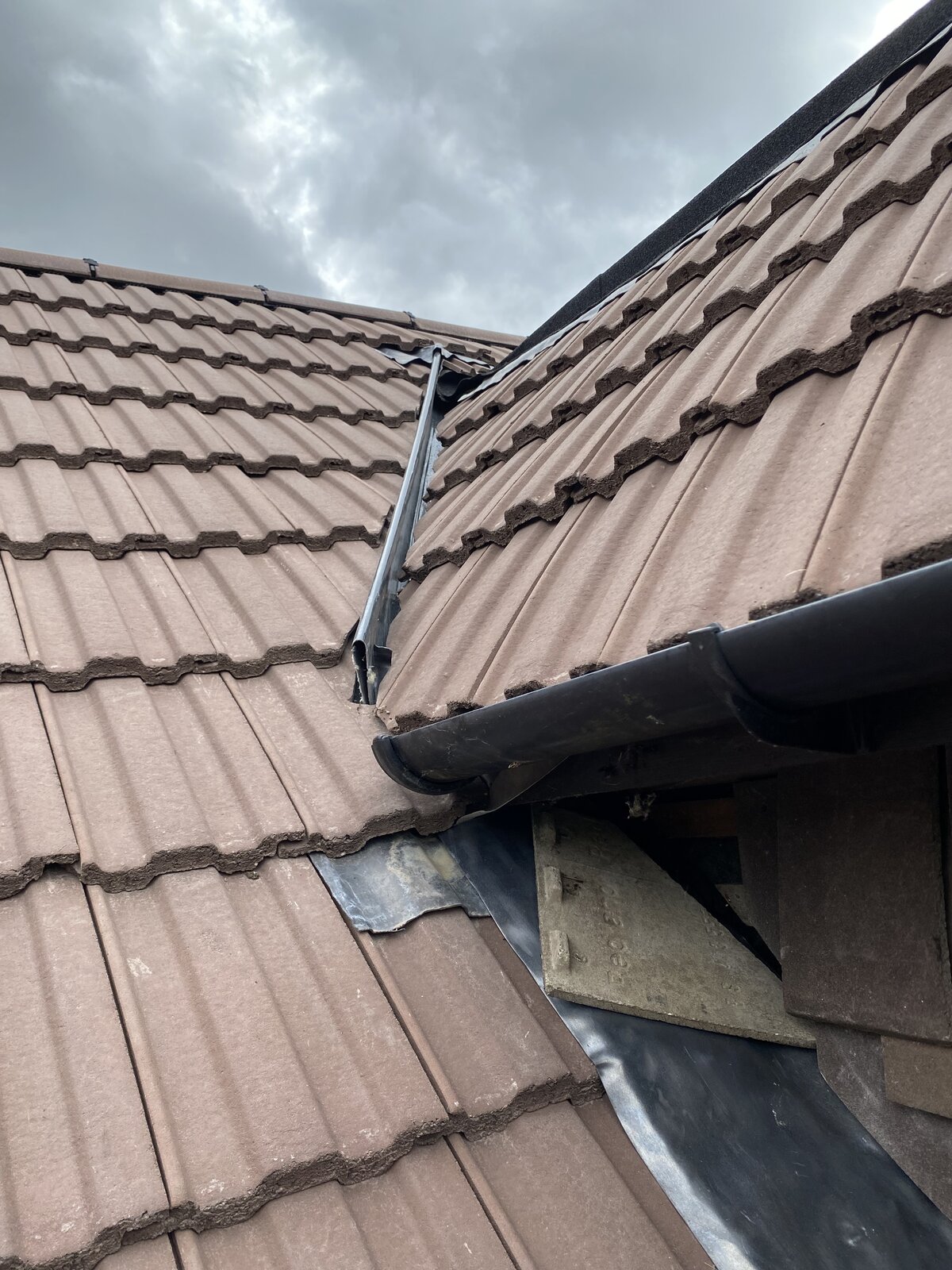

On looking at the gap, I can't see any overlapping as they cut my underfelt on the wall, can I put some in ?
WELL! I actually got a roofer round, he thinks the whole roof needs to come off and start again and get rid of the 49 tiles and put the old ones back on (they will be new Chris)and it will cost more, but it's the best option. HE APOLOGISED so many times but won't do the job as there would be reprisals, he even confronted ch****trade about the amount of rogue roofers on their site and was told he was racist !!
