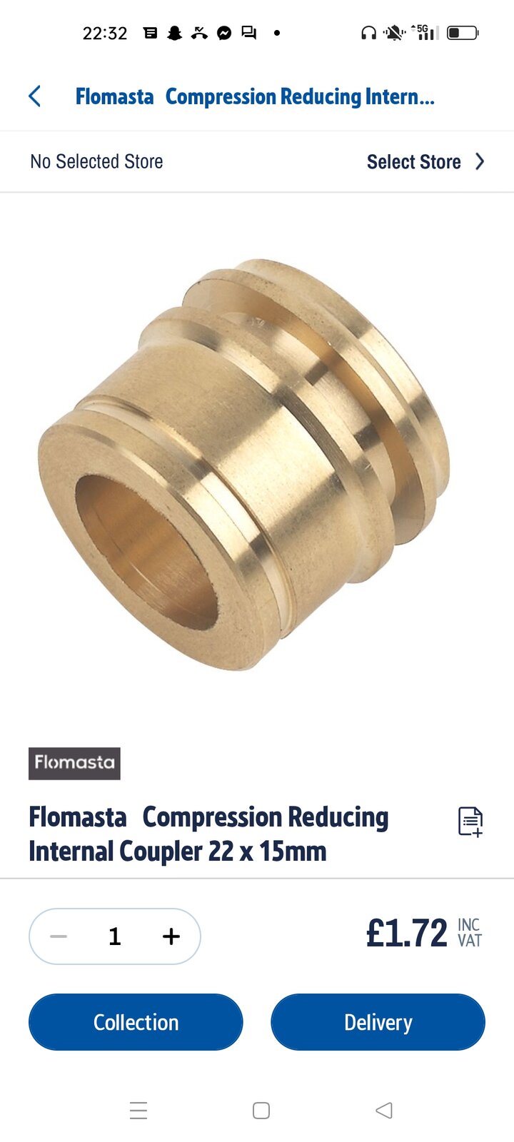

Internal 15/22 mm reducer
4 Apr 2010
958
19
Humberside
If these leak is there anywhere to wrap PTFE or add paste. Like you can on a regular olive? Thanks
Hi,
I'm only a DIY'er, so am happy to defer to the pros!
But I believe when these have cracked on tightening (as they are supposed to), there isn't much you can do to stop a leak (apart from trying to tighten them a little more) - and it's a case of replacing the fitting.
When I have needed reducers, I have used the multipart ones, such as:
I've been happy with them, and there is space to add the PTFE/LS-X before you make the joint :)
