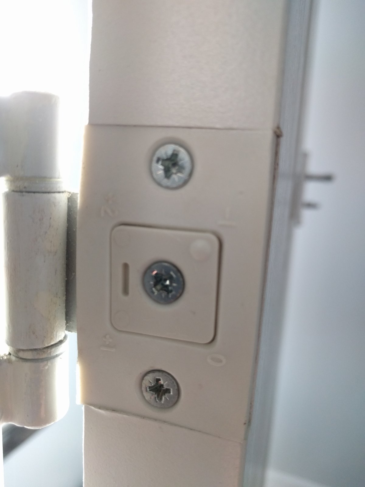

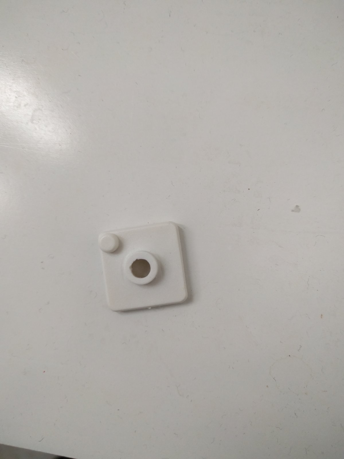

Hi our bathroom door has started to stick at the top ( seems to happen when it gets cold)
Can i adjust the hinges as I've noticed there's some numbers and letters on the hinges? Or is it a case of only way to taking the door off to plain it a little at the top?

Never seen the like before, but I would try removing or loosening the centre screw looks like rotating the square may give you some adjustment according to where the raised bump is.
I think they just adjust the width of the door
get a bit of cardboard fold in over a few times and put between door and linning at top hinge then close door it will bind and crank hinge hopefully enough to miss head when closing you need too feel some resistance for it too work or just buy a cranking bar is alot easier
