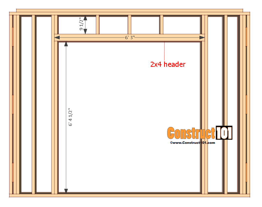

Something like this (just the first pic I could find - I'm not suggesting it's best practice!)
The distance between the beams decreases depending on the height of the doors.
