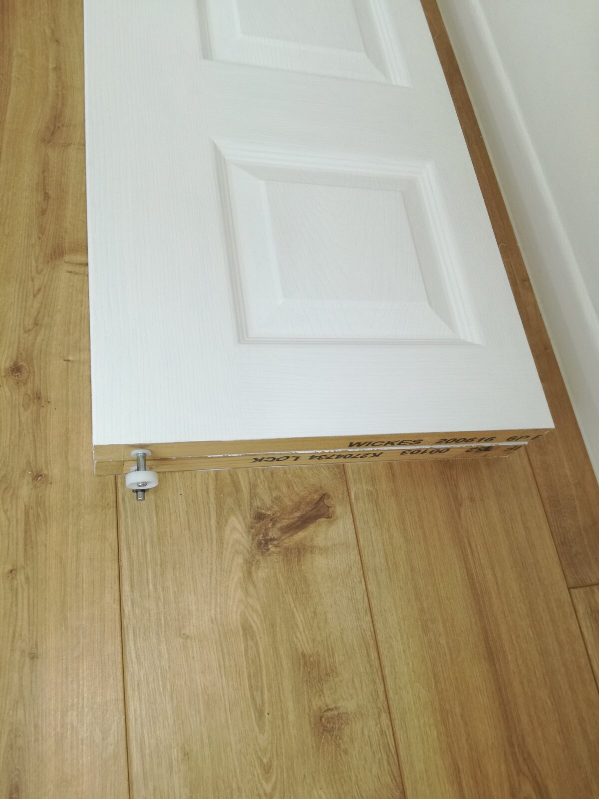

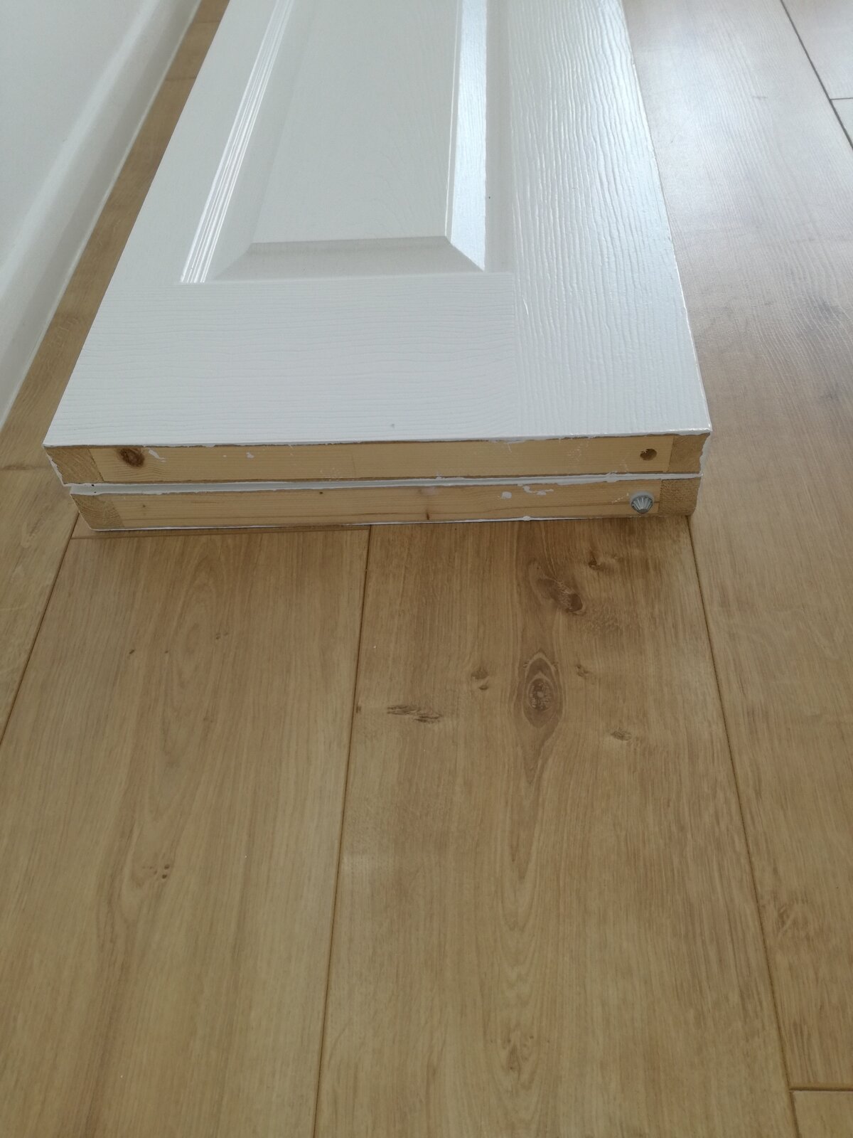

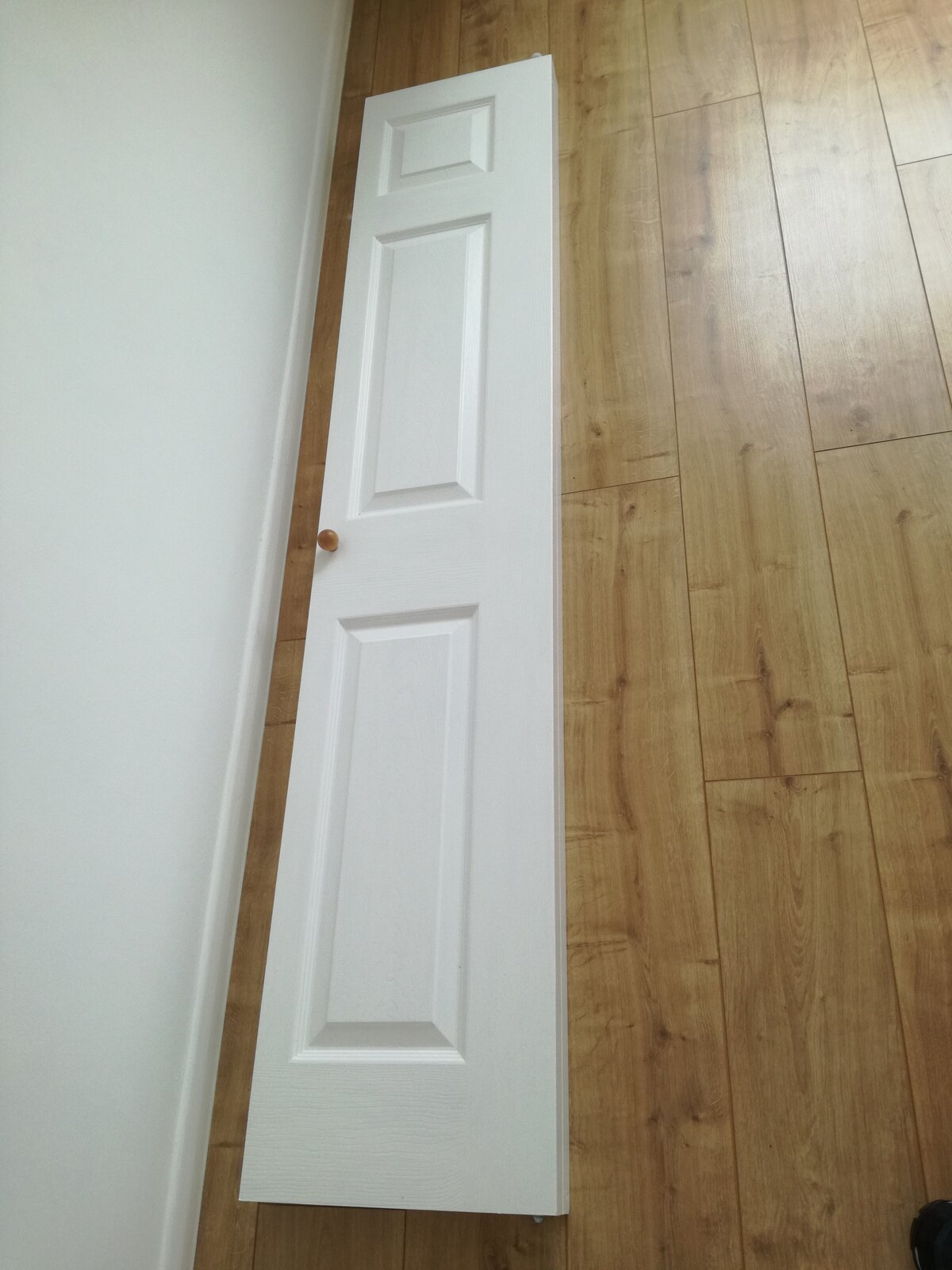

Here are the pictures.

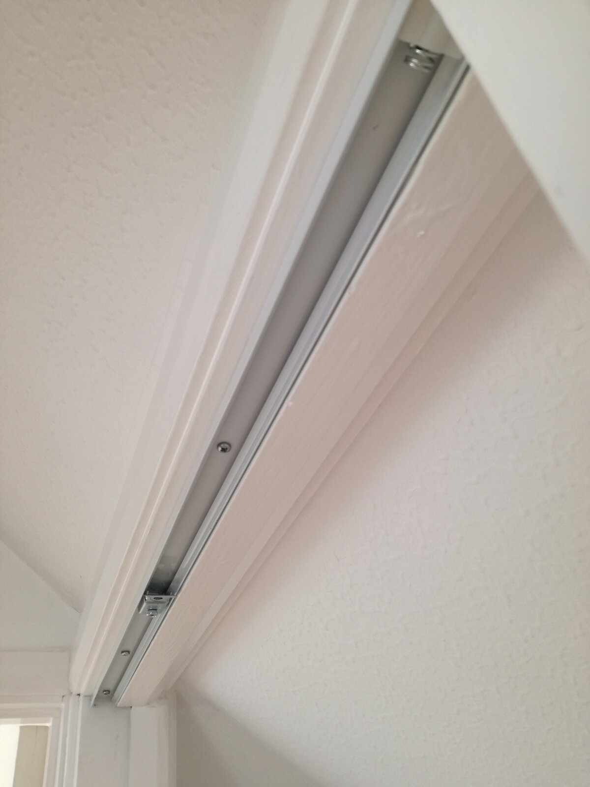

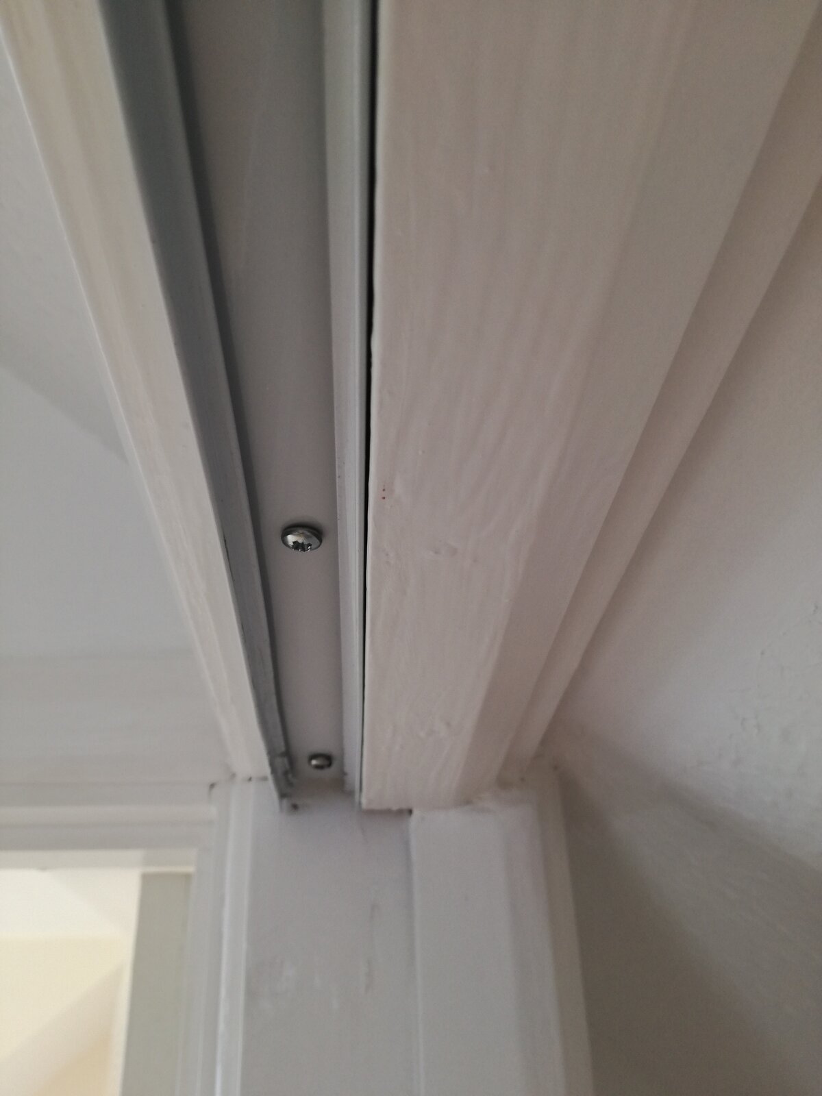

Subtle damage from the second screw till the end of the rail which is over 20cm. Enough for the door not to stay in place when you want to pull it open full or close back.
I tried to straighten with pliers but the metal is so hard that it does not move, I'll break the frame before. I doubt anyway that I can straighten it good enough for the door to have a smooth move. Need to change this as next tenant might force it and I will loose the door as well.

I would remove that top rail and see I could straighten it out, it doesn't look so bad as to need replacing.
I would remove the top rail put a piece of wood in the track the same width , place a piece of wood over the bit you want to bend back and go to town on it arse with a hammer

I fixed my problem by unscrewing the rail and turned it around right to left, left to right, which seems to work fine as the undamaged part of the rail is placed now where the bi-fold door hangs.
Harry, I tried to straighten it out but the metal was so hard that it did not go back to its shape at all.
