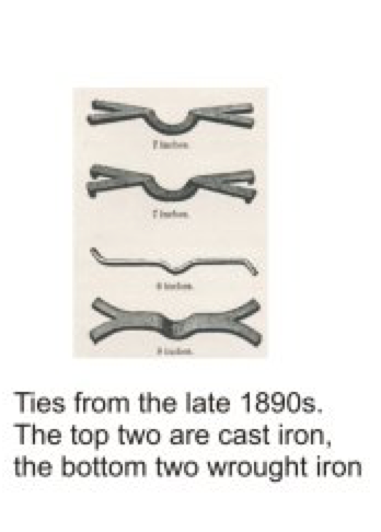

Thanks for the response guys, this is exactly what I thought. The downstairs section of the same wall had the cavity open in the same way when I was re-plastering (the wall was solid though), I could see all the way down the cavity in to next door. I could also see brick ties that had rusted to nothing, so they had been used, They looked like these top ones:

Those are the kind of things that are used. Those thicker ties often lift the bed joints when they rust showing cracks in the facework.

Shame you just had it repointed, as with your type of wall tie they often need removing to stop them expanding when rusty and lifting the brickwork.
