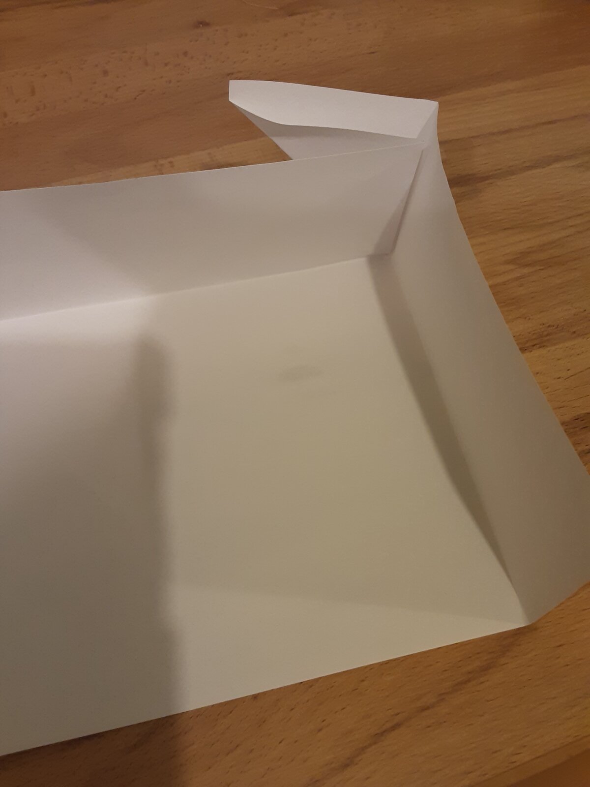

Agree with Exedon - dog ear the corner. Practice on some paper and you'll get the idea. I like to set up a corner, remote from the roof so that I can bat away without breaking the tiles. I'll even use a sacrificial tile (if profiled) to mimic the tile peaks and troughs, so that I can shape the lead as best I can, before offering it to the roof.
Thanks for advice. I was going to get up there tomorrow with some paper !!:LOL:
I'll try and get some pics.
Would the horizontal chase and the angled pitch chase need to meet? I've seen it before where the angles pitch chase sits under the horizontal where it meets in the corner. I'll have a play around tomorrow. Thanks again

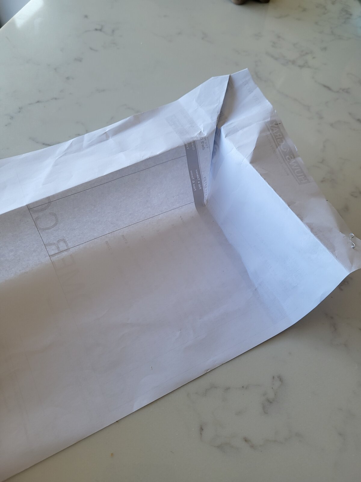

So my mrs thought I had taken up Origami last night!
Is this the sort of thing that would suffice? And if so does only 1 need to be turned in to the chase and the other flashing can sit over it. In other words do both corner peices need to have this done to them?
Thanks again for all advice
Thanks for that. Only thing is, I will have to turn the edges to fit into the chases. So does the corner need to be bossed to form the point?
Sorry for all the questions but it's too late when there's water running in :D:ROFLMAO:
