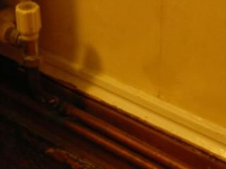

This shows the damp patch on the wall and the radiator pipes I thought were causing it. There obviously was a leak there but it's equally obviously old and the pipes are dry.

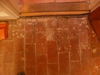

This is where the hall way joins the dining room. Note the condition of the tiles. They have laid modern tiles over the old tiles which is causing damp in the hallway too. Nice. Will have to dig those out too!
This is one area where the tiles will have to be relaid.

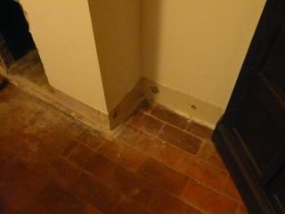

I removed the skirting boards from this area. Note the plaster joins with the tiled floor.

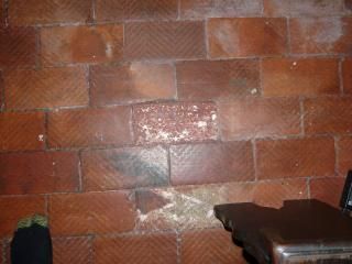

Tiles in the dining room on the other side of the wall with the damp. Some in pretty poor nick.
Damaged tile. Note the pattern left by the underlay.
I think that you have damp coming up thro the concrete - i would also suspect that rising damp is affecting the walls here and there. The moisture came from somewhere, and as there are no signs of condensation in the pics i'd suggest that it came up from the soil.
The hearth areas might be particularly affected because the tile could be laid on a very thin skin of concrete over the hearth fill soil.
Often people clean up the tile and carry on - the old tiles give character to the floors, and the damp is no big deal in warm well ventilated rooms.
If you decided to lift all the tile then you might consider replacing the slab. Lifting old quarry tiles can sometimes be difficult - the old "adhesive" was a S&C slurry, often set on a wet screed. The grout is also S&C.
Yes - for the record - I'm 99% sure that what has happened is that moisture has been rising through the tiled floors.
This would not be a problem but the floors were covered in laminate on one side and carpet on the other. The waterproof underlays meant the moisture had nowhere to go, hence the floors were actually wet to the touch.
Obviously, this wetness has to go somewhere, so it rises up the walls, causing rising damp.
Once the laminate and carpet were stripped and the tiles allowed to breathe, the floors dried out in a matter of hours.
Sorry, the photo is misleading here. The hearth area appears to be badly affected by salt deposits but that's just because the photo is too small. Its actually the case that they dug the tiles out where the hearth is laid and the light coloured area around the hearth is where they used cement to lay the tiles.
