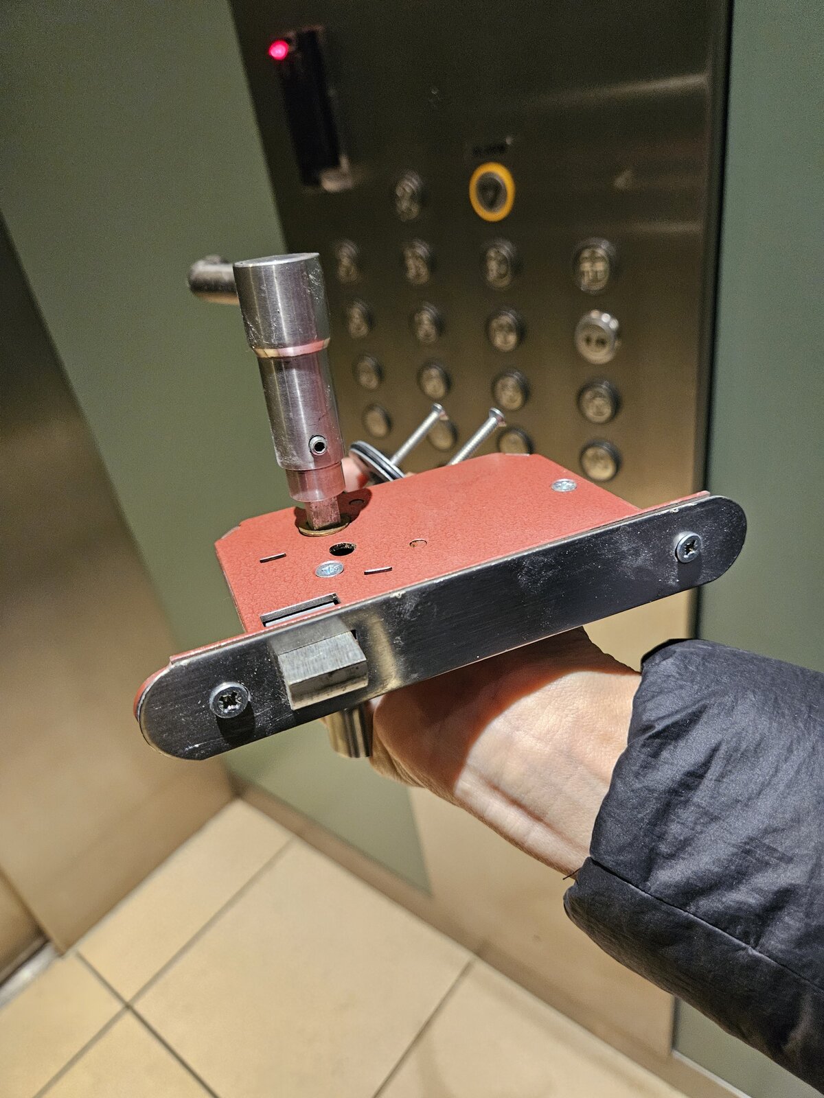

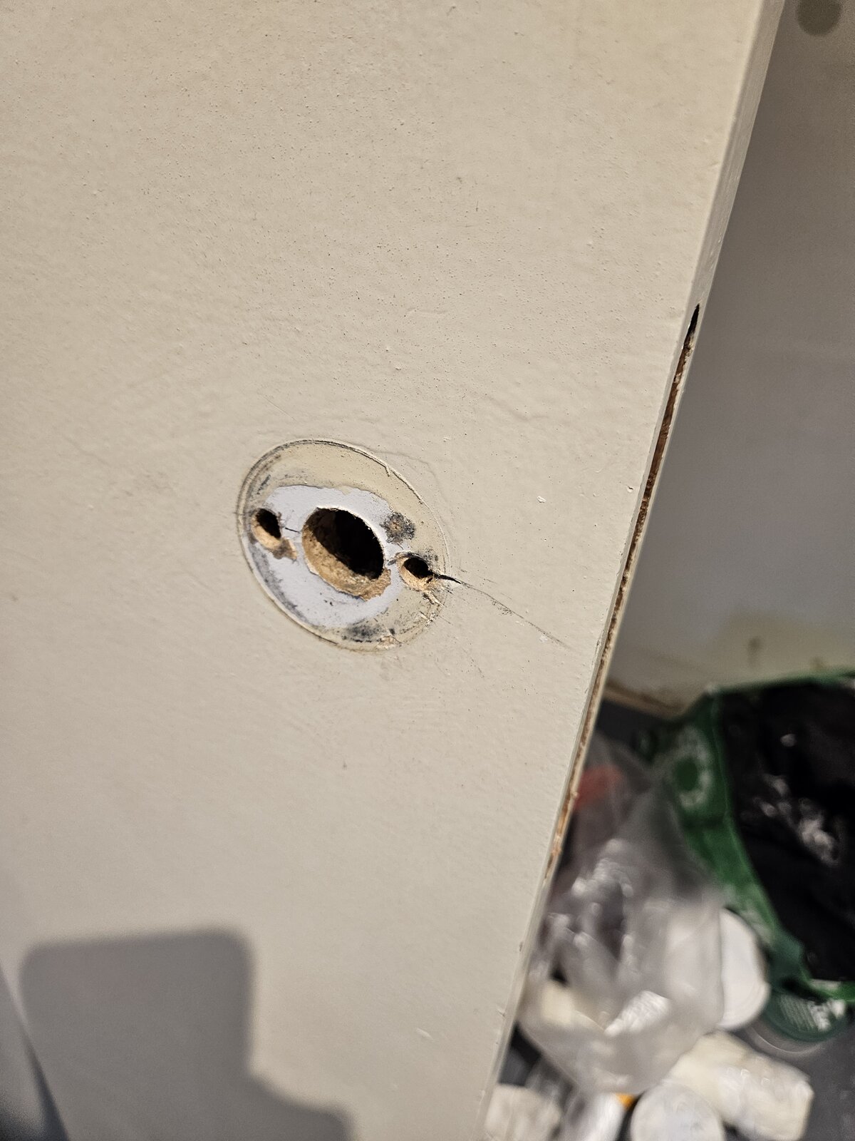

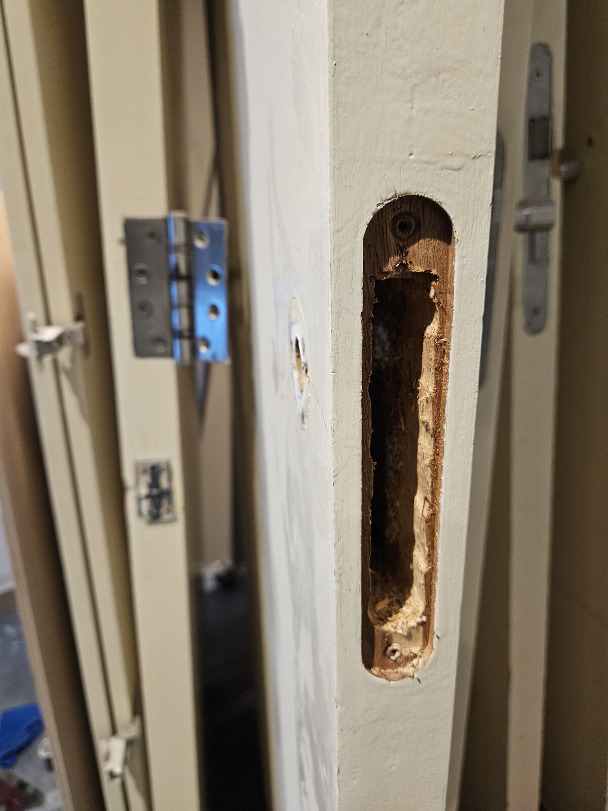

Hi all,
I'd like to be able to lock 3 internal doors in my flat, with keys.
The current setup is as in the pictures attached, the doors don't lock.
Would something like this work?
I guess I won't be able to use the old handles? I'd like to have a lever on rose handle as the existing along with a separate escutcheon for the keyhole.
Any advice is hugely appreciated as I am DIY newbie.
Thanks so much! Wishing you all a happy new year.

Looking at the first 2 pics, those doors look like weak cheap doors and a good kick will open them no matter what locks you put on (even the hinges need attention).
Put a mortice lock on. About £10.
Handles clamped with through bolts.
