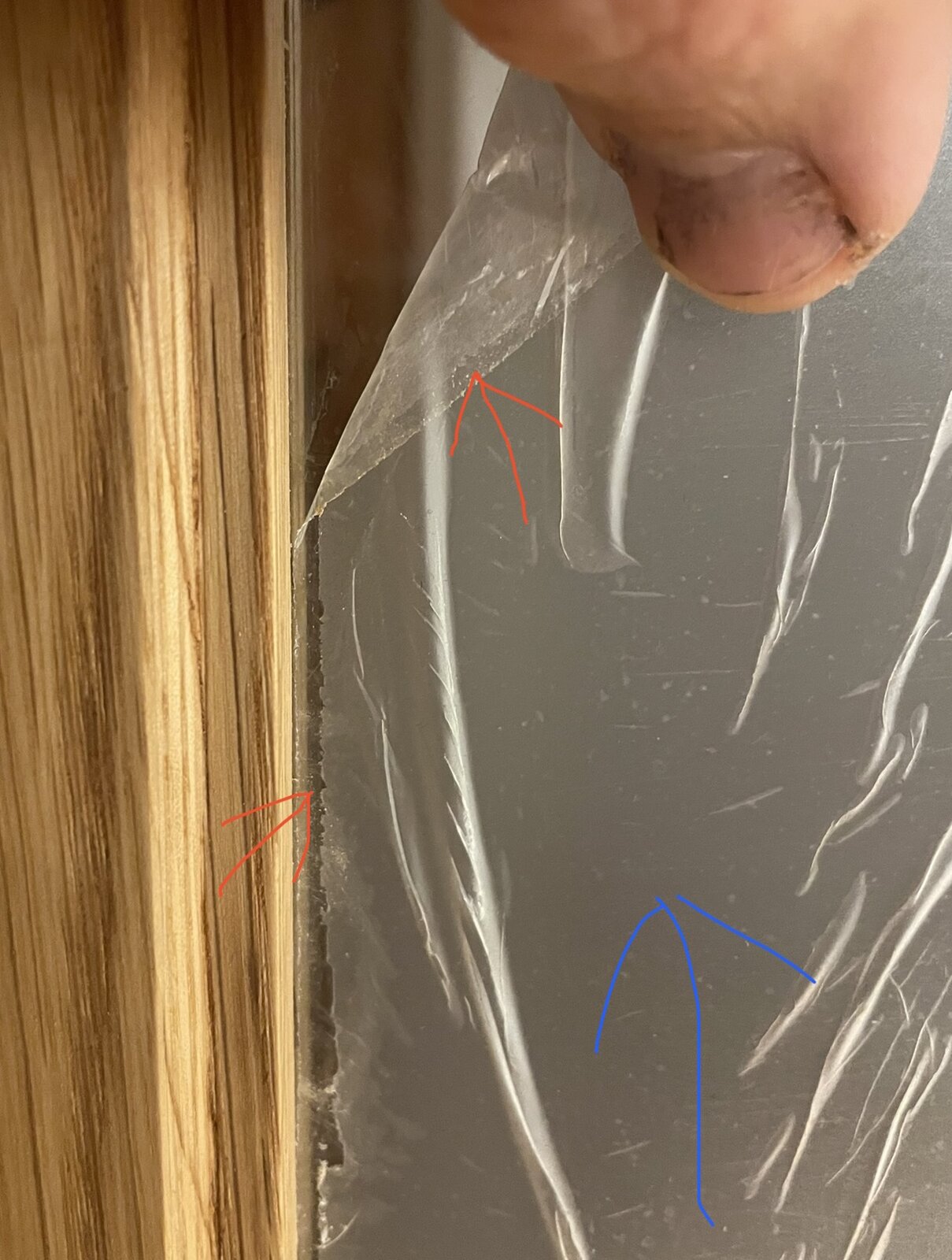

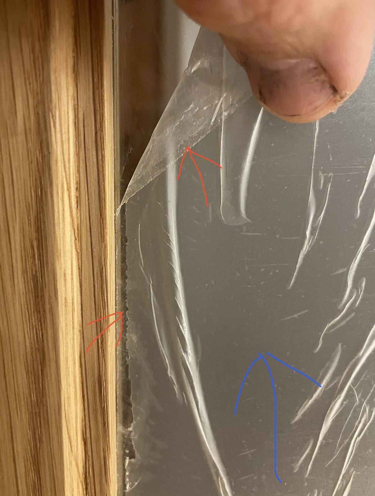

You can get spray paint that gives a frosted effect. I've used it on my glazed bathroom doors to good results, though the kids do like to try scratching it off sometimes (and they succeed, perhaps because I actually sprayed it into the protective plastic film that was applied to the glass, in case I didn't like it and wanted to peel it off. It was one of those "erk, mother in law is coming and all the bathroom doors are still clear glazed, let's do a quick hash up with that frosting paint we bought, but make it so we can change it if it's terrible.." - and that was 8 years ago)
Take a look at the attached: the blue arrow points to a place where the film was flat so indicative of the end result, the red arrows point to where my hasty masking of the film meant the edge wasn't sprayed so you can see the difference between frosted and not
Maybe cling film/sello tape the glass, spray the film, see if you like it so you can peel it off if you don't
