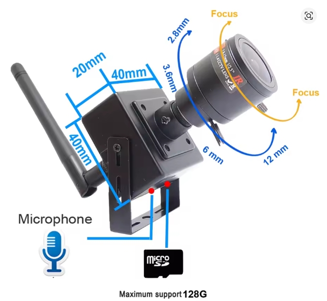

Hi, I'm looking for 3 cheap ip pan & tilt cameras to read the digits on a gas meter, water meter & two pressure gauges that are all in my loft/attic as i'm 70+ & can see an accident coming with extension ladders & climbing up there for readings. I would prefer to see the images on my computer if pos. I tried a cheap £20 one, & very good for security, but no good on close-up. Any suggestions?. Thanks.

The gas meter is one we fitted a long time back as we are on LPG & there isn't a smart gauge for my one, but we could change the meter. The water meter was a smart one, but had a mind of its own & would often turn off or go to 20%, so i just changed it for an old-fashioned digit one as we dont think the new Anglian water smart one is reading right..So! i will try a couple of these £22 ones below. on offer at AliExpress.

I dont know what you have I have no distances and I have no lighting information, so I may as well pick things at random. and hope I stumble across the solution.I dont see the dials/ meter faces. I cant be cretain that the image you have is wrong because the camera is the wrong spec of that its setup incorrectly.
I can take you to a million different sites and how cameras set up correctly for the job and the same camera doing something similar and not setup correctly, I can also show you the wrong camera for the job that is wanted from the customer.
lots of posts across the net buy a camera and dont have it properly specified you will find it either over kill or not capable.
when you zoom in some have automatic focusing and some manual, how crisp you get what depends on these factors being optimised
keep picking things at random means a lot of sending back if you dot get the right kit specified and tuned in.
