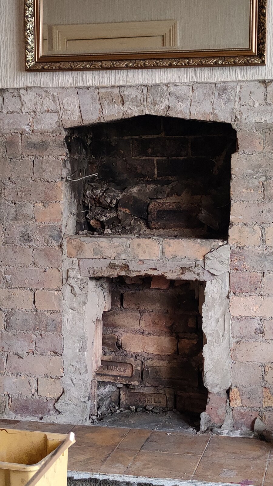

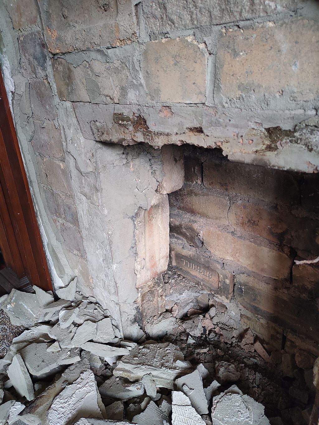

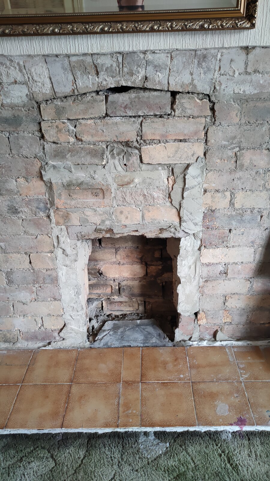

Opening up the Builders space to install a multifuel stove and discovered the arch lintel which doesn't have a steel support as mentioned elsewhere. You can see how they just filled up with bricks on top on a "mini-lintel" but underneath the arch which is why the brickwork is ropey cos it's just filling space. Removed the fireback and the space seems to be 2 feet wide. Just enough space for a small stove I hope.
Hoping I can just keep the lintel as the brickwork and pointing seem good for a 1934 house!

No iron bar but yes thankfully seems brickwork is sound since 1934...compared to some I've seen posted.
But the space is actually only 2 feet wide, 60cm. Regs say 6 inches each side of the stove but now I think that just means if the side is combustible materials not brick. My gap will only be 3inches with a small stove. Bit tight?

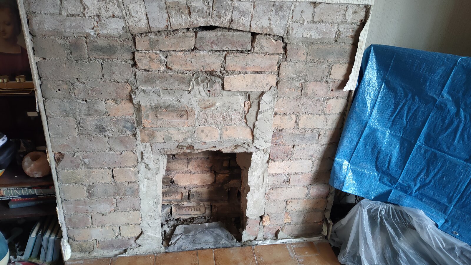

True but nothing to do. Widening would mean cutting through solid brick from top to bottom. Plan is to have it 6 inches onto the hearth with regulation clearance to the front edge. Then use those whisper quiet fans at the back or wherever to make the most. Plenty space back and top. Paying Hetas man to put the flu in etc.

Found some stiff wire in upper bricks - for a previous flap or something?
