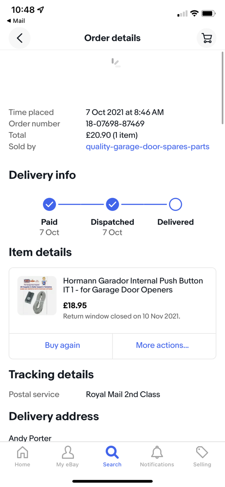

Wow, that’s a crazy price. Sorry, I didn’t pay 15, it was £21 delivered.
I’m guessing they’re low on stock at the moment, but the prices should go the other way as I can’t believe that’s just inflation since October
:) Thats the one.. "Currently Unavailable" on Amazon.. Out of stock most places.. Those that have it want almost £40...
