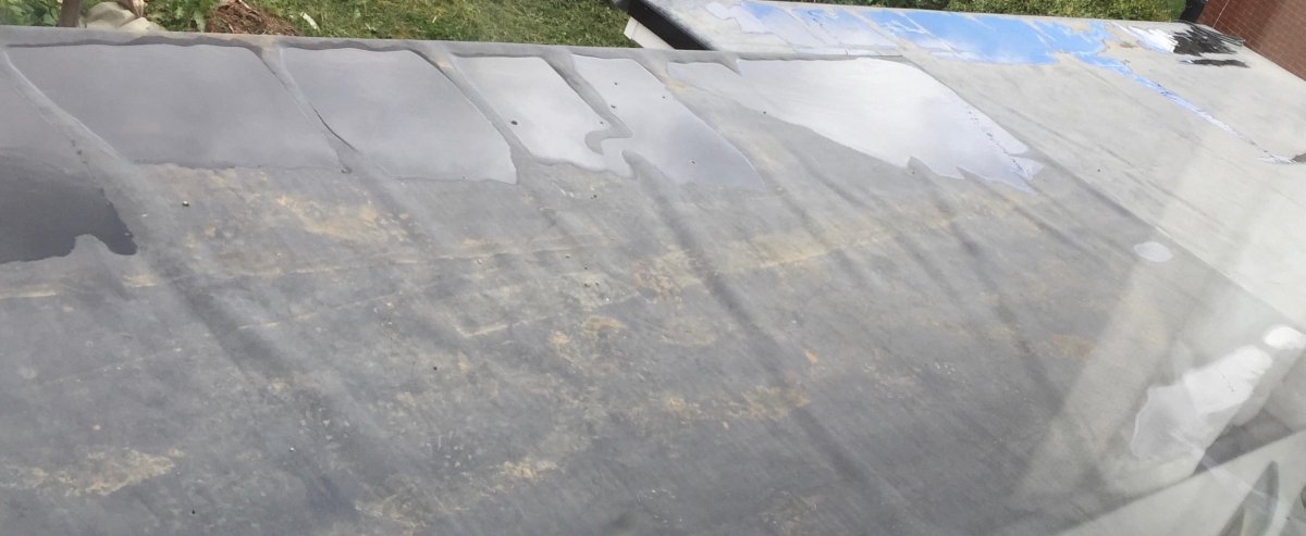

Is it acceptable for a rubber roof to have ripples?
Nope! Both the rubber and the wood must be glued together. I'd dig out the Firestone factsheets but it's past my bedtime.
Well I disagree, Firestone may say you need to coat both substrate and rubber but with wba it will make no difference if you wet lay the covering. If fact many of the other suppliers of epdm wba state you only need to coat the timber deck.
https://static.rubber4roofs.co.uk/s...chfiles/w/a/water_based_deck_adhesive_tds.pdf
This adhesive is designed to be roller applied and used as a one sided, wet lay in adhesive on flat roof decking surfaces.
It's the solvent based contact adhesive around the edges that needs to be applied to both surfaces, rather than the water based adhesive used across the deck, which only needs to be rolled onto the deck. Those were the instructions I followed.

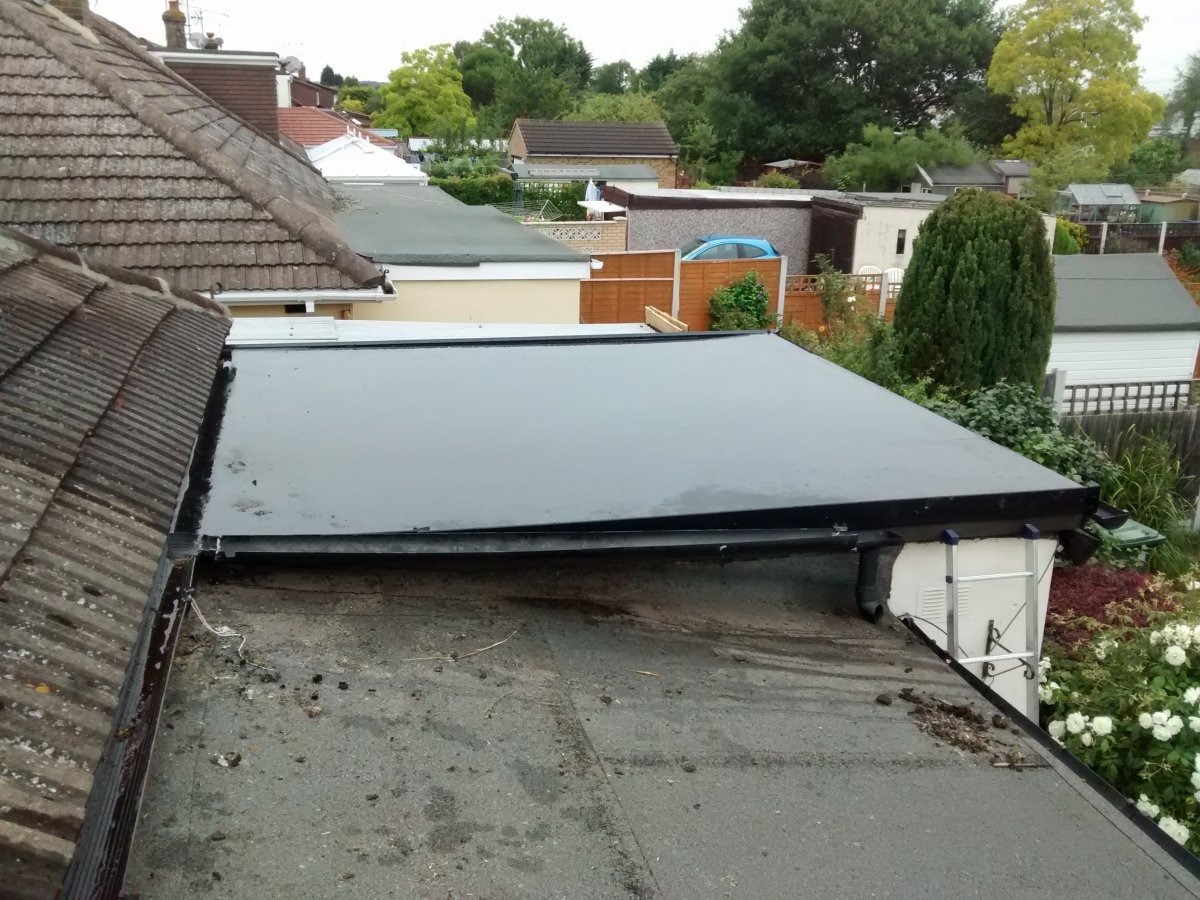

Attached is my first and only attempt to replace a flat roof with membrane.
It is really easy to do and seemed to naturally lie flat without creases, I did replace the boarding though so it had a new surface to lie on.

you are basically correct, the water based adhesive can only be used on new roof decking which means it takes time to cure this allows you to brush out any wrinkles which may occur.
If your are recovering an existing felt roof you have to use contact adhesive which means you have to coat both roof and membrane, you have to allow the adhesive a few minutes to cure before sticking the membrane to the roof.
The problem is as soon as the rubber comes into contact with deck it sticks tight and if you make a mistake and cause a wrinkle it is very hard to smooth out, also if you use to much adhesive it can cause solvent blisters which cause the membrane to bubble up.

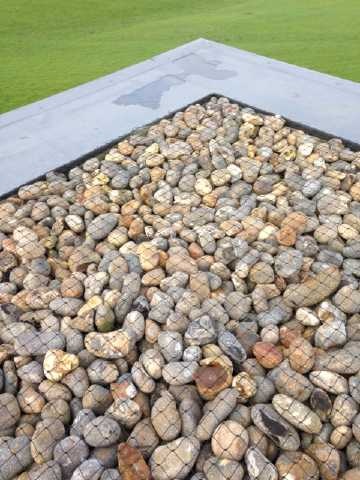

For DIY purposes the easiest method is to loose lay the membrane over the roof and stick the edges with adhesive and the screw on a raised edge trim then ballast the roof with the appropriate roofing pebbles to hold the membrane down.
The roofing pebbles also hid any wrinkles in the membrane.

I would never suggest anyone do a ballasted roof without knowing if the roof can handle the extra weight, this is really bad advice.
It's also not really easier as you have to lump a couple of tone of stone up to the roof.
