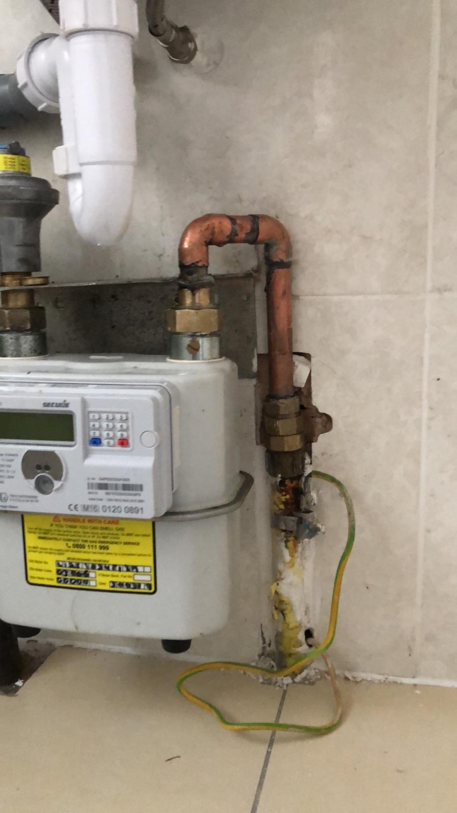

A domestic Gas Standard pre-payment Meter was exchanged for a Gas Smart Meter (SM) and then connected to the pre-existing pliable/semi-rigid/anacondas.
I believe this is illegal and breaks laws and regulations when this was done on 30 March 2017.
But my Utility company who had the Gas SM installed state that the:-
“the pipework did not need to be changed at the point of installation of the gas SMART meter and that the attending engineer completed the work in a compliant manner”. (FULL Response at end)

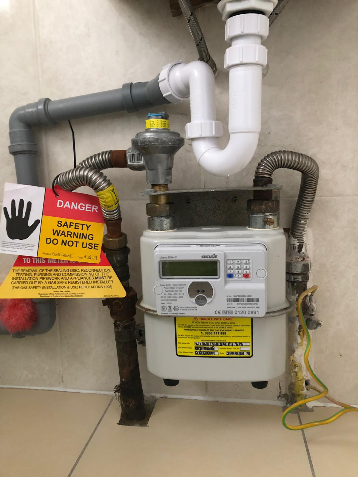

This came to my attention when later I had a gas leak from the Gas Smart Meter.
So Emergency (Cadent) called who made safe and stated in Notice that “Gas leak from corroded stainless steel anaconda flexible pipe after meter”.
1.
2.
I believe how the Gas SM was originally fitted is Not Compliant to laws and regulations.
Who is right - me or the Utility company?
If I am, I need your help in how to say to them what laws and regulations have been broken by them fitting the Gas SM as they did.
From what I have found from different forums and as I can not access website gas safe register, when a Gas meter is EXCHANGED - not Temporarily Removed and Refitted or Repositioned or Relocated - if two anacondas exist, then the Outlet one has to be replaced by a Fixed pipe.
