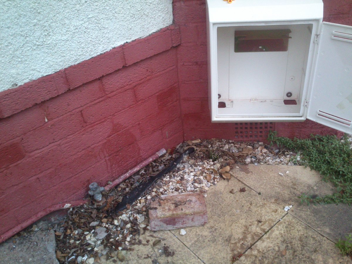

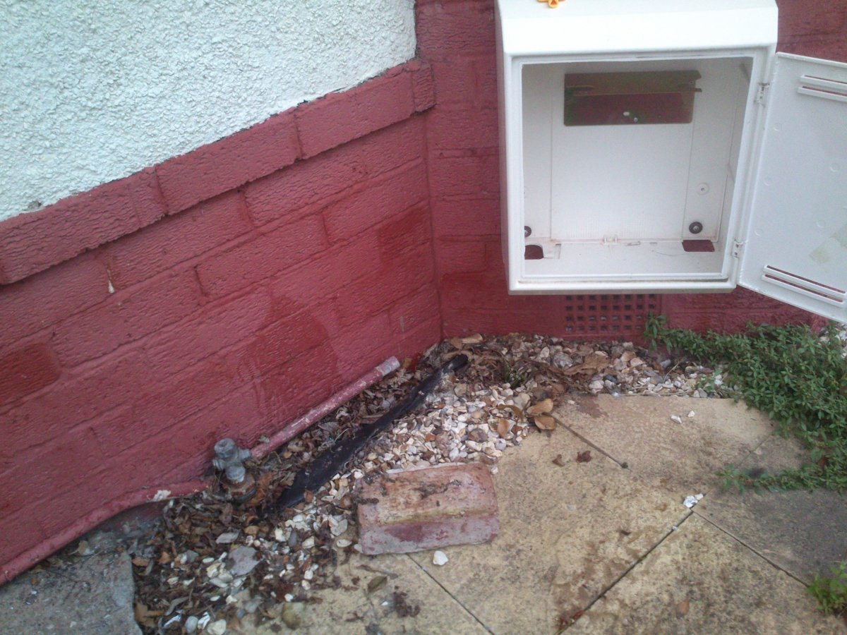

Background:
I have a 1920's terraced house that has had gas (to a single gas fire) at some time in the past, but the previous owner has had the appliance & meter removed. Some of the gas pipework is capped and still in place.
I'm installing central heating so have done a DIY install of radiators and copper pipe for them. I'm going to get a gas-safe engineer to install a combi for me. Before I do that I need a gas supply so have had the ECV on the outside wall tested and it is connected to the gas main. I've also put a standard gas meter box on the outside wall.
Attached photo shows front wall of house with ECV. Red pipe is the old capped gas pipe that used to go to the appliance inside.
Problem:
On the phone, British Gas say they will only install a meter to an existing box with all pipework ready for the installation. Wales & West Utilities have quoted me £400 to put a 1 metre length of pipe on the end of the ECV. This seems high, is this my only option or can I reduce this cost somehow?
Many thanks,
Ralph
They are right, and I think what they meant is they have to dig down and extend main gas pipe to new location ( where the meter box is ) and fit an ECV in there.
There is no other way, I'm afraid.
Daniel.

I suspect the OP might find an RGI who would extend the supply from the existing ECV into the new wall box.
Getting BG to connect to it might be a little more difficult and a bottle or two to the meter fitter on the day might be needed.
Sure, Tony. The meter fitter is going to risk a failed audit and a major *******ing for a bottle of Lambrini.
That ECV looks like its fitted to a reducing bush in the end of a steel pipe. The £400 could include insertion of a new plastic service through the steel, and connection to the main, if they're unwilling to put the steel service back into use, (assuming it is still live), in which case £400 could be quite cheap!

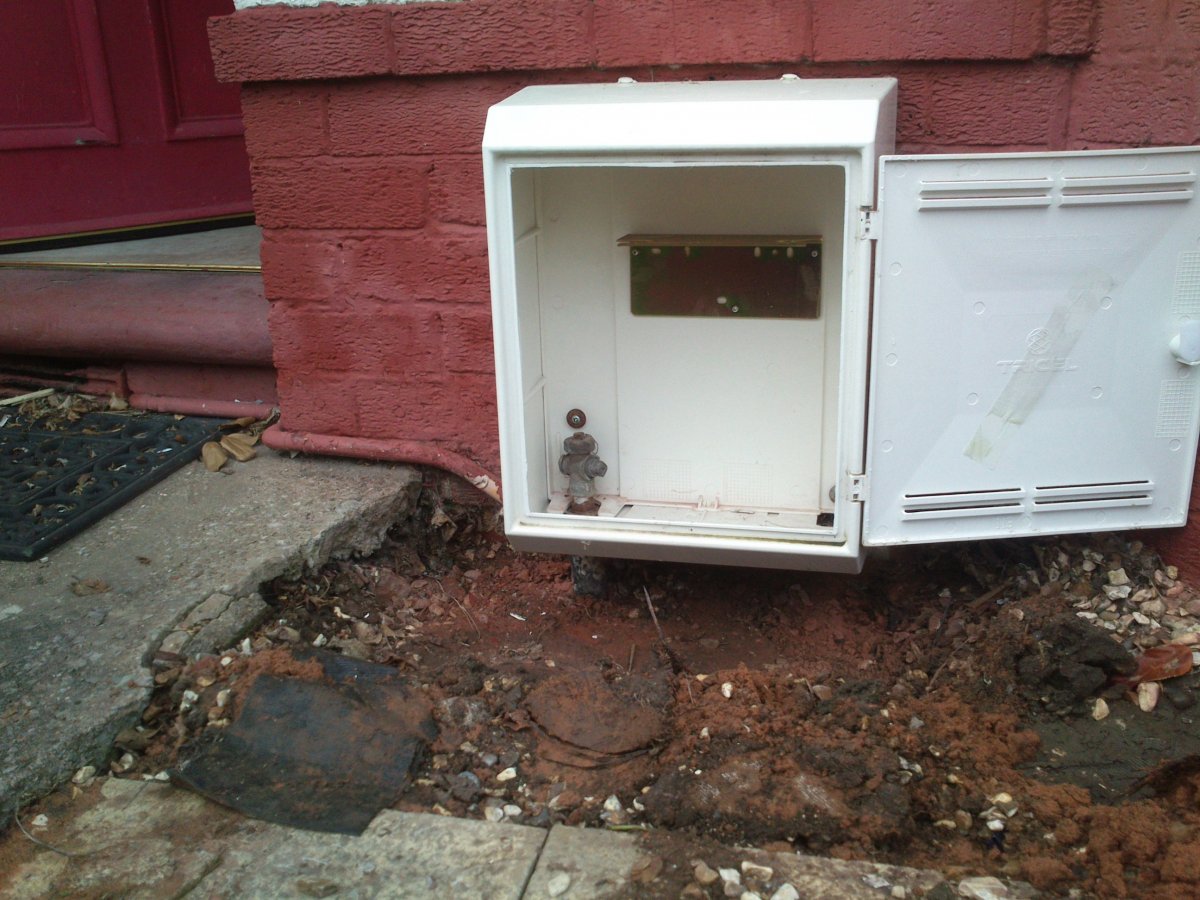

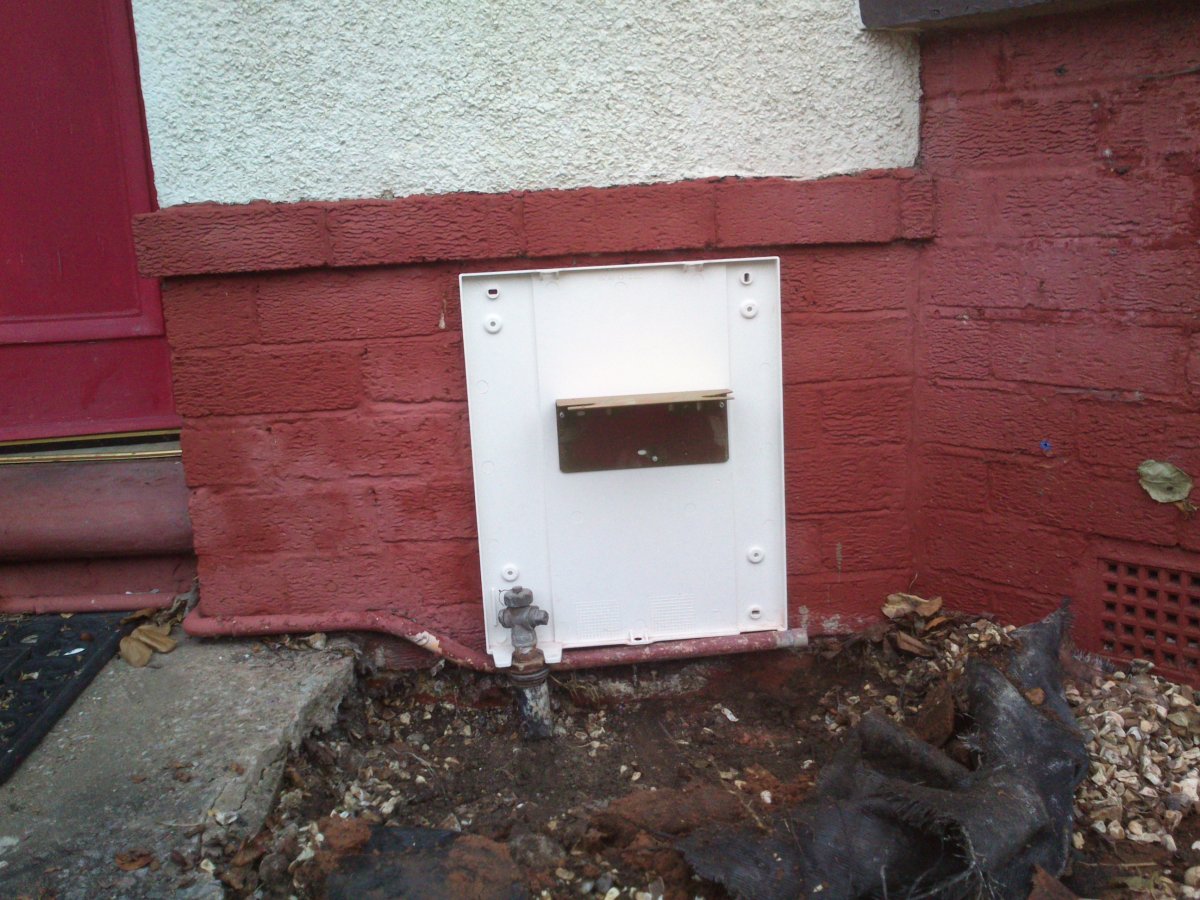

OK, I've gone with FiremanT's suggestion of putting the white box on the ground although I haven't had time to do any masonry. For the moment I've lowered the ground level by about 9" and reassembled the meter box so that the ECV is sticking up into it. If BG are happy with that and will fit a meter into that box then I reckon I've saved myself £400 :-)
(Note that the ground slopes away from the front of the house slightly, and on the other side of that wall is my under-floor crawl space that is about a meter deep so I highly doubt that water will collect in the bit I've dug out, but I'll keep an eye on it)
Anyone see any major problems before I ring BG to put a meter in it?
your first position was to close to the air brick vent anyway, tell anybody who asks that all you have done is changed the box as the old one was damaged. Any issues with existing supply should get reported and sorted for no charge.
