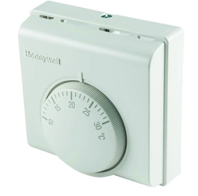

I have got basic controls not specific to vaillant
The timer is "honeywell central heating timer st6400c1003" like below image
The thermostat is "Honeywell manual thermostat" like below image:
It has a 3 port valve from Corgi
Grundfos pump set at highest pump settings
All the radiators have drop pipes as it's a bunglow so red pressure cylinder, pump, pipe work etc is all in the loft and pipes are dropped from the ceiling to the rooms where radiators are.
