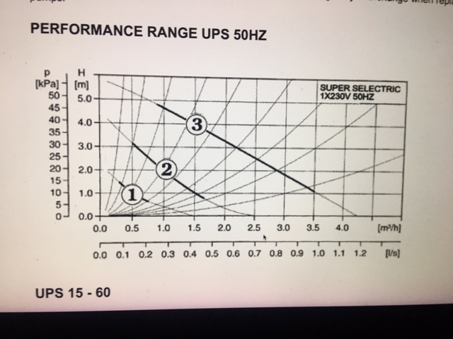

The installation instruction state :
Available pump head at 20 °C system temperature rise 2.0
It's a Bosch Type UPS 15-60 HU1 3 speed pump
7 rads + towel rail , mid size 3 bed terraced house
I wouldn't even know where to start re curves, heads etc

Attached is my pump curve, looking at it, I'm thinking best to be on speed 3?
I actually rebalanced last night
EDIT: At the rads it was 60c in 50 out on pump speed 2, so it will be as I initially stated .902 LPM (so maybe just on the limit of the head with all trv's open ?)
Will have to rebalance again though if using speed 3? :(
Looking at that pump curve again then speed3 will result in a head of ~ 4.7M which would more than likely cause noisy TRV operation when they throttle down so if you all your rads are heating up, leave as is.

When you say speed3 (using a head of approx 4.7M) is that with the flow rate (ie my balance) of .902 LPM? The reason I ask is so that it enables me to understand (and read) the curve.
Also, before when you said I would (probably) need about 3 to 3.5M pump head, is that a rough working off my total rad(s) output?
Again, sorry if this is basic stuff to you.
7 rads + a towel rad, say 8 rads if you have throttled the towel rad as well, 8x0.902 = 7.22LPM = 7.22/16.66 = 0.43m3/hr. say 0.5m3/hr, come vertically up on chart = 3.0m.at speed1 & 5m at speed2, try speed3 and keelp throttling one or two of the TRVS, if no noise then let pump on speed3 for a good while to let the TRVs do their own thing re throttling etc and noise then re balance perhaps?
Those pump curves are for a Grundfos Selectric, they gave up making them about 15 years ago I think, is your pump that old? Anyway seems you require speed 3 one way or the other.
