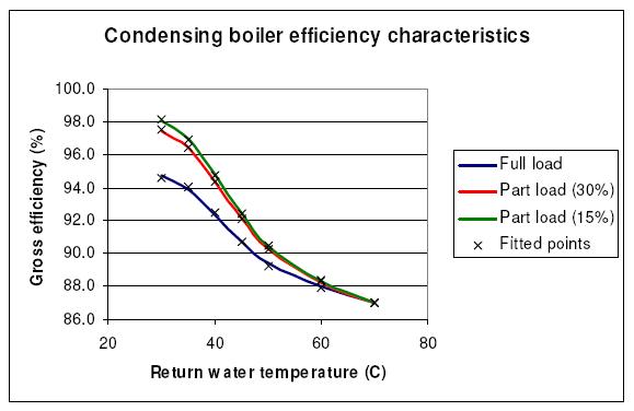

Just to return this disquisition back towards the OP’s question, below is a graph of condensing gas boiler efficiency versus return flow temp to give some idea of what might be expected. I took this from a paper on building temperature control and it gave no information as to exactly what boiler this was measured on, but it’s the only one I have come across.
Forgive me for doing this Mikely but your graph reminded me of a web page with a similar graph and I thought it might be worthy of mention, and a link to the the page as it covers some of the detail behind it without going overboard.
(I don't intend this being 'my graph's better than your graph' competition so apologies if it comes across that way! ;))
The page also mentions the often-unmentioned fact that whilst condensing generally occurs (or at least starts) below 57C for gas, it is somewhat lower for LPG and oil at 53C and 50C respectively.
