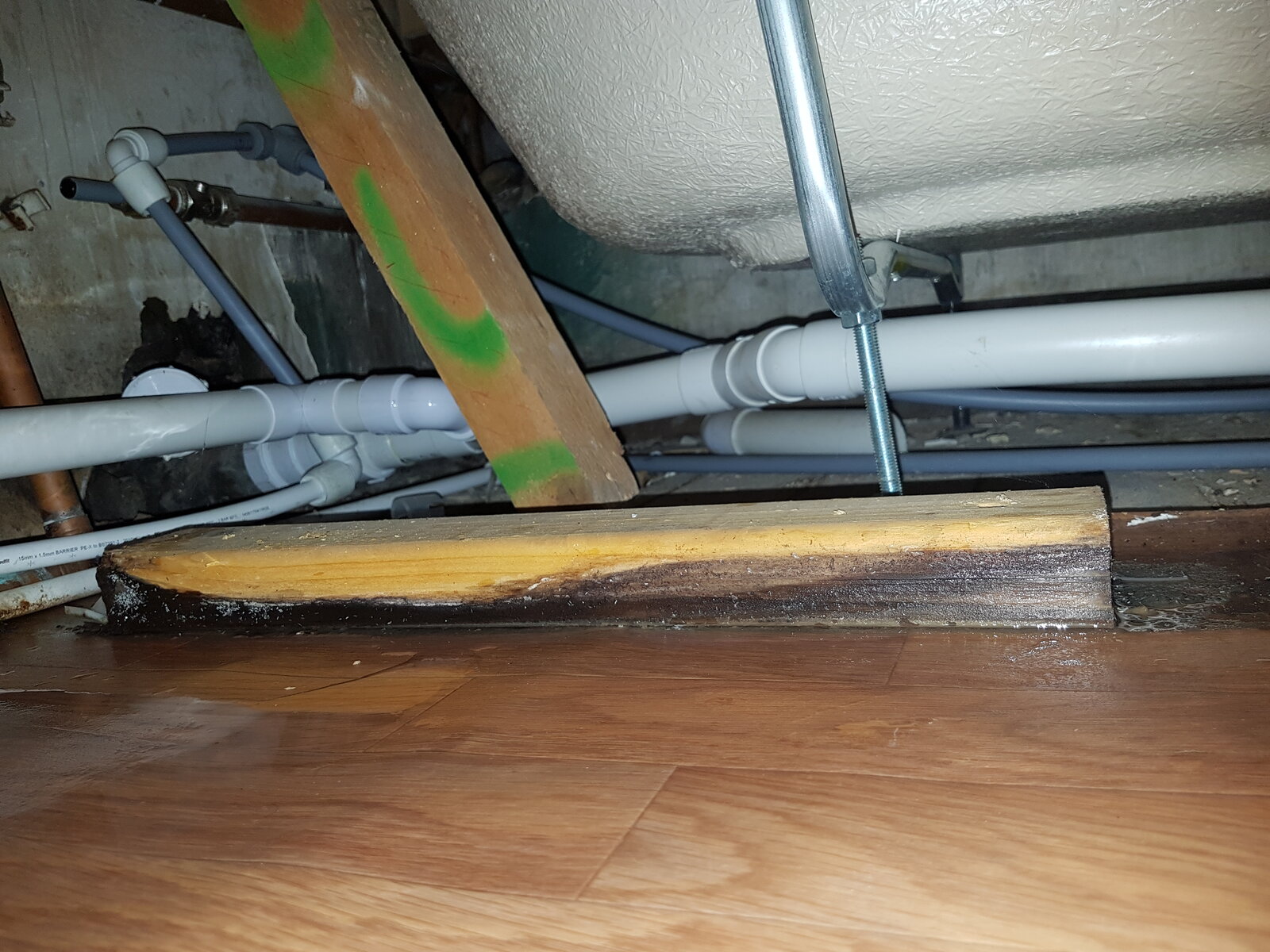

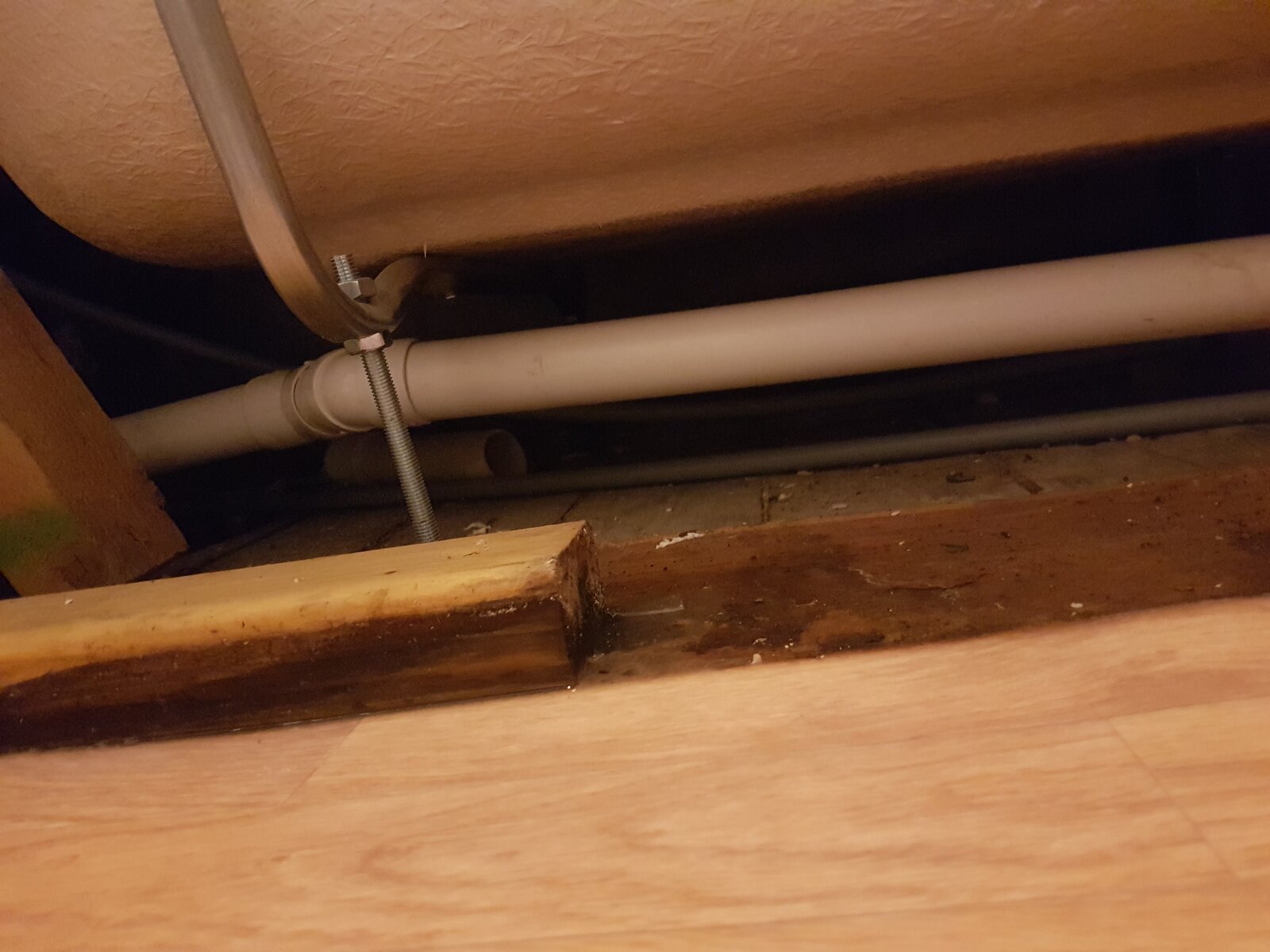

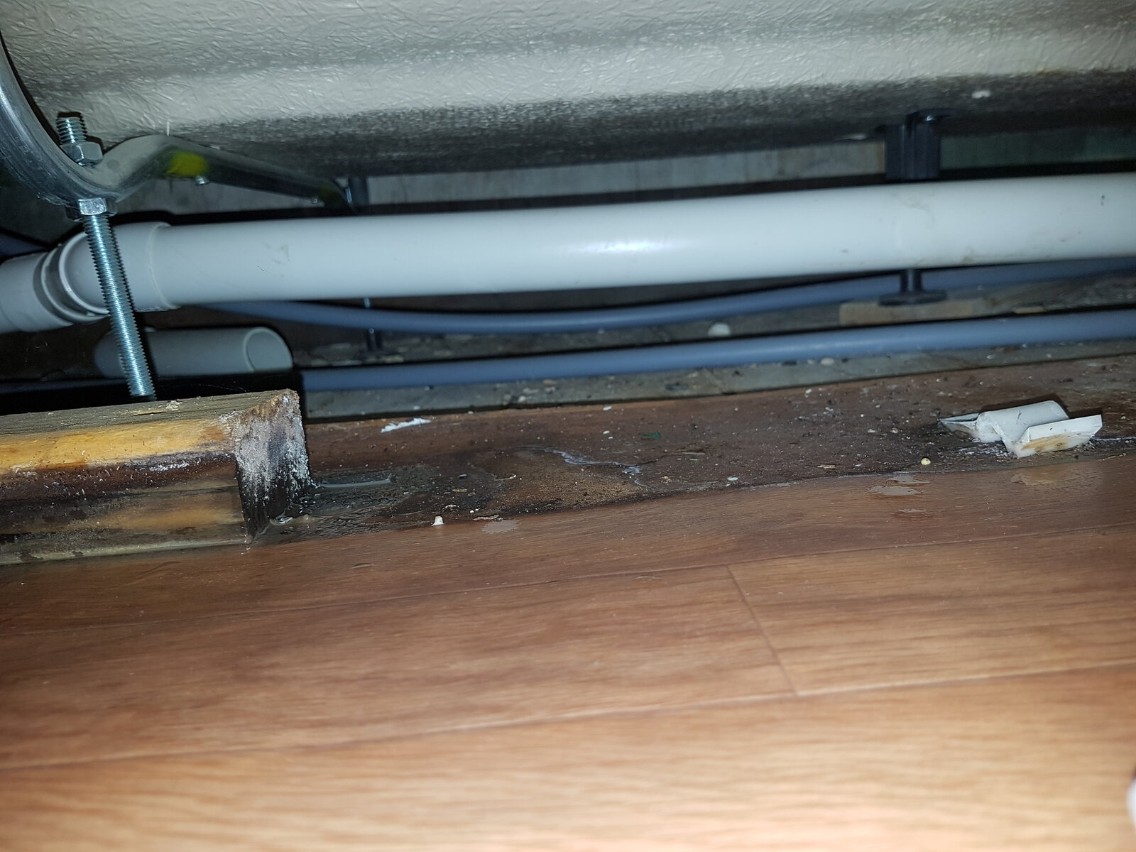

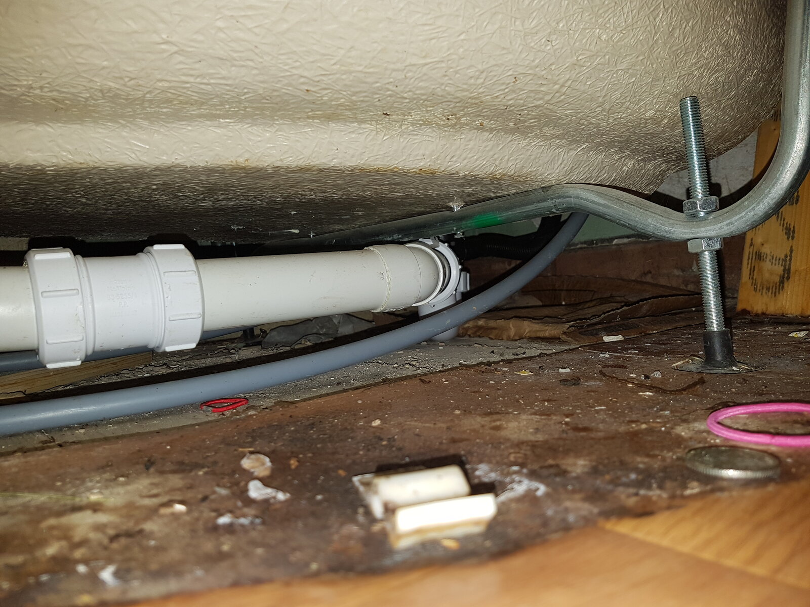

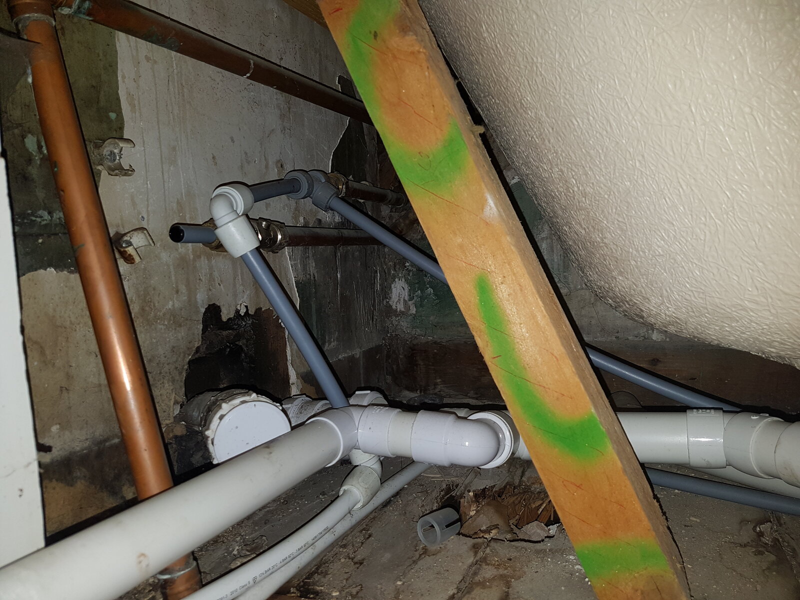

Heres some pics, just taken under my bath, hope these help?

It looks like he's cut/removed a bit of floorboard for the trap. ?
Looks hard to get to.
You might be able to squirt foam into there but getting the trap out would be tricky.
