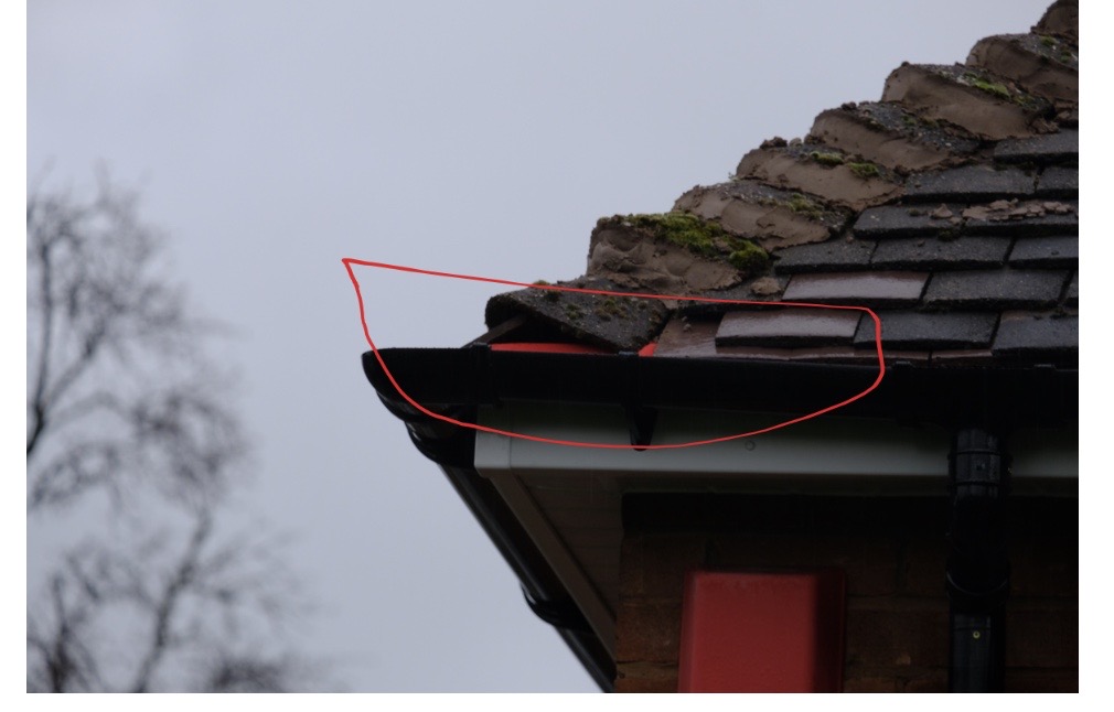

We have just replace roofline for gutter, fascia and soffit, but after it, we can see the membrane under the tile, is it normal?
Evalice,
Your first pic shows a shambles of incorrectly laid and missing plain tiles.
The hip tiles and mortar are also rubbish.
It all looks amateurish and needs a roofer to go up and sort it out.

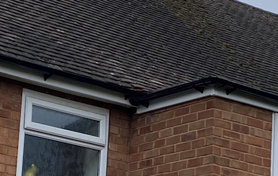

The second pic probably also needs attention from a roofer.
