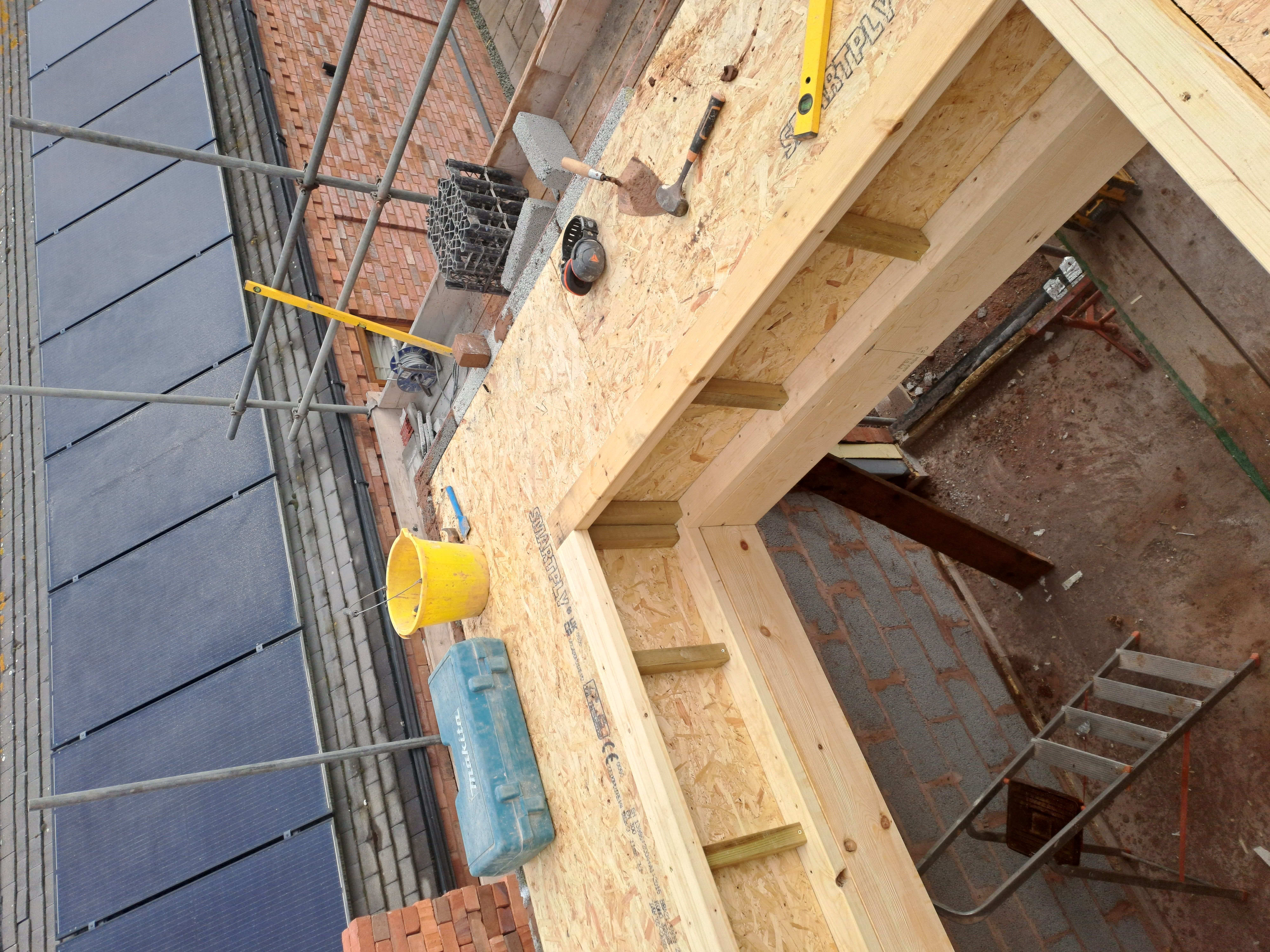

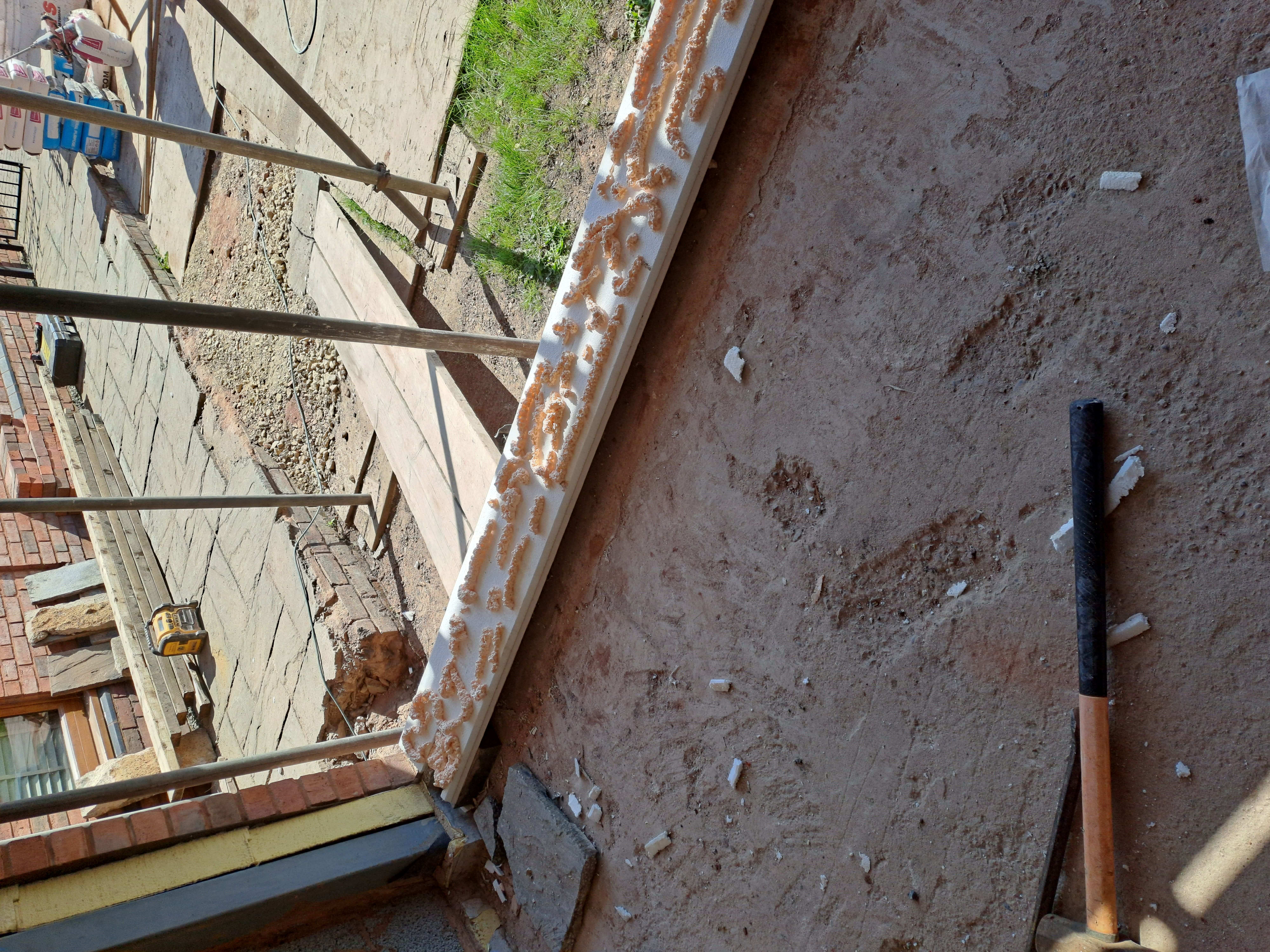

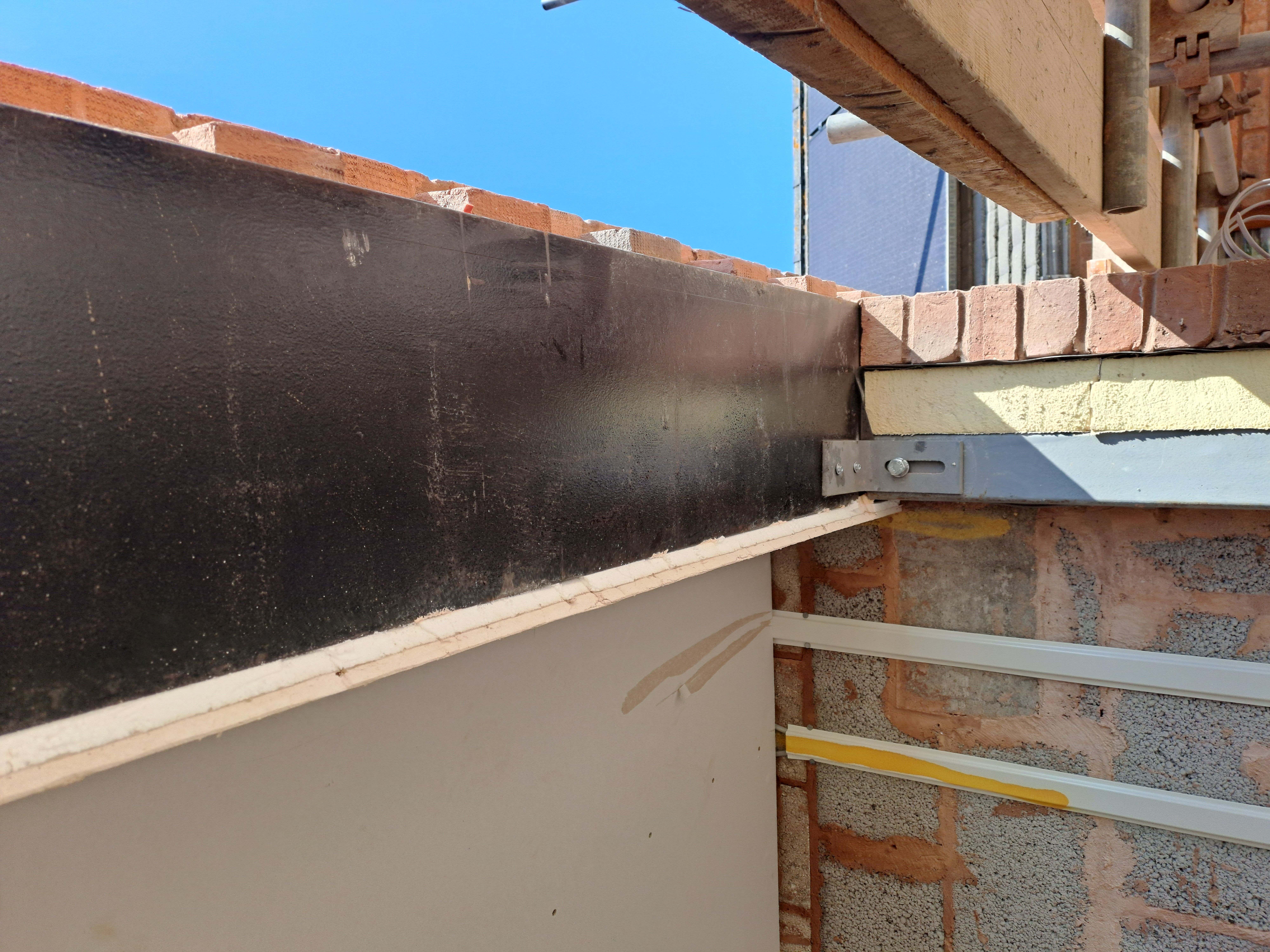

Is it okay to fill the cavity between 2 RSJ (running parallel) with Expanding foam
It probably shouldn't be any sort of RSJ, but should be a cavity lintel. This would minimise the thermal bridging and look right.

it a solid wall without cavity.

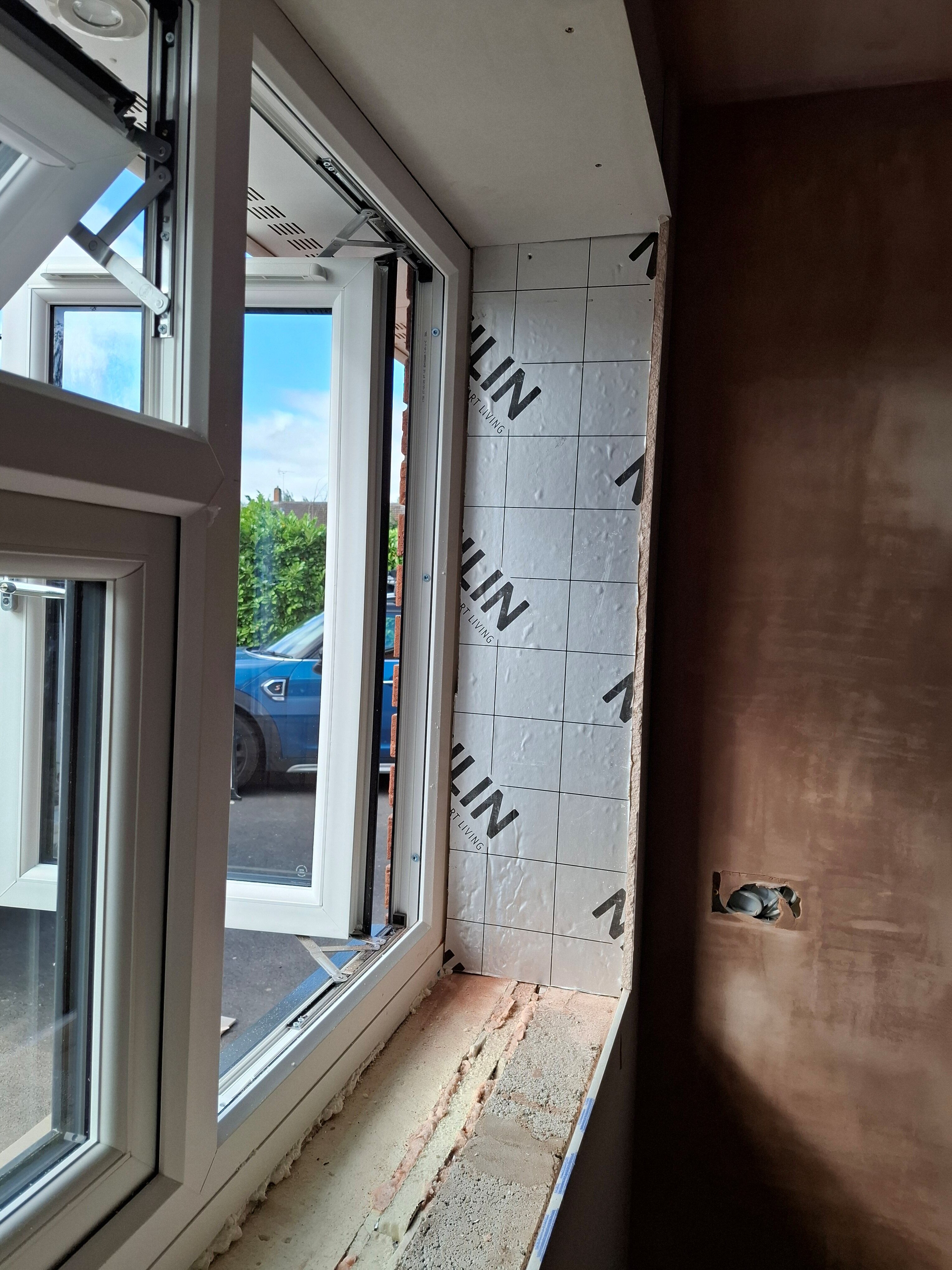

Cold bridging can be minimised using thermaline plasterboard foam fixed onto the reveals....
On the inside the I beam is covered with a insulated plasterboard. This external wall is the old style double brick wall without a cavity. It's interesting to see that in those days they used to put a brick across both layers as a tie and now we use butterfly wires.
