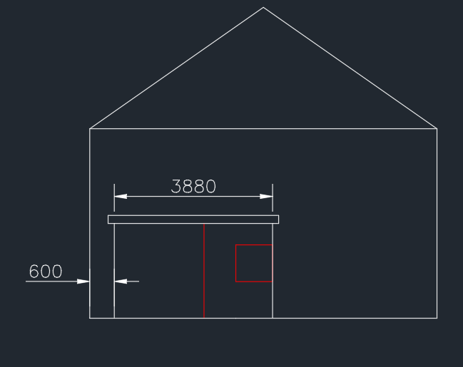

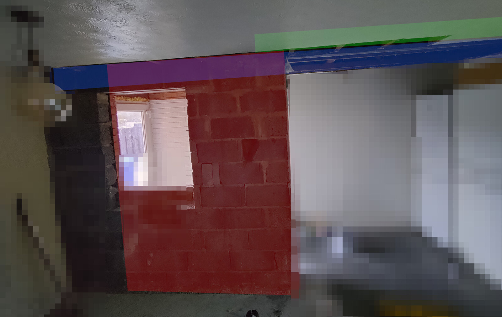

I'm having a new RSJ put in (blue) to remove a wall (red). To reduce the work the beam is going beneath a steel lintel (green) already in place.
The best approach seems to be up for deliberation so I thought I'd see what other opinions and ideas are out there...
1. jack the new RSJ against the existing beam. Then jack the padstones up and fill underneath with mortar. Given the padstones take the weight this seems the most risky, it assumes the mortar doesn't shrink when set etc.
2. try and pack the gap using layers of thin steel, say 0.5mm. Might still have movement when the props are removed.
3. weld the sides of the RSJ/lintel together, possibly along with (2).
4. inject the gap, possibly some sort of epoxy? This would ensure the gap is filled. Please, don't suggest expanding foam. :)
IMO (4) is the best option. I'll be asking the structural engineer later on as well
Cheers!

3:1 stiff mortar on top of beam, jack it into place, steel or slate packers between beam and padstone.
Don't jack up the padstone, mortar it in, like a brick.
But if you've got an engineer, ask him.
See I wouldn't have put mortar in-between two steels as it has nothing to set to.
The steel or slate packers between the beam and padstone seem a worse place then putting the same across the length of the RSJ/lintel? As those padstones are going to take all the pressure? Can pack them as close as you can but there'll still be some crushing when the props are removed?

Edit: I did some googling as I thought he was referring to the front of the house. If this were external and a large window was going in where there were bricks that side of the house would be lighter so I could see how to collapse it would require less wind. But the area being widened is internal so I don't see how it makes any difference to the top half. Sideways collapse seems unchanged to my eyes, but I don't know, basically.

can you post a plan of the house? Eg from Rightmove, with address etc removed.
When considering wind load, the SE should consider the ground floor as a whole, rather than an isolated part.

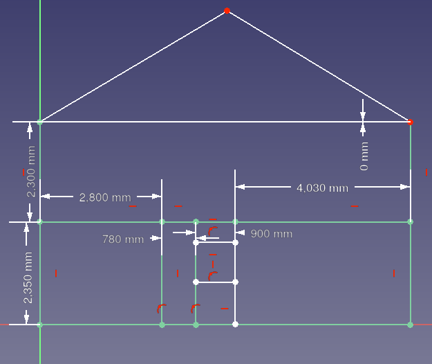

I don't have a floor-plan per say but can offer up everything the SE requested and a CAD I did. The CAD is internal measurements, excludes masonry width on the left side. Masonry is 270mm brick and concrete block (70mm cavity). All walls cavity based.
There's already a lintel across the 2.8M (green in previous picture), weight unknown (but looks pretty wimpy).
The new RSJ is to go underneath (blue in previous picture) across the existing 2.8M gap, the 0.78M wall and the 0.9M window opening. Wall and window masonry will then be removed (red in previous picture).
The new RSJ will go underneath. This means it'll be seen in the ceiling but is a compromise to reduce the installation work.
Joists on the 1st floor (bedroom) are 2.9M in length. They sit in the current lintel and on the wall etc.
The roof is truss so no roof loading on the gabel ends.

The wall is the gabel end, and about 30cm past the window is a door and then the rest is outside (4.03M - ~30cm on the diagram).
On the ground floor, the garage was build 1M to the side. The garage roof (truss again so no load) was then extended across. At the front of the house the wall simple keeps going joining to it. It's odd, I know, a door was originally at the 0.78M point creating an area under canopy. I suspect being built mid 80's this was the place to have a smoke while not getting rained on! The door is now at the 0.9M point (can see it in the previous picture).
The current lintel sits on 100mm on the side and 210mm on the inner side. These look like concrete blocks not padstones, they've used the same elsewhere in the wall. The naughty 80's!

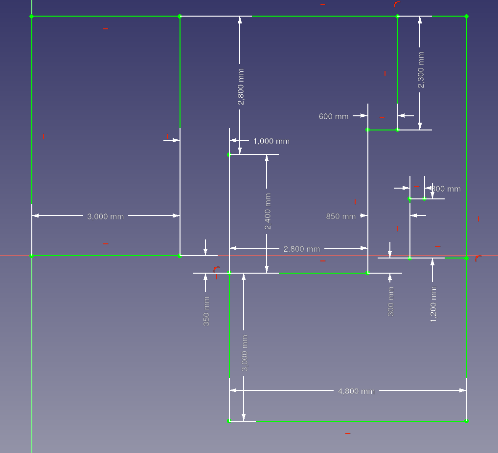

300mm missing here and there for cavity walls but hopefully good enough to show structural walls. Doorways not included. For bearing the original lintel is going across the 2.4M section

The 600mm wall is a no go, I don't have a raft foundation and I'm not prepared to dig a foundation down in the kitchen it's a step too far.
What I asked the SE is whether a 100 x 660 x 220 padstone could be put length ways, so the RSJ is on the 100 x 660 side and the load distributes on the inner wall. The RSJ on 100mm is minimum but regs permit it. This is how it's done now with the existing lintel, except it's resting on a standard concrete brick (either the original builders didn't give a **** or maybe the load didn't warrant a padstone).
I suppose it needs calcs now, but not if the 600mm wall is an insistence without them, no point.
