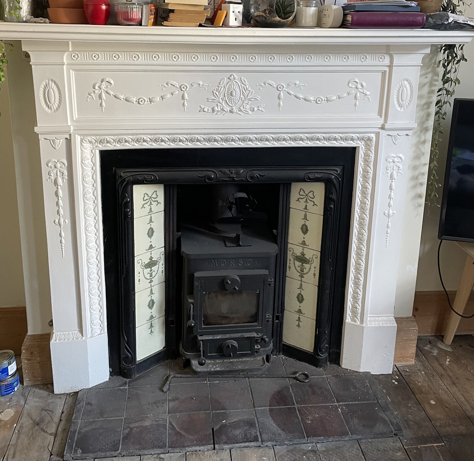

Is it possible to alter this fireplace to have an open fire?
6 Jun 2011
170
4
London
The house we're currently renovating has this fireplace and log burner
I know its not fashionable, but we'd really like an open fire and not a log burner. But we don't want to reinstate the existing fire insert and have a small victorian fireplace. What we want is something like this - a properly open roaring fire:
So, is it simply a case of removing the insert, putting the surround and mantle back (and a new hearth too), making sure the chimney/brickwork etc is up to scratch, then using a freestanding grate in the opening? Or is it more complicated than that? Been googling like crazy but just can't seem to find anything that answers the question.
(and before someone tells me that an open fire isn't very efficient, we do know that. It won't be used very often, probably only at Christmas and to burn the odd bit of confidential paperwork. We have a well insulated centrally heated home that's already really warm, so we're finding the log burner is too hot!)

It all depends what's behind the insert, what size the builders opening is and if you want the exposed brick, what condition it is in.
In my house, we took a massive (and ruined) art deco fireplace out. After taking out the clay back and sand (they packed the gap between wall and insert with it), we found a massive 2x1foot opening, in good condition.
It was too big! Ended up fitting an iron insert much like yours...
I think you need to commit to find out and start smashing things. If the opening is too small, can be enlarged with a lintel.
If the brick work is poor (e.g., never designed to be on show) you can line it.
All depends on how much you want to spend
Really it depends on the chimney. It would need to be in good condition and provide sufficient updraft to allow for an open fire. Though log burners are much more practical, safer, more efficient etc so you're really going for a downgrade

Bare in mind when you take the stove out your house will be less insulated than it currently is, you lose heat up an open fire even when it's not lit.
If you don't want to lose the heat, you could remove the stove and have it as an aesthetic fireplace, with a chimney balloon or similar.
Or could put in a different stove? I'm not a fan of those morso stoves
There is a bit of science involved in chimneys, and if the flue is too small for the fireplace opening and the throat and gather not properly formed you might get smoke coming back into the room.
I would say it's a bit more complicated unfortunately. You'd need to remove the existing Fireplace, then be prepared for a whole lot of mess behind it. Once that is all out and you have the Builders opening left, then you could see what will work with the space you have, but as said previously it is a bit more scientific that just lighting a fire, you would need to ensure the Chimney draws correctly to remove the smoke etc out the room, or you'll soon poison yourselves.
Work would also need to be signed off by a HETAS qualified Installer, for insurance purposes.

I re-instated an open fire in our kitchen -- largely for the same reason you want one (aesthetics). The dampener can be closed when not in use so very little air is taken up the chimney when not in use, and although its vastly less efficient than the stove, it still gives out a great ambient heat which is all we're after with it. I'm presuming your house had an open fire originally, so if you can take the fireplace back to its original opening (the surround looks original) then that is was was designed and built for your property. I don't think the science behind the opening size/location would be a concern in your case.
It must be said though, I am replacing it with another stove next year so that we can have a more efficient and controlled burn (and so I can stick a kettle on the top). If you do remove the stove and the liner, you are gambling that the flue is in good condition and that the mid-feathers (bricks between each flue) are sound. If they're not and you have removed the liner, you will get smoke drawn into other flues and into the rooms not serviced by a stove or fire. I would honestly just stick with the burner.

It could be if he want to do what is shown in the photo. The flue needs to be at least 15% of the fireplace opening size. A common problem with doing what is shown is that not all the smoke he's up the flue.

Yes the flue diameter needs to be of adequate size, plus -- the amount of air entering the room is also a huge factor. Without knowing the detail we can only speculate I suppose.
I'm just speculating and reckoning that it may not be an issue, given the fact a working fireplace looks to have stood there from new.
@cwhaley I think you're right, the fireplace looks original. The house has only had 2 owners and has been amazingly well looked after and everything is in remarkably good condition for a house 110 years old. I can see the brickwork behind the stove and its in very good condition indeed. The opening isn't particularly large however, so we certainly wouldn't get the sort of large fire in my illustration, it'd be a lot smaller.
