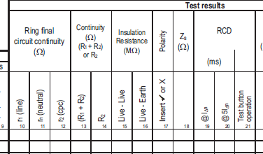

There are two ways to test the earth, one uses a low ohm meter and is done dead, the meter must use at least 200 mA for the test, but you need to know the earth loop impedance at the consumer unit to work it out.
The other uses a loop impedance meter, and is done live.
The impedance (called resistance with DC) has to be low enough to work the overload within a set time, a B type MCB will trip on the magnetic part of the trip in the time allowed if the current exceeds 5 times rated current plus 5% so with a 6 amp MCB that is 230/30x95% = 7.28Ω the problem is these meters are expensive, and any other method will not give you the reading to filling in the test certificate.
It is unlikely many DIY people bother with the Zs reading or the paperwork, they just trust to the lord, in real terms if doing DIY no option.
