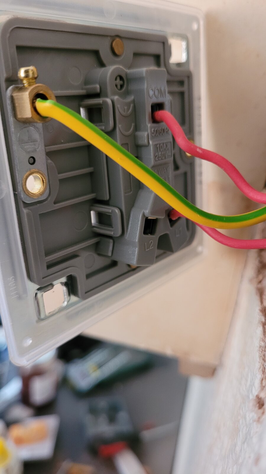

I did not run an earth wire from the faceplate earth to the backbox. My reasoning behind this was that one of the screws that goes through the faceplate, makes contact with the earth and secures to a fixed part of the backbox. I got a 1.5mm2 earth wire which is quite thick - my thinking was, if i try and squeeze two wires into the faceplate earth terminal it could compromise the holding power of the terminal and if the earth ended up detaching.. not good. While i know it is best practice to connect them, am i right that it's still safe?

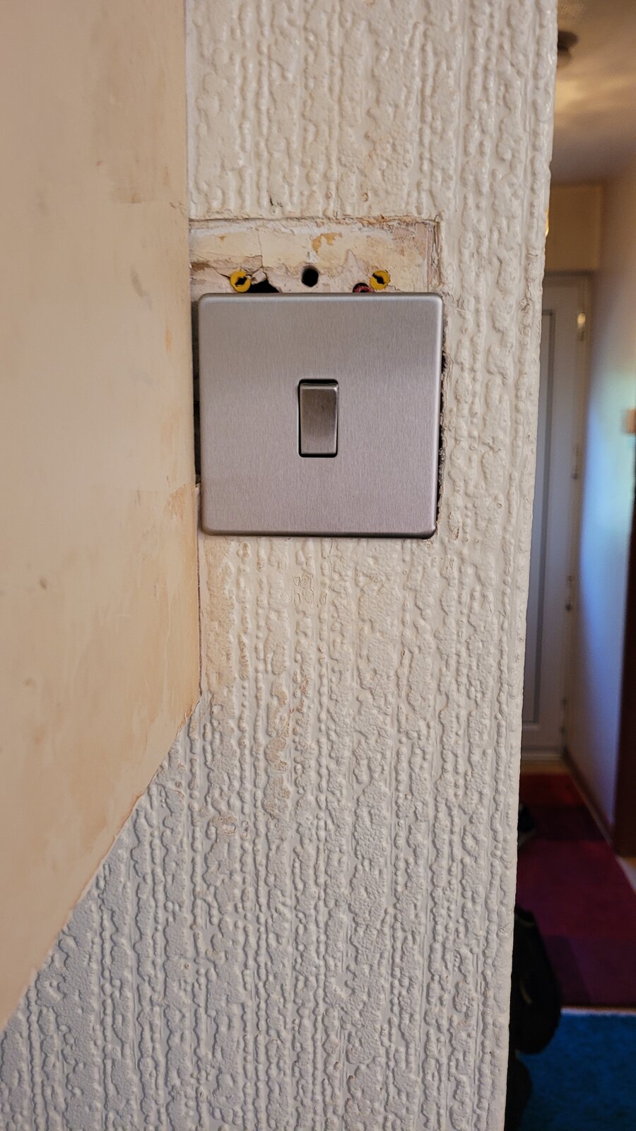

I'm not sure how flat i got the backbox. I tried my best and everything seemed to screw together without issue. Should i be concerned at all?
The faceplate cover moves... i am wondering if it's because i left some wallpaper under one end and it's made it uneven. See video:

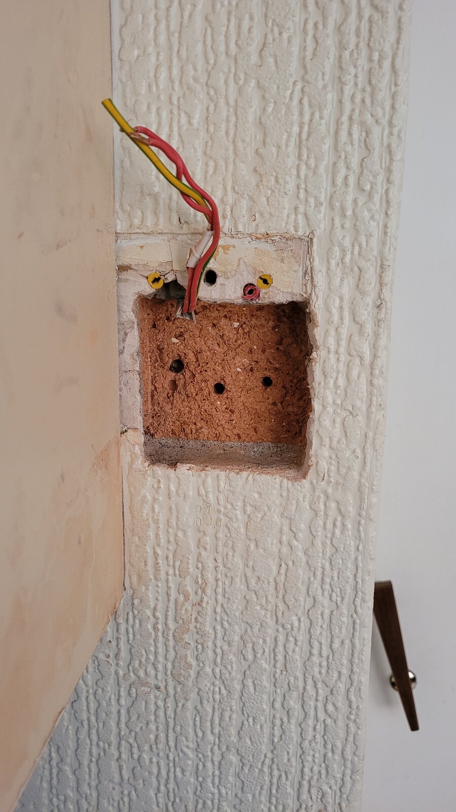

Some Pics:
Lovely crumbly brick made the job easier. Ended up using a screwdriver and a hammer.

Finished Product. Yes i need to tidy up the wall around it:
What you reckon guys.. Successful first job, or accident waiting to happen?

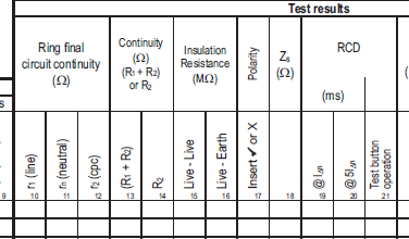

There are two ways to test the earth, one uses a low ohm meter and is done dead, the meter must use at least 200 mA for the test, but you need to know the earth loop impedance at the consumer unit to work it out.
The other uses a loop impedance meter, and is done live.
The impedance (called resistance with DC) has to be low enough to work the overload within a set time, a B type MCB will trip on the magnetic part of the trip in the time allowed if the current exceeds 5 times rated current plus 5% so with a 6 amp MCB that is 230/30x95% = 7.28Ω the problem is these meters are expensive, and any other method will not give you the reading to filling in the test certificate.
View attachment 275350 It is unlikely many DIY people bother with the Zs reading or the paperwork, they just trust to the lord, in real terms if doing DIY no option.

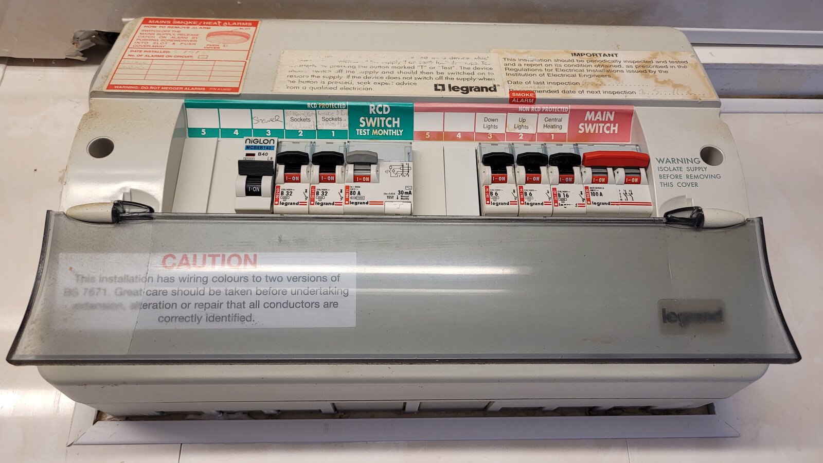

Are you sure only half of the consumer unit is RCD protected, can you post a picture of it and we may be able to confirm! :)
You currently have a surface mounted switch and back box.

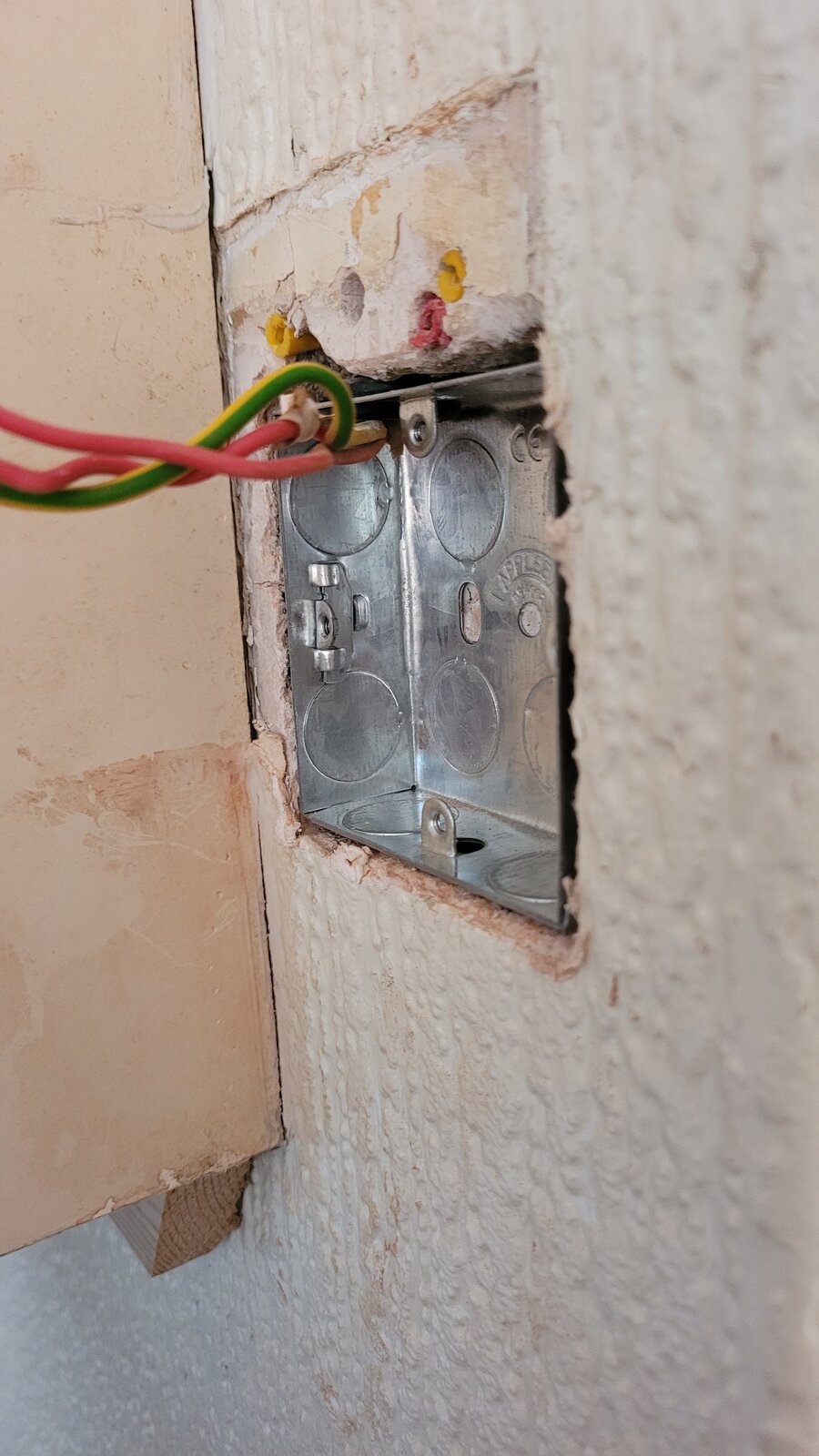

Personally, I would go for a 25mm back box (if you are happy to drill a bit further into the wall). It will give you more space to play with to get the wires to fold back into the box neatly.
Where you knock out a hole for the wire to enter the back box, you will need to use a rubber grommet to protect the cable.

That's our CU and then we have the earthing thing and the meter. Do you know, is it possible / easy for an electrician to switch the light switch to the RCD side?

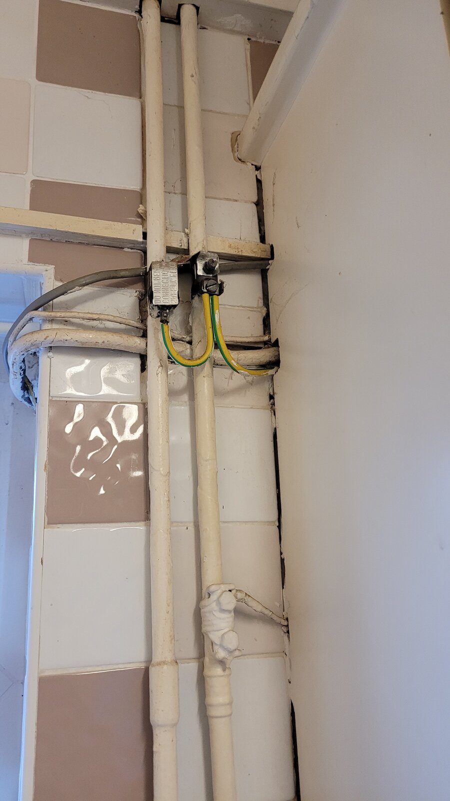

Forgive my ignorance but where about is the main earth terminal of the supply and would it be okay to run a 1.5mm2 earth wire from there to the multimeter probe? Mine doesn't beep for some reason so do i just look for a value less than 1?
I did go for the 25mm back box in the end, wires weren't too difficult to get in although it worries me about the pressure on them and them coming loose.
Nothing can be added to the RCD side in that consumer unit.
It may be possible to obtain an RCBO to replace the MCB for the lighting circuit, but given it's age and the small number of circuits any money spent would be far better put towards replacing the whole consumer unit.
The label suggests it's more than a decade overdue for an inspection.
Others may disagree, but I have found adding a couple of bends to the wire beforehand (like a concertina), allows the switch to sit back neatly with out to much 'pressure' on the terminals.
As ericmark has said, without a full electricians toolkit, as 'amateurs', we are limited in our approach to testing.
There have been plenty of discussions on here about the pitfalls of using a 'voltage pen' - but you have a multimeter, that's all you need for now :)
Connecting one probe of your multimeter to any of those earth points (...and the other probe to your switch's earth), or as I said earlier, the earth of a nearby socket - should give an indication of earth continuity. And again, you can always take a resistance measurement with your meter to confirm.
Yes, still safe! As a belt and braces measure, some will include the wire to the back box - it's nice to have, but not strictly necessary. You may find a few discussions on this matter if you do a search of this forum! :)
In the case of a socket on a ring, with a spur, there can be three wires in a terminal (plus one more if you want an earth fly lead to the back box!).
This isnt something to overly worry about :)
Nope, as long as the edges of the box are below the surface and the box is relatively level, it should be good!
All in all, a good start, well done!
Are you saying that just because it is an 80A RCD (given that there appear to be a couple of 'spare' ways available on the 'RCD side'), or whasst/why?
80A could be one of the reasons, as the MCBs total more than 80A. In this example the supplier fuse appears to be 60A so that may not be a problem if the fuseholder label is correct. However if it is 60A, then that 40A shower really should not have been installed.
Others are that it's a type AC RCD, which can't be used for anything other than resistive loads
moving the lighting there will result in most of the installation on a single RCD, see division of installation
and the 9mA leakage current per RCD is likely to be exceeded, and may already be.
For any of those, shoving the lighting in with the rest is making a mediocre installation worse.
If RCD protection is wanted for the lighting, it's new consumer unit time.
Or just leave as is, replacing a light switch does not require that anything else for the circuit is changed.
