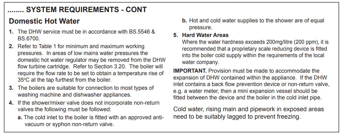

Frame 6 of the installation manual...
IMPORTANT. Provision must be made to accommodate the expansion of DHW contained within the appliance. If the DHWinlet contains a back flow prevention device or non-return valve,e.g. a water meter, then a mini expansion vessel should befitted between the device and the boiler in the cold inlet pipe
Thanks dilalio
So it says to fit one to the DHW inlet 'if it contains a back flow prevention device or non return valve...' . From what I've searched on, a pressure reducing valve is neither of these?

But are you on a water meter?
That does, and your stopcock should have backflow prevention too!

It's in the manual and benchmark for us Installers.
