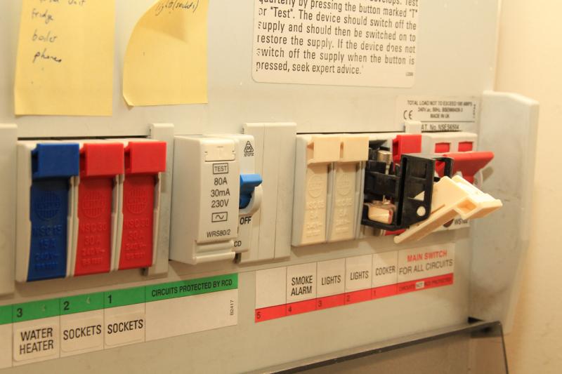

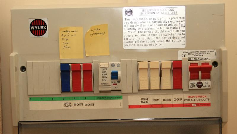

Hi All,
I plugged in my hoover about a week ago and the plug fuse blew. The cable had worn out and the resulting bang left a black mark on the wall beneath the socket.
I was expecting the RCD at the consumer unit to trip but it didn't. Should it have? I tried the test button and it worked fine.
I have attached a photo - I reckon the unit was installed when the house was built c.1997.
Happy New Year.
Those are cartridge fuse holders. Most vacuums are class two and you prob had a direct short from line to neutral so the fuse blew. The RCD picks up imbalances between line and neutral.
Cartridge fuses are a lot better than MCBs for protection, IMHO, although they are a little less convenient.
The RCD shouldn't have tripped, however at 15 years old the installation could probably do with a Periodic Inspection which would also test the correct functionality of the RCD.
