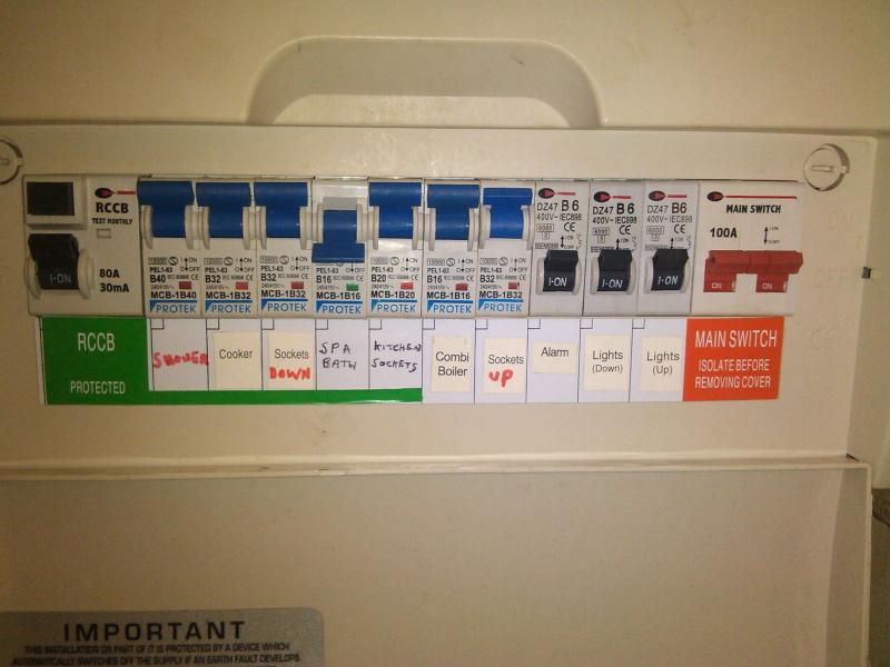

would a picture of my consumer unit help to determine if there is any rcd procection? Just for my own interest. I know when the wife cleaned the grimy kitchen the kitchen electrics kept tripping the mcb and the mains switch (which I may wrongly assume is an rcd) as some water must have got behing the plug sockets.
Even though, in view what you go on to say, the question may now be moot, a picture of the CU (showing any labels, if there are any) would certainly be a good start.

Here's my consumer unit attached.
Seems the kitchen sockets and thus the outside plug are protected by an RCCB.
Does that negate the need for an rcd outside socket or would a belt and braces approach be prudent?
