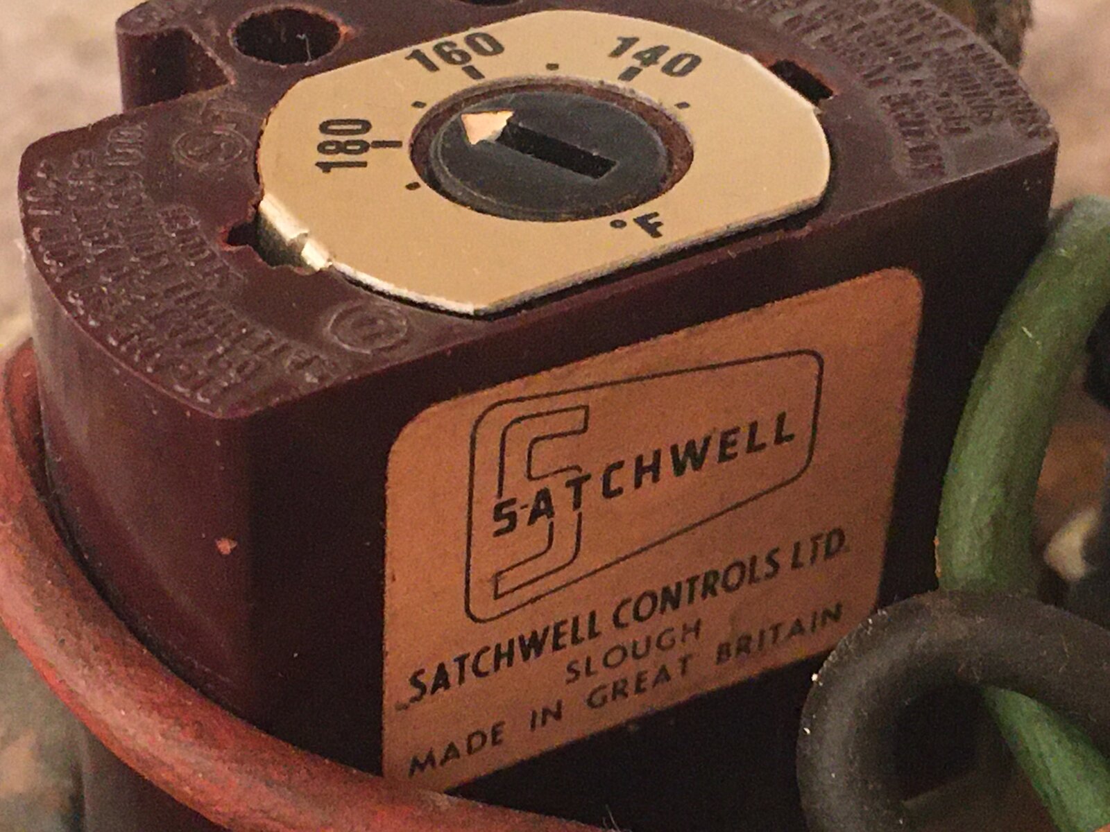

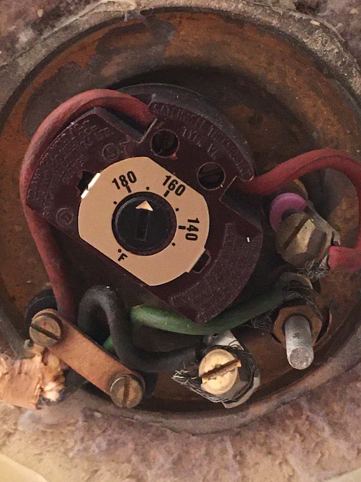

My old (but little used) immersion heater has suddenly stopped working.
Obviously I want to try resetting it, but I can't find the usual pinhole reset.
Satchwell Controller.
Does this controller actually have a reset button?!
Where precisely is it?
I highly doubt on that old thing there’d be a thermal cut out as they were introduced around 2004. You may even need a new element anyway.
Doesnt have one , new element and thermostat time, most elements come with a thermostat, but not all so look before you buy, that is as long as it is getting power when switched on, which I assume you have checked
