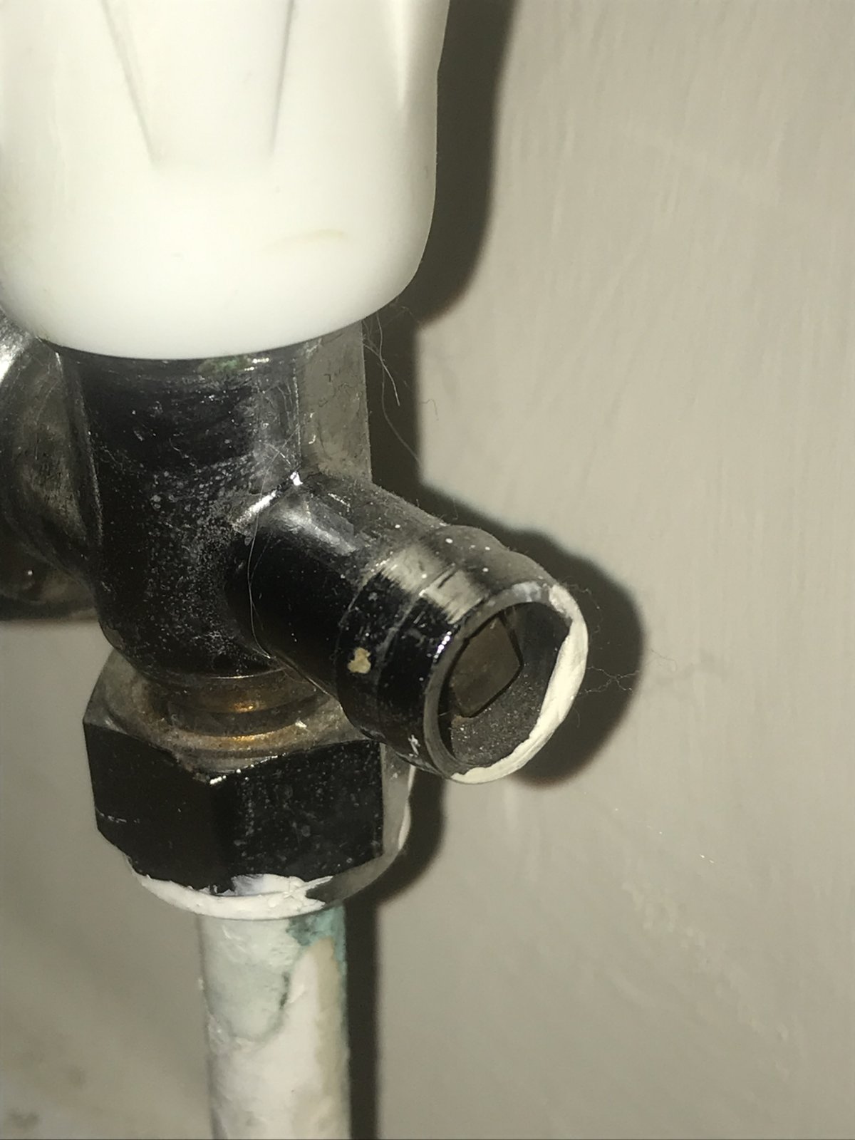

Is this a drain off valve?
13 May 2011
82
Lancashire
Probably a daft question but...
I have two water pipes in a downstairs bathroom sink that have obvious drain valves where the bit tees off that the hose goes on to, but on the radiators there are only these, I’m sure they are, but I can only think I’ll undo them, and water will **** out everywhere until I get the hose on, or am I missing something?

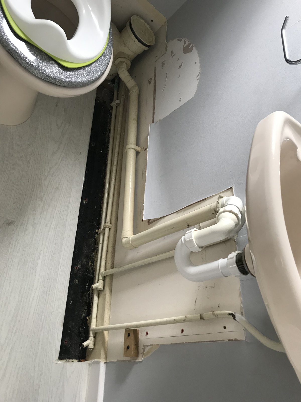

I’m replacing these two 15mm water pipes and I’m assuming all water needs draining from the radiators too, or are the 10mm and 15mm pipes two separate systems? Boiler is a Baxi Duo Tec combi.

you close the valve, open the drain cock (same as bleeding a radiator) except you leave it open until it is drained , attach a hose then open the valve and the rad will drain down, remember to open the air bleed valve at the top of the rad to allow the water to drain down
Thanks Ian, never thought to shut the valve but it makes total sense now you’ve said it.
Is it normal to find drain valves on both the rads and the water pipes?
I’m hoping to replace these two 15mm copper pipes with speed fit, which would in effect get rid of the drain valve, but if it’s needed then I’ll need to think of something else.
Attached a pic of the two pipes in the bathroom being replaced.
It’s being replaced as we are replacing everything in there and are removing the skirting boards the pipes are attached to (i also want isolation valves on them)
