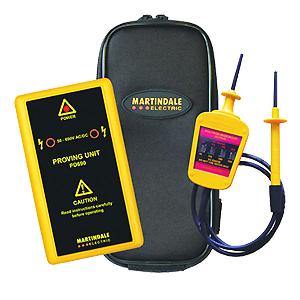

I have a switched and neon fused connection unit on a ring main. When the switch is in the off position and checking the Load live and neutral connections with a voltmeter, both are giving a 240V reading. When the switch is in the on position the live gives 240V and the neutral gives 0V, as expected. Is the FCU faulty?

What sort of voltmeter? Assuming it's one with two leads/probes, where are you measuring these voltages - 'between what and what'?
Kind Regards, John
Sorry, no it's a "Digital Voltage Tester":
As I rather suspected :) You are probably simply being misled by the readings from a device which is inappropriate for this purpose. I obviously can't know for sure, but the chances are the there's nothing wrong with the FCU.

The likely cause is the the FCU is only switching the neutral and not the line.
The FCU needs to be replaced.

The load-side terminals may be isolated/'totally dead', yet it's in the nature of the sort of voltage detector you're using that you might still 'detect voltage'. I obviously cannot say that the switch in your FCU isn't faulty, but what I am saying is that it's far from impossible that you could get the results you've seen even if the FCU were functioning correctly.
In the absence of proper measuring equipment, your plan to at least temporarily replace the FCU tomorrow should go a fair way to answering the questions.

As above, sounds like the fault current has welded the live contacts in the switch together.
As switched FCUs are double pole its switching neutral only, the reading your getting is from the live passing through the appliance back to the LOAD N terminal.
Is that tester that clever it reads 240 V using just one probe?

If thats correct then as John W says your being misled by that tester

As above, sounds like the fault current has welded the live contacts in the switch together. As switched FCUs are double pole its switching neutral only, the reading your getting is from the live passing through the appliance back to the LOAD N terminal.
That's obviously all credible. The OPs 'replacement' test should resolve that. However, it sounds as if you and flameport have not seen the sort of seriously misleading results that I've seen some people get with such 'voltage detectors' - maybe the cases I've seen have been 'extreme'/unusual!

That's all true - but, as 333rocky333 has said in his edit, if that were what were happening, you would not still measure 240V at the neutral load terminal when you removed the load cable.
If I were a betting man, my money would still be on your being misled by your 'tester'.
