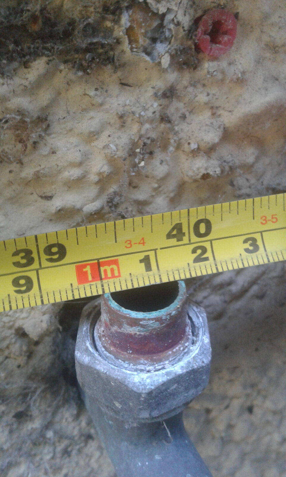

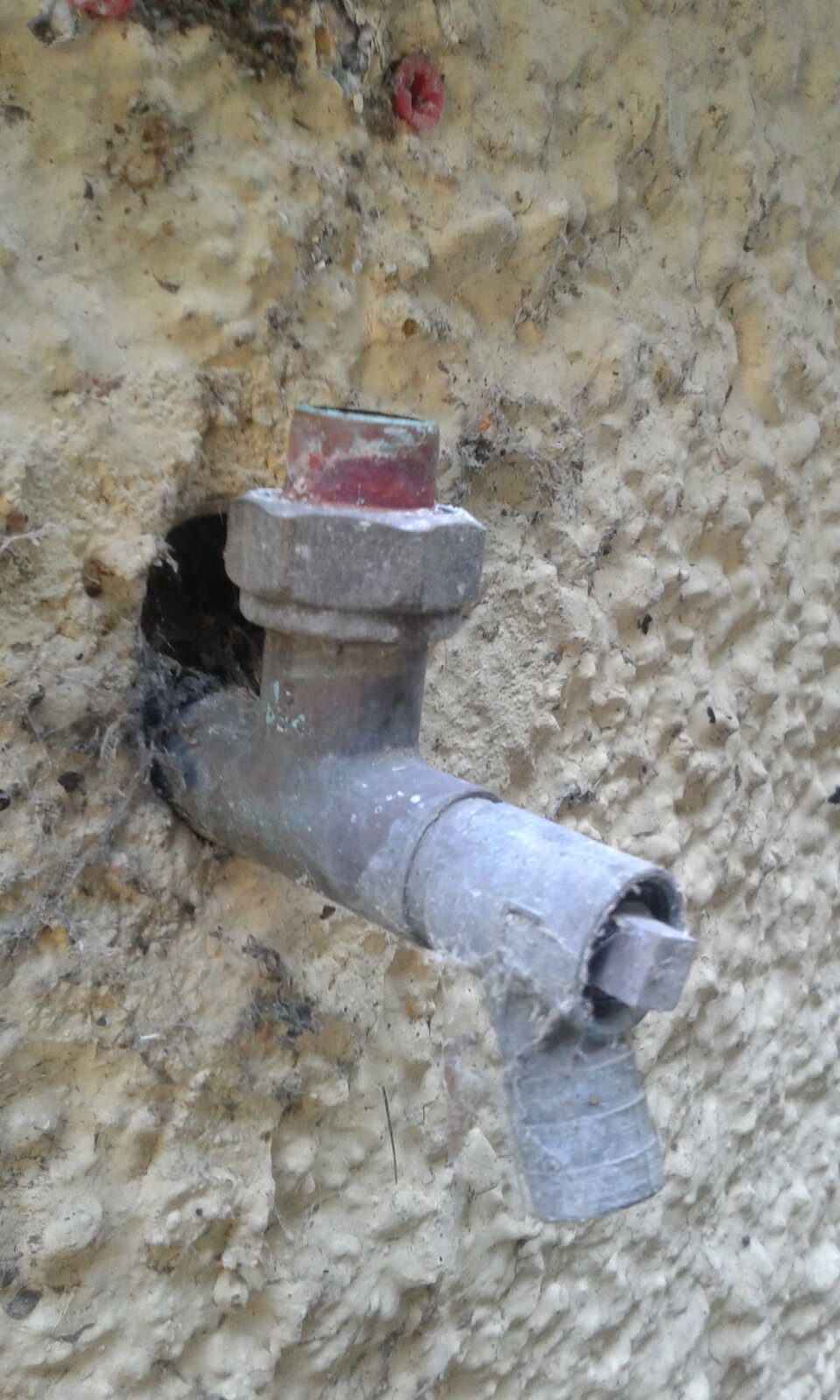

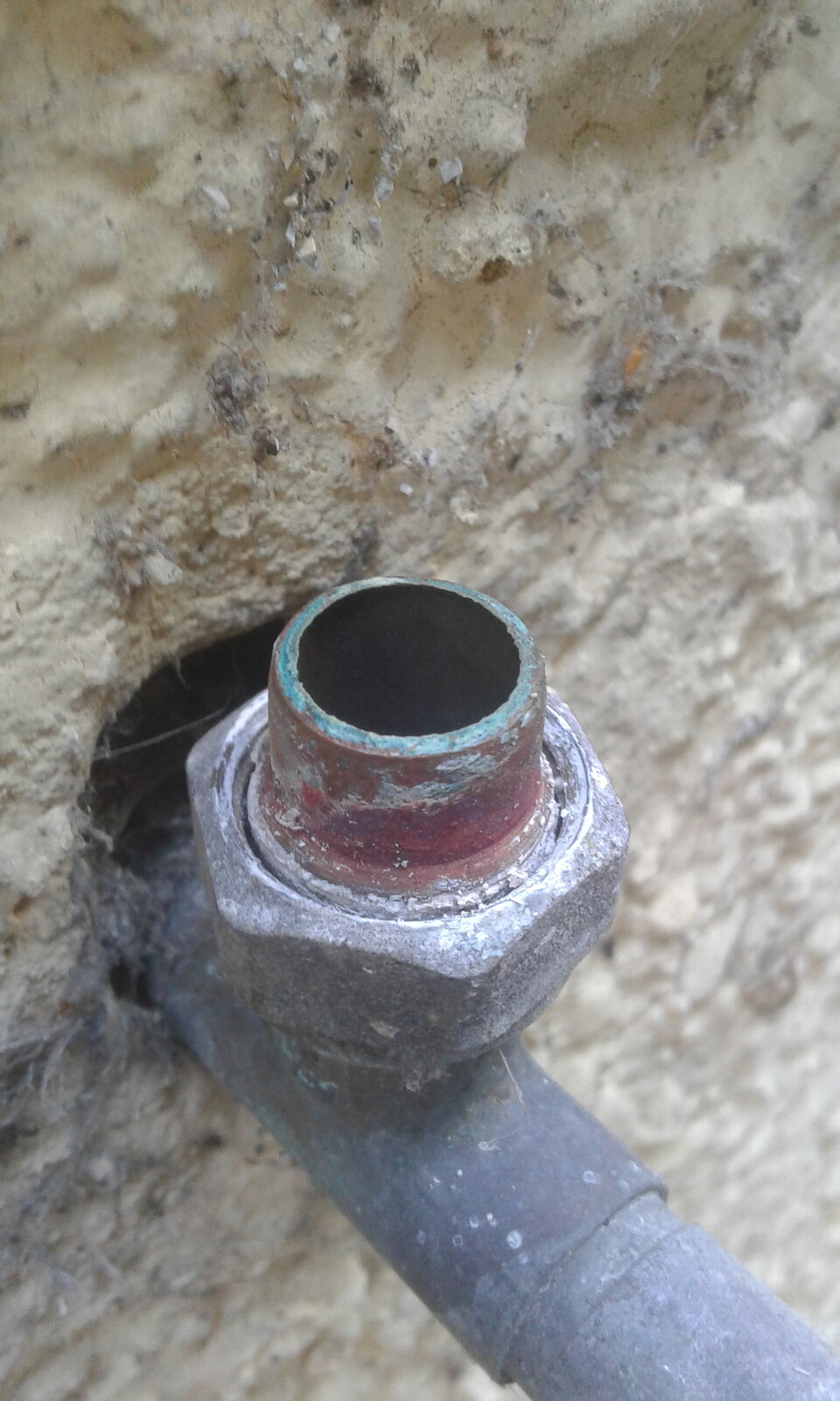

I need to change a garden tap (I think something has sheared inside by the feel of things), but having removed the tap I am wondering if it is a standard fitting or something a bit older and no longer available.
There's a soldered T joint that the tap attaches to, but the T has a captive nut, which so far as I can tell is not normal?

It looks more like a central heating drain. I'd get someone who knows what they are doing to look at it.
That’s just a drain cock fitted to tee, presumably to drain down the water in winter to prevent freezing.

do you have an image of the tap and the mount, as Chris_W looks like an olive in the NUT , it also looks like there are 2 rawplugs above the pipe - to take a mounting for the tap - probably something like the one Chris_W linked to
I also fitted a couple of those wall mount tap fitting , although tightening the nut maybe difficult if mounted directly on the wall , at least thats what i found , with a lever tap - and in a previous house also had the Drain as shown in the image, which i opened before winter to stop freezing
the pipework measure is 13/14mm outside diameter - so it maybe old imperial size - NOT sure -

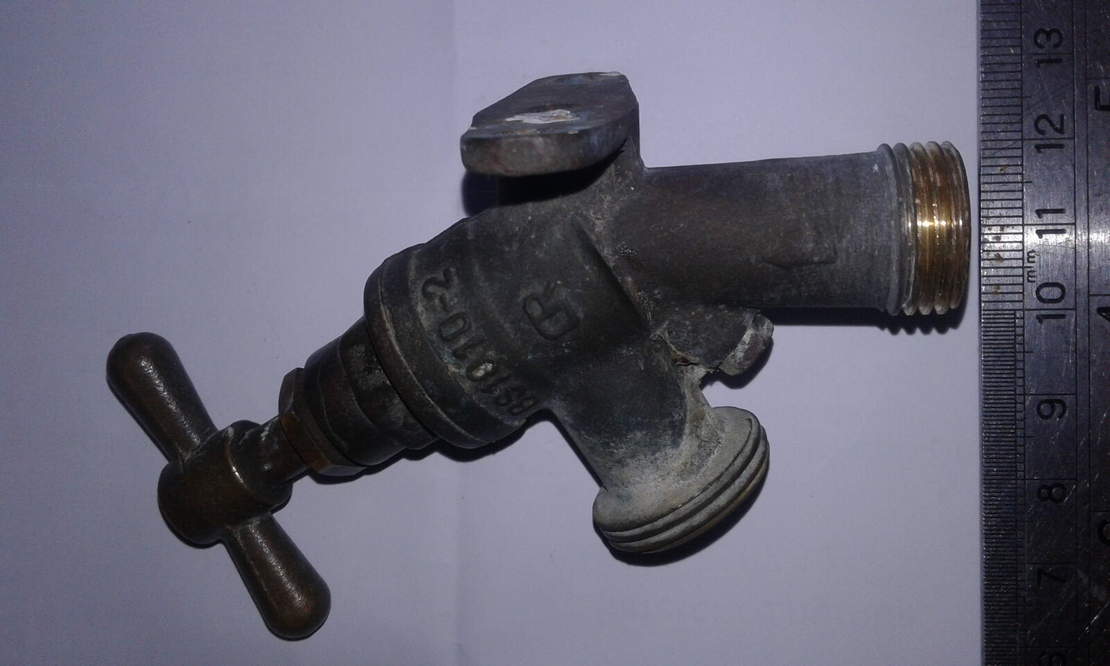

Thanks all. Here's a photo of the tap. As you can see there's a built in wall plate. Is the little hex head a drain? There's an isolation valve inside, don't think that there's a double check valve, would have to double check.

The hex could be a verifiable check valve, so you can, under the water regulations replace like for like.
Ah, OK thanks I think I've got it now. It's a bodged but serviceable job consisting of a standard soldered T with a short stub of copper upwards to which has been fitted a compression fitting (1/2" BSP?) which fits the tail of the tap. On the other part of the T is a valved drain (which could take a length of hose pushed on). The broken tap has a built in double check valve. So I could just replace the existing tap with something like this https://www.ebay.co.uk/itm/Outside-...l-Plate-Elbow-Double-Check-Valve/124629156069, although that's dependent upon the olive mating nicely with the new tap, so it may be preferable to replace with something more purpose built.
Ebay link looks like it will work. Better if double check valve was inside (less risk of freezing) but if not practicable, then go with eBay one.
